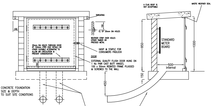

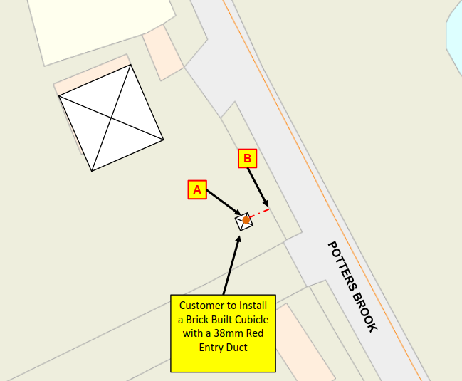

ToughButterCup Posted February 28, 2017 Posted February 28, 2017 I'm trying not to laugh, but to ensure a temporary connection, I've been told I need a brick built cubicle. These are screenshots from the quote I have just received..... and here's the object of desire.... All for the knock-down price of £4000 I've missed something haven't I? Tell me it's not true, give it me straight men, I can take it. I'm ugly enough. It's the brick-built sh1t house that gets me...... Ian
ProDave Posted February 28, 2017 Posted February 28, 2017 I take it this is for electricity? and is it permanent or temporary? For temporary I have seen an old kitchen cabinet with a bit of roofing felt tacked on. It lasted the year that was required without falling apart. And for permanent, I just set two standard flush mount meter boxes into a substantial short bit of "fence" along my boundary. I would ask them to quote what regulation says it has to be brick built. you can buy floor mounting fibreglass electricity kiosk's that just need a concrete base to stand on.
PeterW Posted February 28, 2017 Posted February 28, 2017 Get your gate posts / piggery / shed built and get the permanent supply done - that number is mad !! Is that including a road dig and connection..??
Triassic Posted February 28, 2017 Posted February 28, 2017 (edited) You need to challenge that, I've just been quoted £875 to move the overhead supply. The new supply will come down the pole, onto a 6m long duct (I'm installing) then into an exterior meter cupboard fixed to the block work shed I'm building. Inside the shed is another panel for the supply to the garage, the caravan and the new house. I wouldn't pay for a temporary supply as you'll only have to pay again to move it to the perminant location. Edited February 28, 2017 by Triassic Typo
Jeremy Harris Posted February 28, 2017 Posted February 28, 2017 As above, you need to challenge this. Mine's like Dave's, but all in one meter box in a similar timber structure. One meter box is not ideal, as space was a bit tight, but neither the DNO (same as Dave's, SSE) or the supplier had any problem with my electrician fitting a DP fused isolator, Henley and a small "two way" CU box tucked over to the far right side of the cabinet. Given the small size of the newer incomer fuse and head and meters, there is really quite a bit of spare space over to the right in a standard meter box now, as the dimensions of the things were standardised to accept bigger bits of kit. I think I was lucky not to have a stroppy meter guy, though...............
ToughButterCup Posted February 28, 2017 Author Posted February 28, 2017 Thanks for the support. I think the operator I talked to let the cat out of the bag when she said 'Most developers round here use generators....' And yes @Triassic, I will have to pay all over again if I get a temporary connection, but wait for it, -even if the temporary connection is in exactly the same place as the temporary one. So, it's a diesel genny for me... say 6Kv?
PeterW Posted February 28, 2017 Posted February 28, 2017 I'd seriously consider building something to put the permanent connection in to and be done with it. From memory they cannot refuse to connect into a BS meter box that is ducted correctly - as @JSHarris says there is plenty of room in a box for connections and you can get an IP65 caravan connector now with an RCD in it so even if your box only has the DNO fuse, meter and a single CU or switch feeding something directly below the box then it must be cheaper to only do it once. How much of the £4K is contestible works ..??

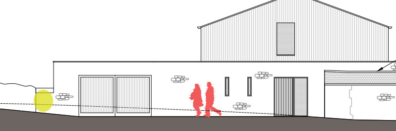

ToughButterCup Posted March 1, 2017 Author Posted March 1, 2017 10 hours ago, PeterW said: I'd seriously consider building something to put the permanent connection in to and be done with it. [...] How much of the £4K is contestible works ..?? Got it in one. Build a bit of our front wall, and be done with it. Like this... (lime green dot below) Is there any reason why I can't ask for the boxes to go on the back of the wall, out of sight? Contestable? All of it except the bit where they wet their fingers, twist the wire and make the joint 1 hour ago, Triassic said: [...] the new quote, for exactly the same move, came in at £875. I think the price is often down to who you talk to at the DNO. @Triassic, my fingertips are telling me the same story: the discussion with the Electricity Northwest rep was markedly casual, uninformed even: she constantly had to ask for advice from colleagues on what I assume are standard questions. Maybe she was in training. Adding a caravan connector is almost a no brainer. 10 hours ago, JSHarris said: [...] as I made up a long, 2.5mm² extension lead, with a waterproof double gang socket on the end, using HO7RN-F cable, with a decent strain relief and a mounting board that doubled up as a cable reel. That proved invaluable during the early stages of the build. Jeremy, what's 'decent strain-relief'? (ExLax?) Thanks for the tip about HO7RN-F cable - didn't know what you call that nice heavy floppy cable. Thanks. Ian

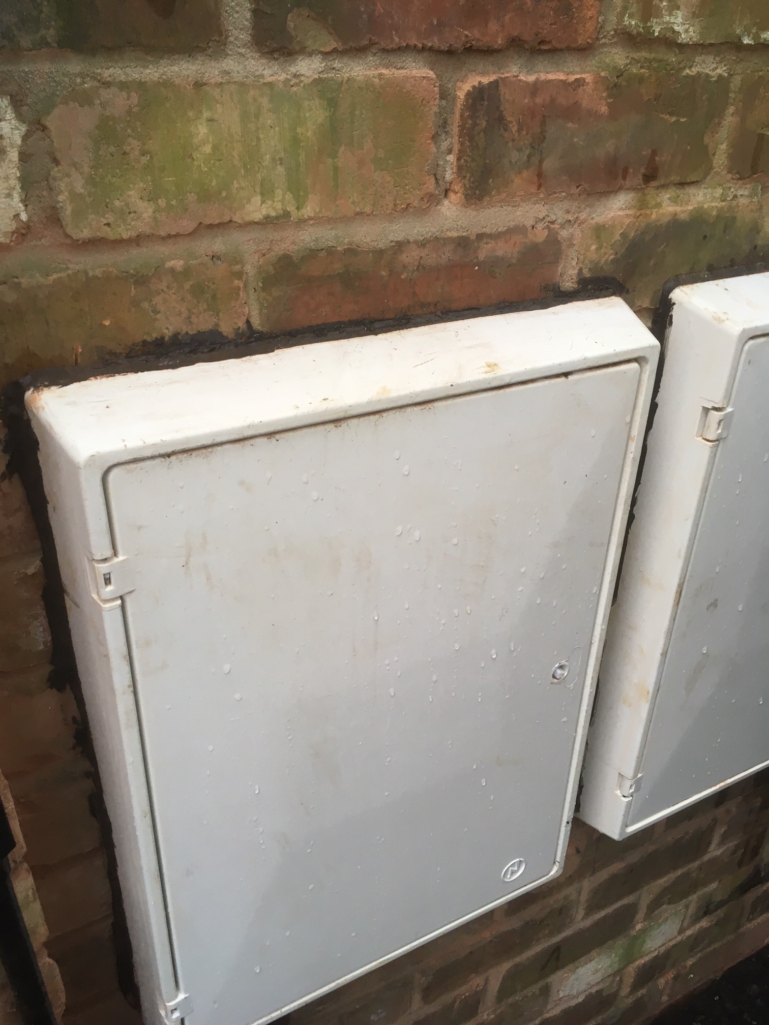

PeterW Posted March 1, 2017 Posted March 1, 2017 3 hours ago, recoveringacademic said: Is there any reason why I can't ask for the boxes to go on the back of the wall, out of sight? You mean like this..??? Left one has DNO connection, Meter and Henleys with 80A Switched fuse to the house. Right has control for power to gates/lights etc and has a key lock rather than a simple plastic lever. All in the back of the wall where the gates are now.
Jeremy Harris Posted March 1, 2017 Posted March 1, 2017 Our box is on the back of a thick fence that is the screen for the wheelie bin storage area. The front of this fence is clad with larch, the same as the house, to hide the back of the meter box from view. Like Dave's, it has a single pitch "roof" over the top to keep the weather out. The meter box is completely out of sight now, and only visible from the rear, but still easy to access by the meter reader just by walking up the path by the side of the house.
