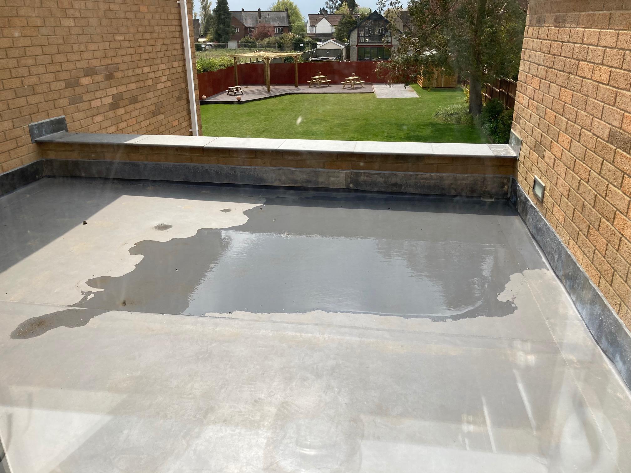

Having recently had a defective flat roof replaced... per another post. I've noticed an issue with pooling water. In fairness the old roof suffered with it to some extent but less so as the outlet was made up of the membrane material. The new outlet is a single piece welded to the PVC and sits ever so slightly higher. Effectively there is a small step up to the outlet which is far from ideal. I mentioned it to the roofer and he explained that the membrane would be unaffected by this and in fact could take being soaked throughout it's life and not effect the guarantee. The details on IKO Polymeric's own site second the fact the membrane can withstand pooling.  It was my understanding however that as a rule standing water should be gone within 48 hours of the last rain event...
We had some heavy rain overnight Tuesday and early into Wednesday.
I've attached some pictures below with a timeline of the pooling.

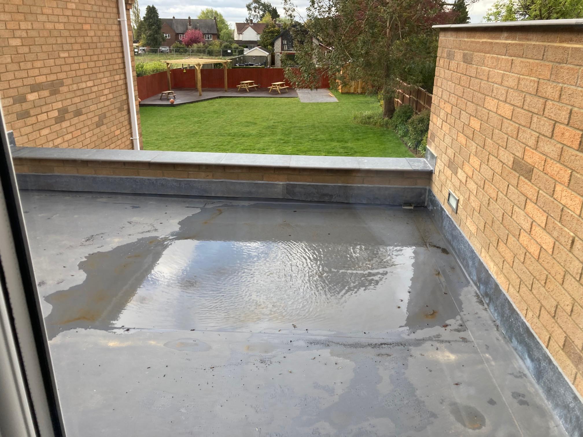

Wednesday 5 hours after rain:
Wednesday 13 hours after rain:

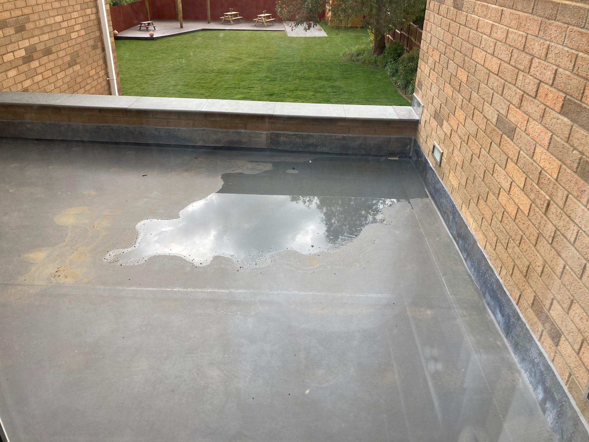

Friday 53 hours after rain:

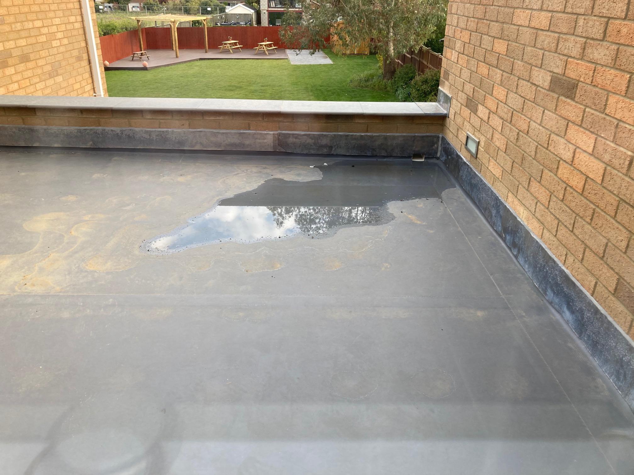

Saturday - 83 hours after rain
I am ultimately sticking down a protective fleece, paving support pads and then promenade slabs on this deck so that may or may not help to a certain extent. Should I be concerned at this pooling? What I have researched suggests not, although ideally the water should run off freely.
I'm not really minded to ask folks to start pulling this apart now etc as that would mean disturbing the lead flashing and lowering the outlet in the wall.
Please let me know your thoughts...

I wouldn’t worry about it
Get it decked out
If manufacturer stands by the installation then all is well.
I would have said your roof in that area definitely doesn't leak.

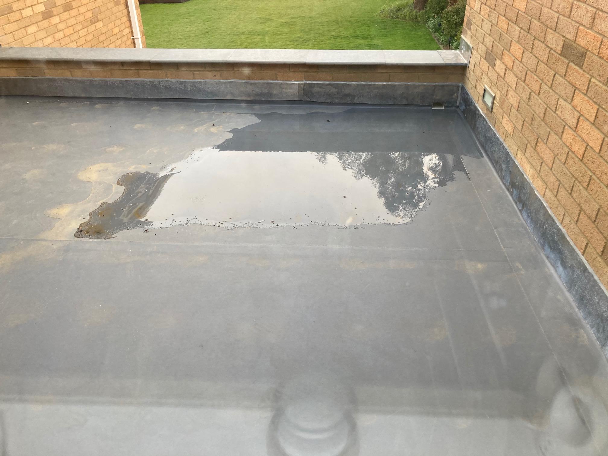

So... with all the recent rain, the roof hasn't dried out since I started this topic. With the downpours overnight, it's back to where it was. I'd estimate ~30 liters just standing.
Most people I speak to say they wouldn't worry about it... I think I'll have to accept and live with it. I just like things to be right.
Hopefully the protective fleece, support pads and slabs will help raise the level and shift this.
I reached out directly to IKO Polymeric and they stated that their membrane can withstand even severe ponding without affecting it or the guarantee. However,  they did state (as I knew) it is good practice and part of the BS standards to ensure water drains off as quickly as possible.
I think this will be yet another lesson for me in hindsight... I wish I had made a point about wanting to ensure water drains off the roof quickly and not stand.
Whilst the roofer recognizes the water remaining on the roof is not ideal, trying to resolve it now would involve extensive work that he believes in unnecessary.

That is nothing to be concerned about, the parapet and walls will prevent wind from drying the water. Only worry if it gets near the top of the flashing
Please correct me if I am wrong, but if the water came level / just over the bottom of the flashing, wouldn't that present a problem owing to the capillary action of water? Thus effectively being drawn up behind the flashing?
Couple of points to bear in mind
1) It is unlikely a flashing will be tight enough to the wall to draw water up.
2)The flashing (more upstand in this case) should be sealed to the horizontal surface and act as a tank.
It will eventually leak there because water always wins in the end but probably not in a timescale to bother you provided the roof workmanship is tidy.
It would be nicer to have the fall right but, to be honest, I would take a view on it personally.

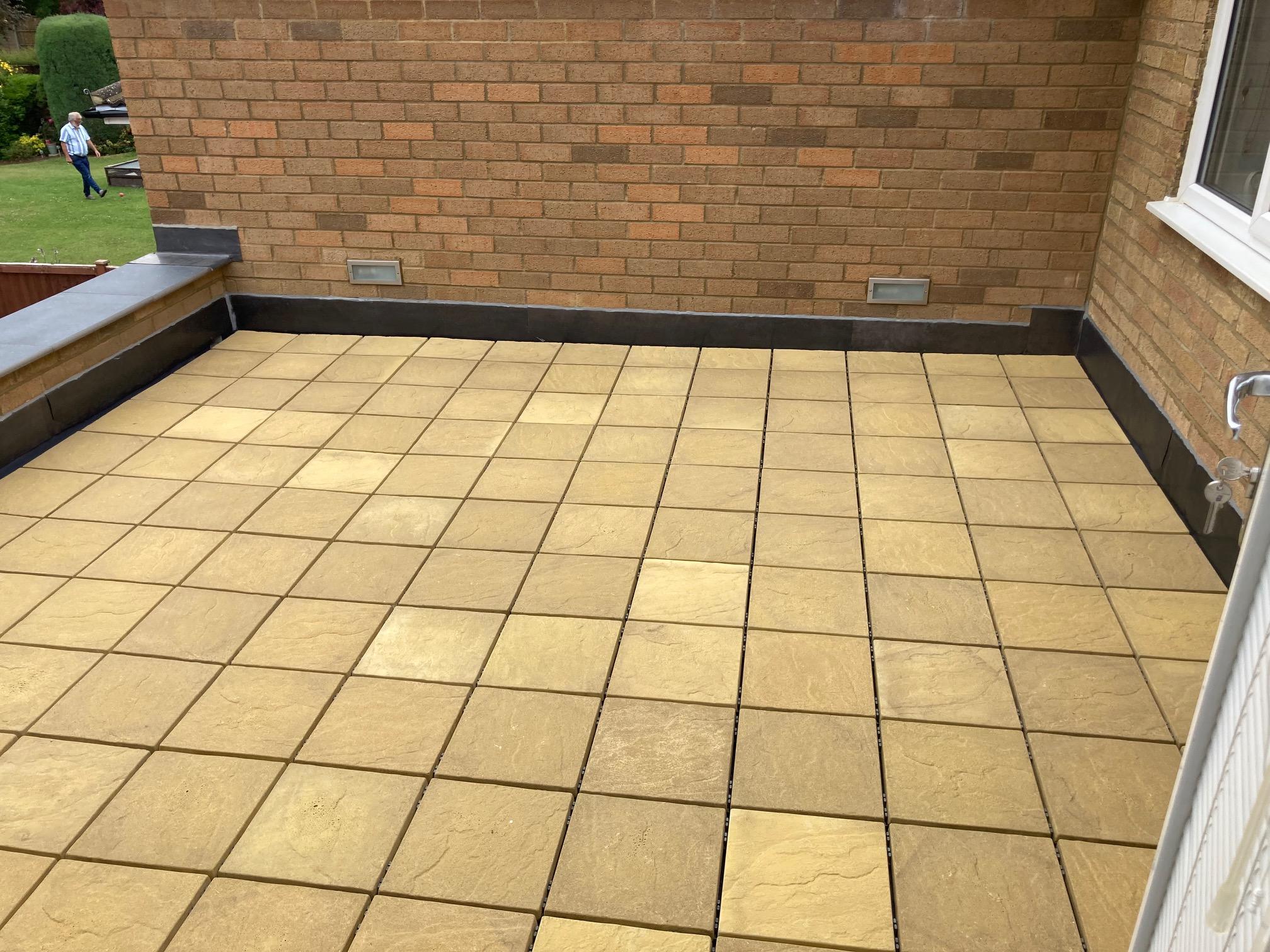

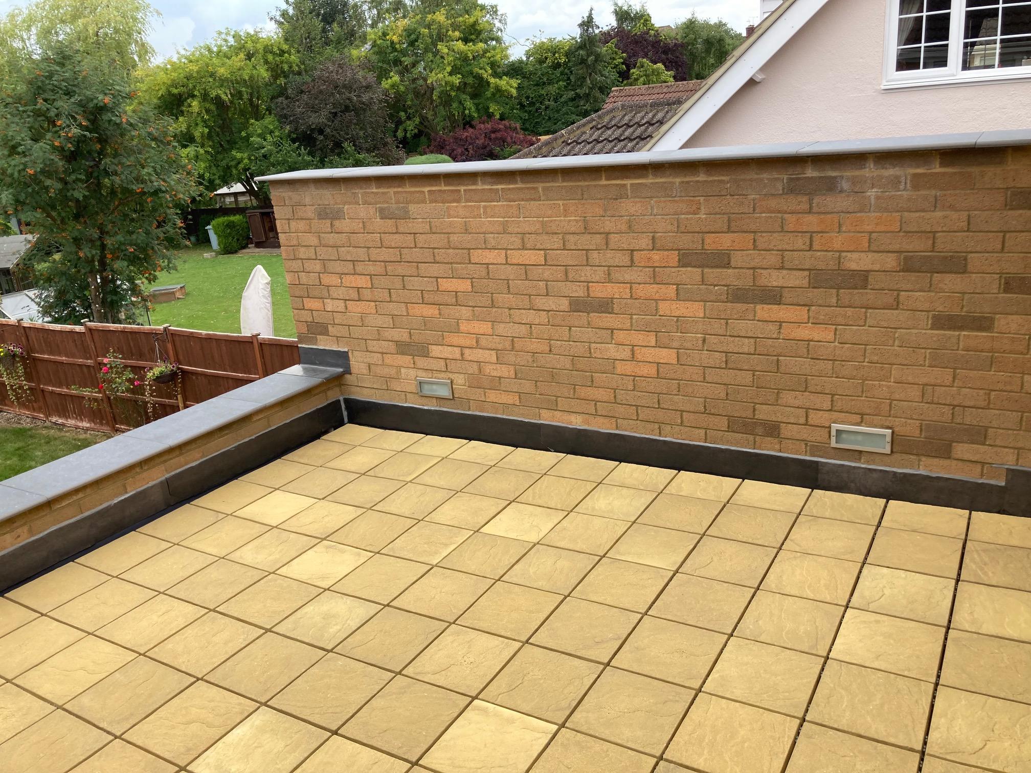

Finally decked out...
Now after the rain we had, you can see the water between the gaps in the promenade slabs but decked out it doesn't look horrendous at least.
I'm a little concerned about the water freezing during winter months and whether that will present any issues. I also noticed some hairline cracks in the grout between a couple of the copings that I will seek to get addressed. I suspect this is due to expansion / contraction but a flexible grout was used. There is a DPC under the copings but it makes sense to correct hairline cracks if I know they are there.
