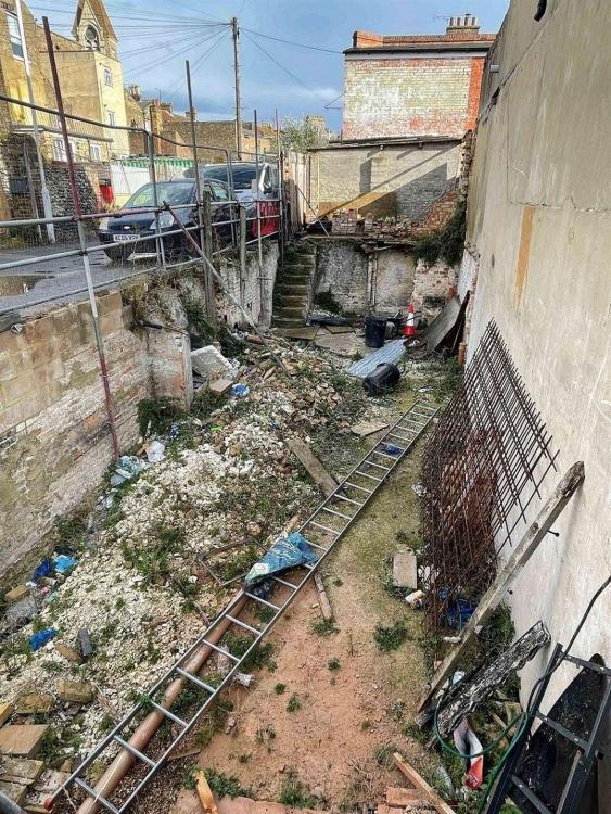

Onoff Posted April 27, 2021 Posted April 27, 2021 6 hours ago, pocster said: My external staircase arrives soon . It’s in sections ( apparently! ) . Heaviest single component is 95kg . It will have a lip and rest on the wall to the left ; then lowered down . Though I have a winch there’s no where to fix it to . I could make a Scaff tower and get an end on there whilst the other rest on the wall . But how do I lower ? What’s the best ( and safest ) way to do this apart from crane hire ? Can you slide it in over that wall on the left? Secure the end of the staircase with a winch then see-saw it over the edge. A couple of ropes on the bottom end. You'd need a couple of mates to help though so that's out the window!
joe90 Posted April 27, 2021 Posted April 27, 2021 7 hours ago, pocster said: My external staircase arrives soon . It’s in sections ( apparently! ) . Really depends on what these sections are, I would guess ? two long “strings” and bolt on steps!!!, @pocster can you not ask your supplier what these sections are and individual weights 1
Pocster Posted April 27, 2021 Author Posted April 27, 2021 3 minutes ago, joe90 said: Really depends on what these sections are, I would guess ? two long “strings” and bolt on steps!!!, @pocster can you not ask your supplier what these sections are and individual weights Just got a reply from them 2 x stringers at 95kg each 1
joe90 Posted April 27, 2021 Posted April 27, 2021 That’s about 14stone each, a well built bloke, (but stiff), should not be a problem for 2 or three persons. Sorry I am busy that day/weekend/date! 1
Onoff Posted April 27, 2021 Posted April 27, 2021 What's the finish on the staircase? Rope on each end. Stand well back. Just get it near the edge and kick it over the side...bit of carpet over the edge to protect the rope. You can hold back 47.5 kg on your own. Hook one end over the lip lower the other end down. I've done worse/sillier.

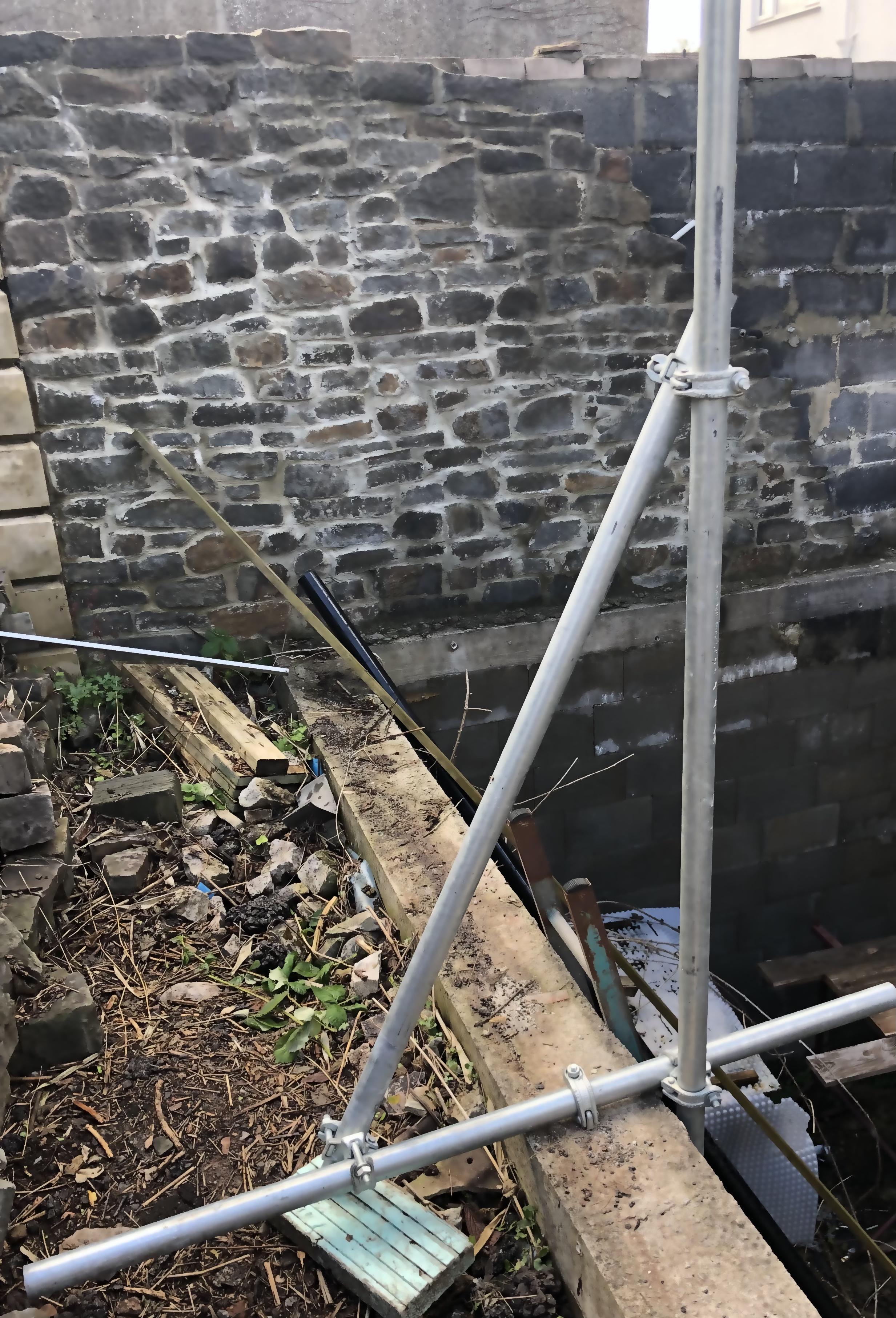

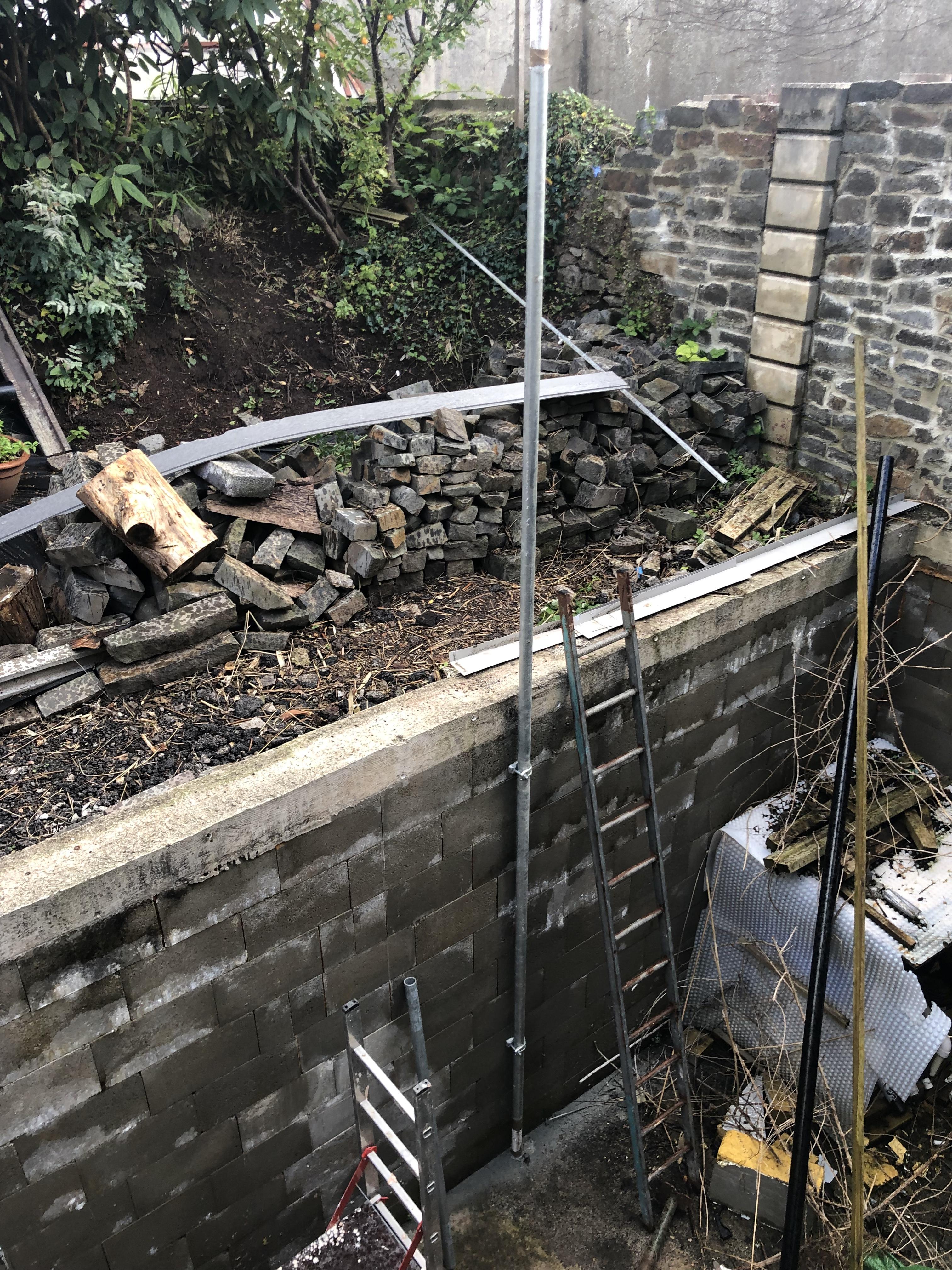

Pocster Posted September 29, 2021 Author Posted September 29, 2021 @joe90 finally started on my crane ( ok a winch ) . 48mm Scaf pole bolted to concrete wall . Going to make an A shape brace at the top and bolt to wall also . Hoist winch support on order .
Pocster Posted September 29, 2021 Author Posted September 29, 2021 Extra support added - nothing fixed yet in case it’s wrong or just plain wtf ! In reality I’ve limited weight the hoist takes to 50kg . Staircase stringers are 100kg but upper end will hopefully stay where put On the ground .

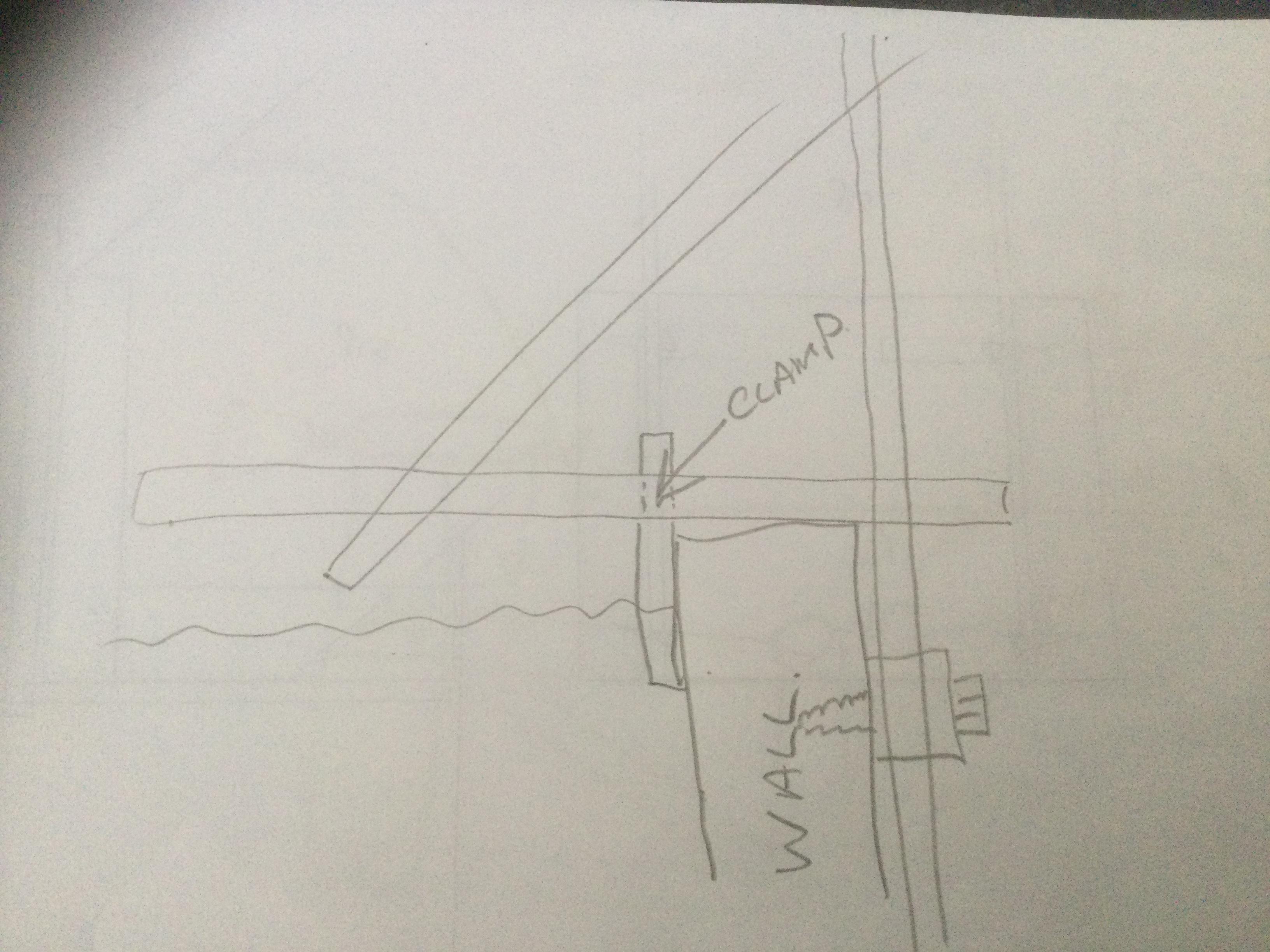

joe90 Posted September 29, 2021 Posted September 29, 2021 (edited) At last….., what weight and what are you going to put on the end of that bar to balance it (min 50kg if your limiting load to that)? I would add another “putlock” and short tube down the back of the wall, take the strain off the bolt into the wall if it were me! Edited September 29, 2021 by joe90
Bitpipe Posted September 29, 2021 Posted September 29, 2021 9 minutes ago, joe90 said: At last….., what weight and what are you going to put on the end of that bar to balance it (min 50kg if your limiting load to that)? I would add another “putlock” and short tube down the back of the wall, take the strain off the bolt into the wall if it were me! Shhh, you'll spoil the fun. 1
Pocster Posted September 29, 2021 Author Posted September 29, 2021 17 minutes ago, joe90 said: At last….., what weight and what are you going to put on the end of that bar to balance it (min 50kg if your limiting load to that)? I would add another “putlock” and short tube down the back of the wall, take the strain off the bolt into the wall if it were me! Yeah I’ll stick 50kg on the end . Put lock? Crap drawing please !
Onoff Posted September 29, 2021 Posted September 29, 2021 18 minutes ago, pocster said: Yeah I’ll stick 50kg on the end . Put lock? Crap drawing please ! Just put your wallet on the end of that outboard leg! ? 2
joe90 Posted September 29, 2021 Posted September 29, 2021 (edited) 26 minutes ago, pocster said: Crap drawing please ! putlock = clamp, fixed 90’ one Edited September 29, 2021 by joe90 1
