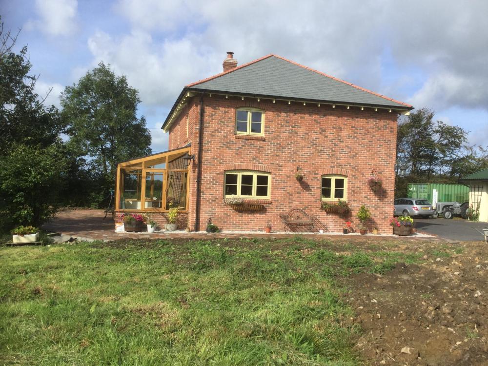

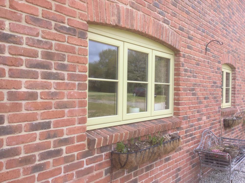

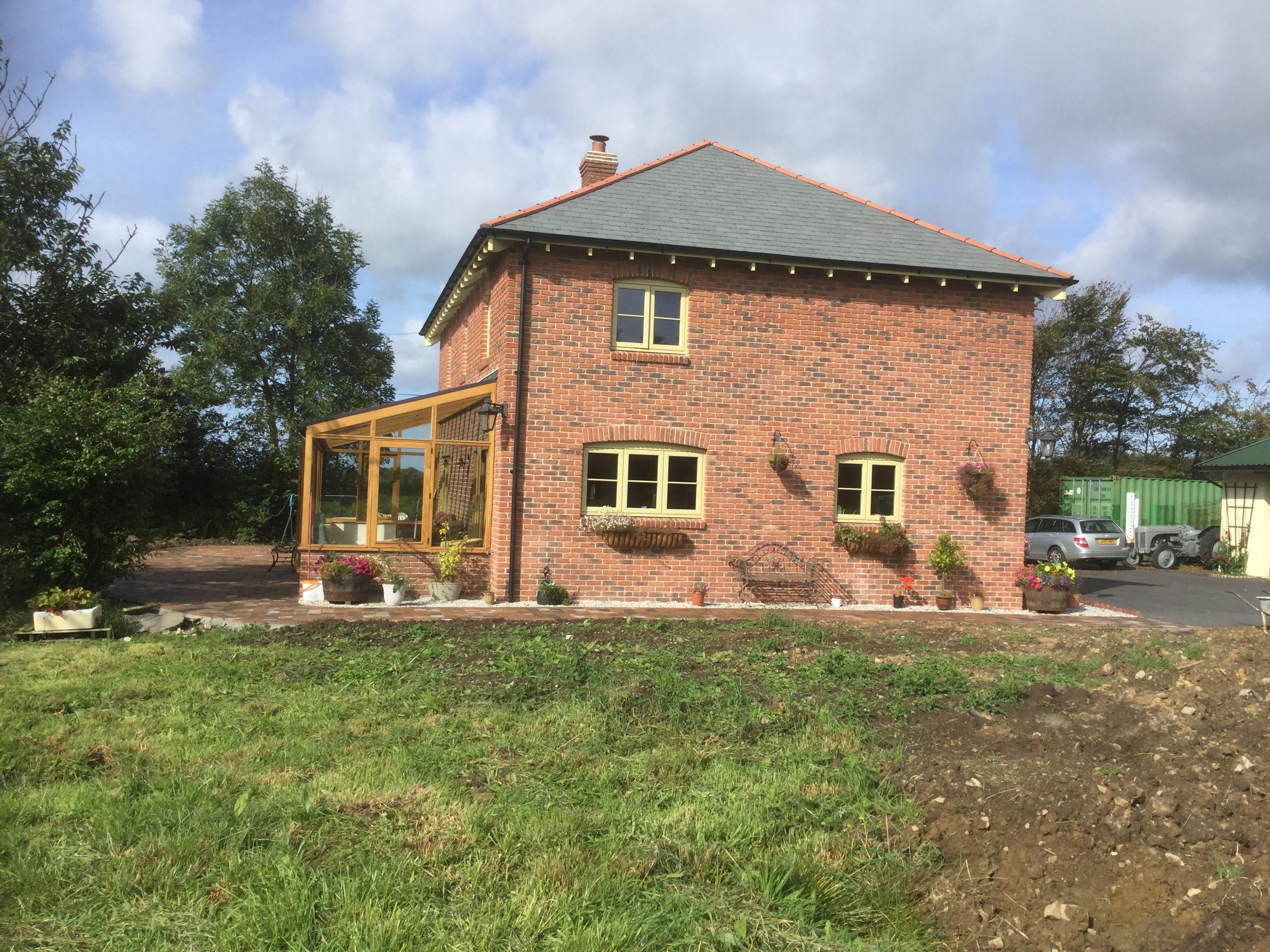

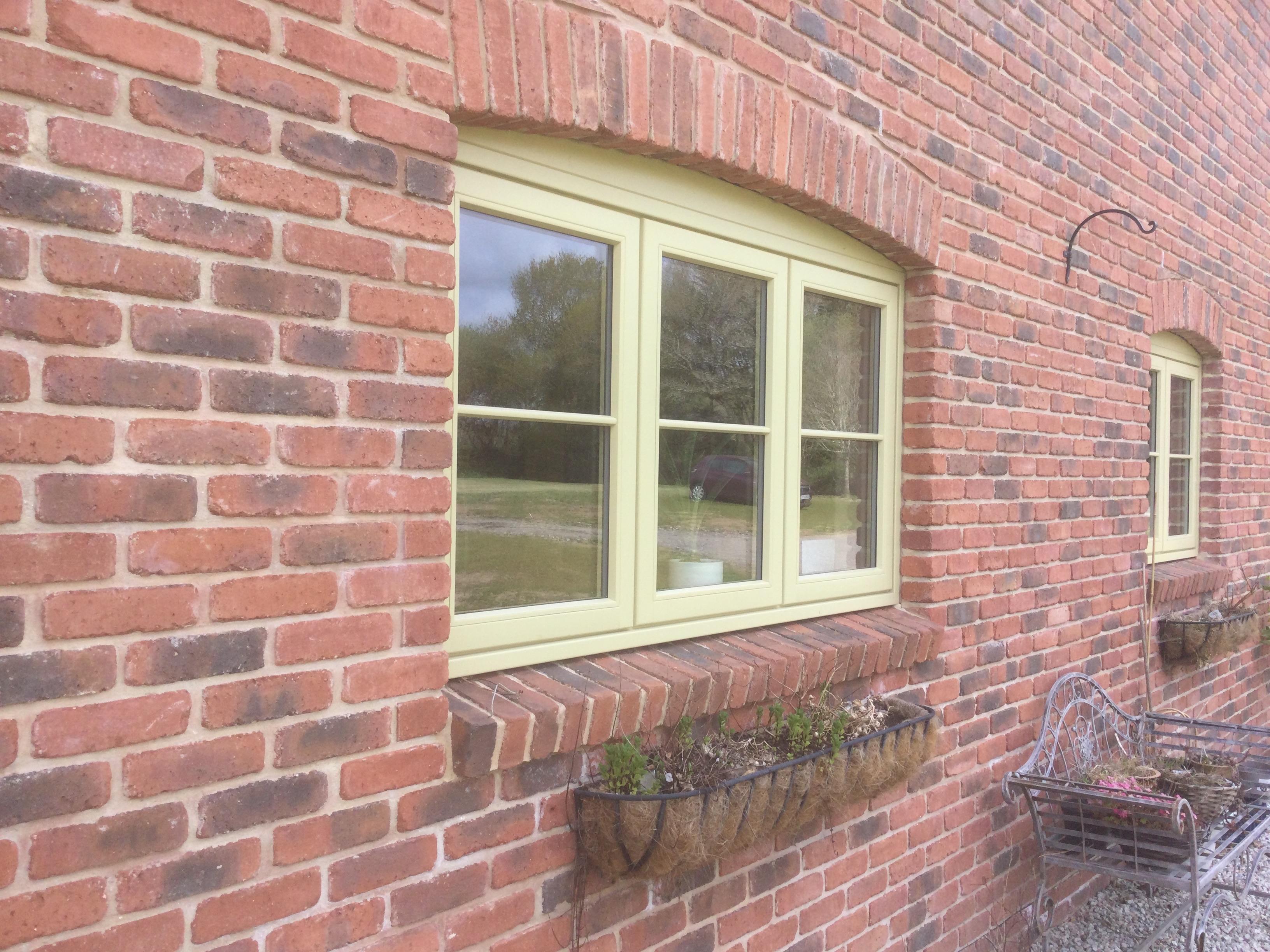

joe90 Posted April 27, 2021 Share Posted April 27, 2021 (edited) We have “antique” bricks (tumbled so the corners are knocked off), we had mixed sand and lime to replicate old lime Mortor and we think it looks really good. I specified brick cills and the colour of the windows was completely wrong ? we wanted “national trust olive green” but there is more than one shade. We chose RAL 1000 on the iPad (big mistake) windows arrived on site bright yellow and I had a fit!!! But now the house is complete we love it and everyone says how nice it is (too late to change it). Edited April 27, 2021 by joe90 3 Link to comment Share on other sites More sharing options...

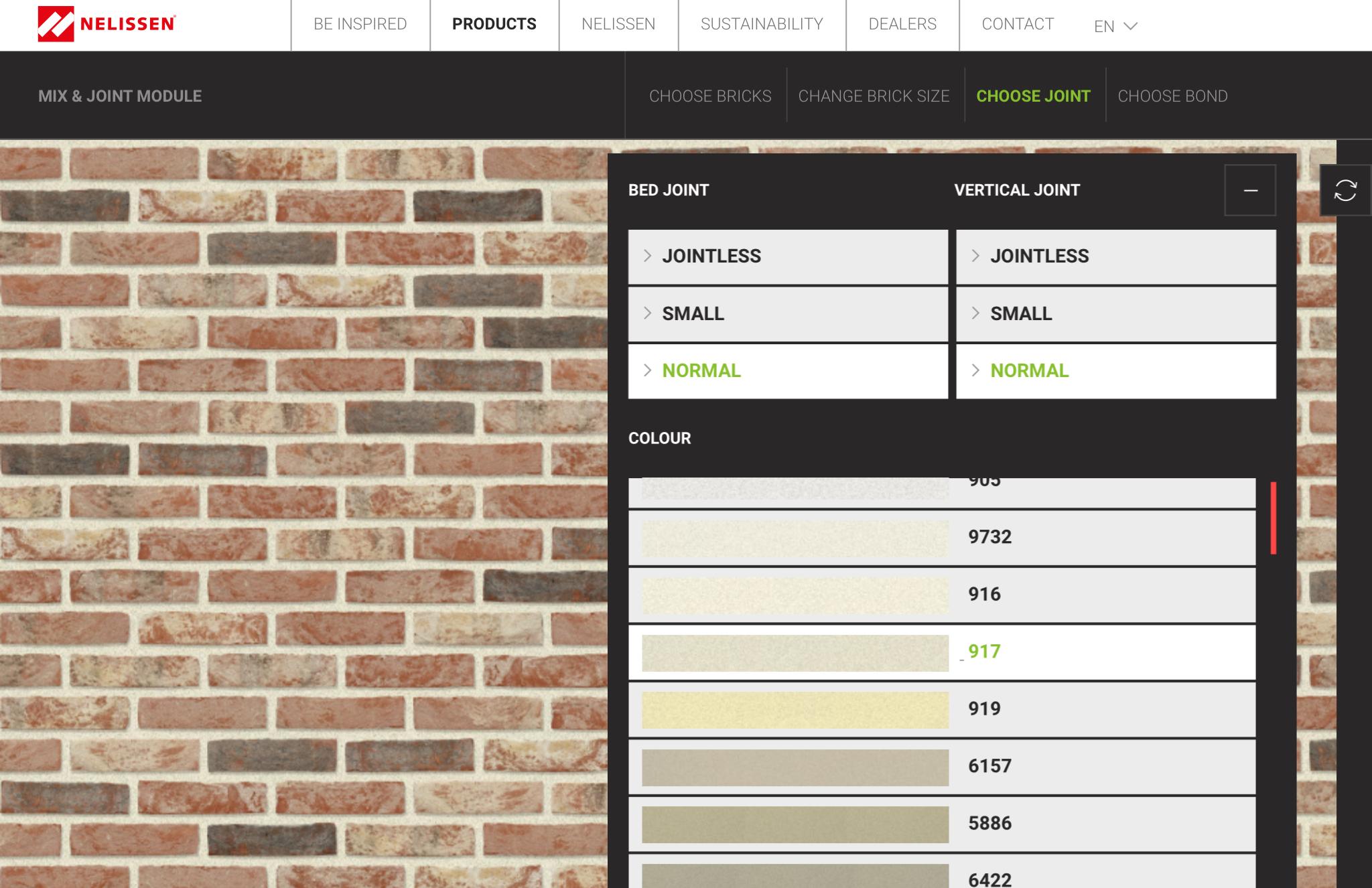

Bonner Posted April 27, 2021 Share Posted April 27, 2021 On 27/04/2021 at 07:06, crispy_wafer said: Does anybody have this combination of colours on the go, or even just antique brick and light mortar? Expand TBS bricks are made by Nelissen who have a good joint selection tool on their website. You need to find out what that brick is called by the manufacturer as TBS use their own names for the UK market. 1 Link to comment Share on other sites More sharing options...

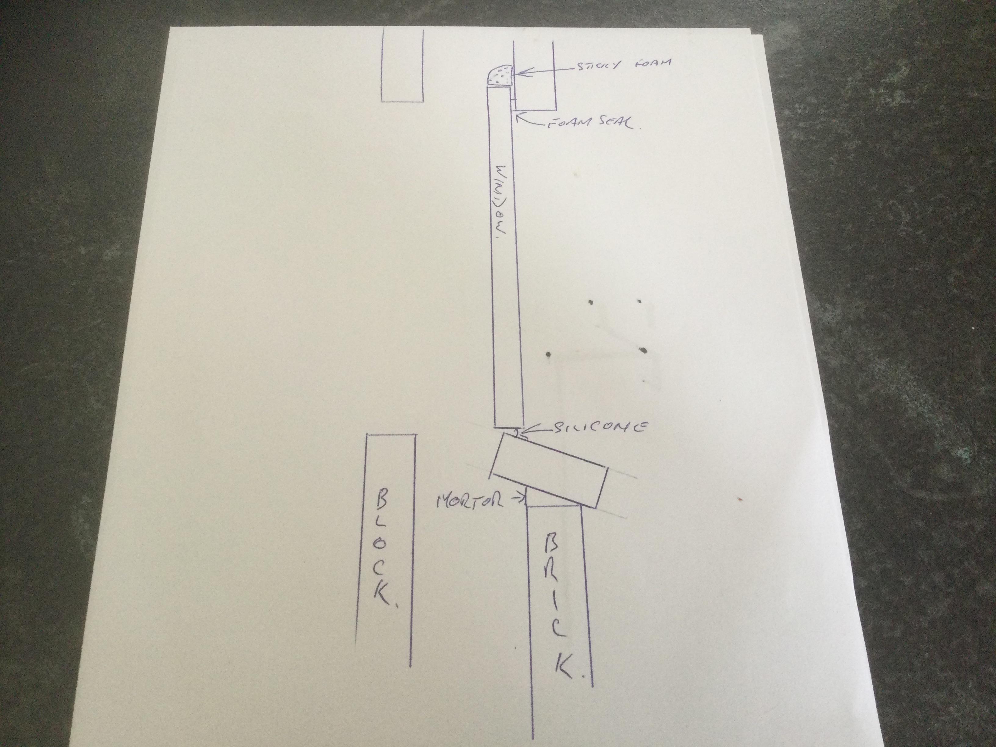

crispy_wafer Posted April 28, 2021 Author Share Posted April 28, 2021 Yes, I like that, and it all works together really well I think. Well done. I especially like the window cill brick detail, I will show that to my builder, that design could well save me some pennies too against the cost of cast cills. Can I ask how the window frame is sealed against the angled brick in the Cill? On 27/04/2021 at 14:33, joe90 said: We have “antique” bricks (tumbled so the corners are knocked off), we had mixed sand and lime to replicate old lime Mortor and we think it looks really good. I specified brick cills and the colour of the windows was completely wrong ? we wanted “national trust olive green” but there is more than one shade. We chose RAL 1000 on the iPad (big mistake) windows arrived on site bright yellow and I had a fit!!! But now the house is complete we love it and everyone says how nice it is (too late to change it). Expand Link to comment Share on other sites More sharing options...

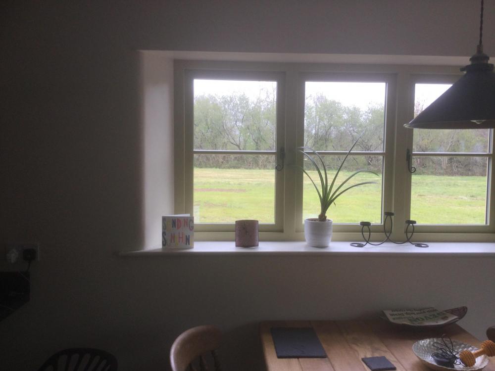

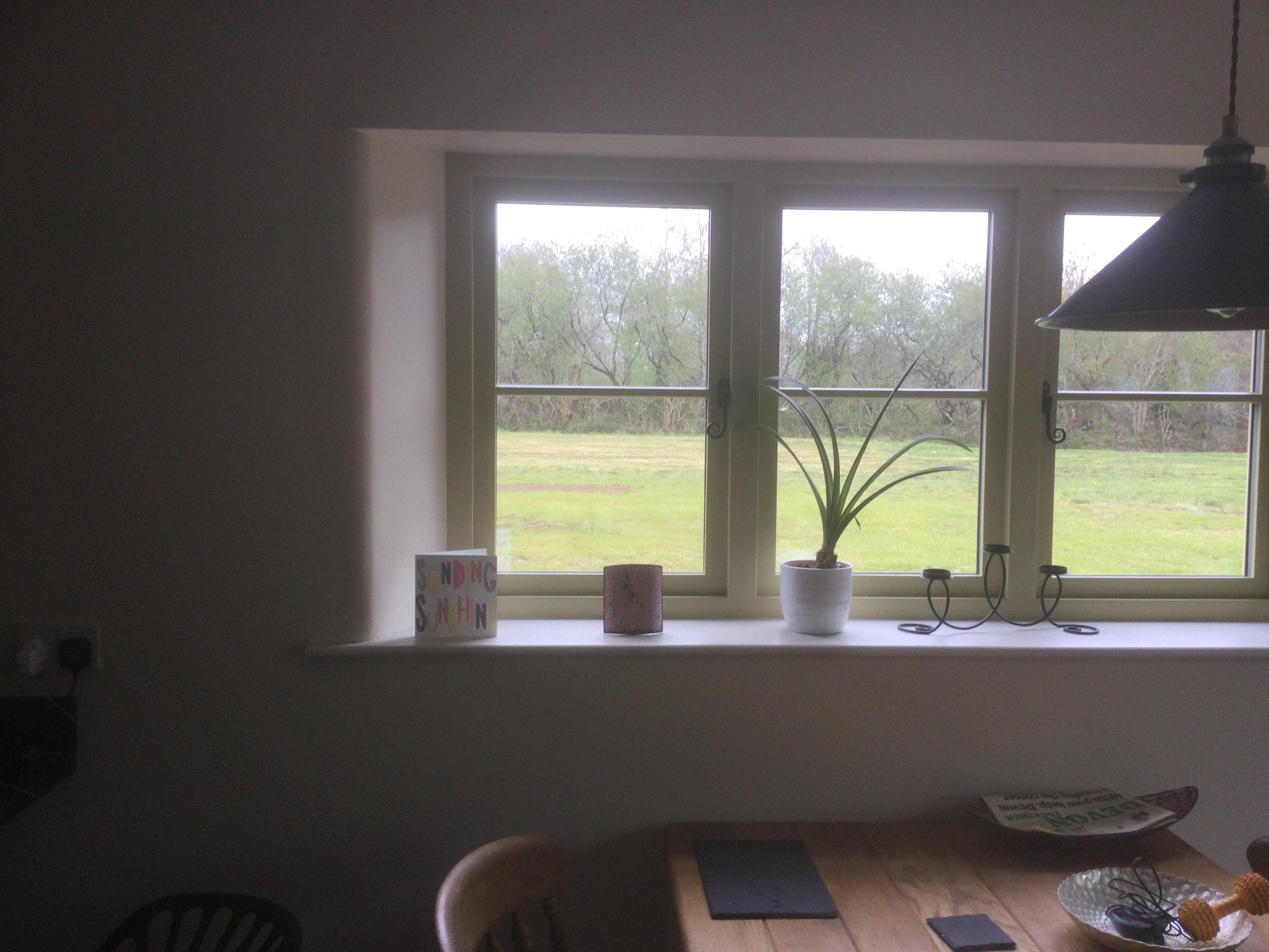

joe90 Posted April 28, 2021 Share Posted April 28, 2021 @crispy_wafer my windows are in “check reveals”, this means the windows fit against the back of the brick skin with a foam seal and held with stainless brackets and screws to that brickwork. The brick cill was built on an angled bed or Mortor then the window sat on it with a silicone seal to the outside. I also foamed the joint between window and brickwork. I also had angled reveals as the cavity is 200mm deep, this gives a nice cottage feel to the rooms sand makes the rooms lighter. Excuse the CAD drawing (crayon assisted drawing!!!). 1 Link to comment Share on other sites More sharing options...
