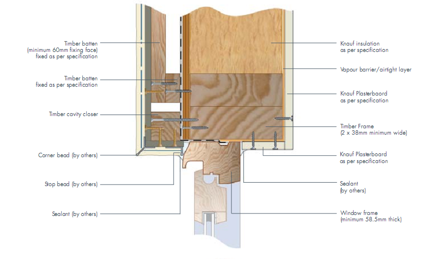

dogman Posted February 26, 2017 Share Posted February 26, 2017 I have been doing a bit of planning on the rendered section of our new build. Its a twin wall MBC build. About half the build will be clad with render board and thin coat render. What i cannot find is how to deal with cavity trays above the windows and doors and also at a roof abutment The above is from the Knauf detail and it does not show any form of a tray. Another manufacture has a metal channel above the window that drains to one side. I think @JSHarris used flexible flashing on a timber clad section Does anybody have details of how this should be done or how they managed the detail on their own build Link to comment Share on other sites More sharing options...

ADLIan Posted February 26, 2017 Share Posted February 26, 2017 Both knauf render panel requires drained/vent airspace behind. See manuf instructions and BBA certificate. They omit to say how to deal with this detail above window however and diag is misleading. As JSH says TRADA will have more details (I don't have these to hand however). ian Link to comment Share on other sites More sharing options...
dogman Posted February 26, 2017 Author Share Posted February 26, 2017 @ADLIan i have seen JSH post and see how he dealt with the issue with timber cladding and see what he did will work The issue with cement board and render is it is in effect a sealed system vented at the top and bottom of the wall. Not sure which of the manufacturers it was but the only detail i have seen is a u section between the timber frame and cement board set at a slight angle so it will catch any moisture and drain it away from the window head. Link to comment Share on other sites More sharing options...
ADLIan Posted February 26, 2017 Share Posted February 26, 2017 I've not seen JSH detail but noting his attention to detail I'm sure it'll work! My concern is with the diag you show at the top which fails to show the vent required to this airspace - I find this a little misleading from the manuf. ian Link to comment Share on other sites More sharing options...

dogman Posted February 26, 2017 Author Share Posted February 26, 2017 this is from wetherby TF-Epsitec15-RO-05-Window head.pdf It shows a bell cast fixed to the timber frame to deflect moisture away not as good as the u channel as moisture will sit on the inner face of the board The timber frame is counter battened so air flow should not be an issue if you pay attention to detail. ( and yes i agree the detail from Knauf is misleading) Link to comment Share on other sites More sharing options...

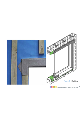

Mr Punter Posted March 1, 2017 Share Posted March 1, 2017 Lift up the breather paper, tuck up and staple some 225mm DPC to the sheathing and drape over the horizontal batten. Even without weep holes, any water will be trapped between the render board and the DPC and will eventually find its way down the sides. 2 Link to comment Share on other sites More sharing options...
TerryE Posted March 2, 2017 Share Posted March 2, 2017 8 hours ago, Mr Punter said: Lift up the breather paper, tuck up and staple some 225mm DPC to the sheathing and drape over the horizontal batten. Even without weep holes, any water will be trapped between the render board and the DPC and will eventually find its way down the sides. Sounds like a plan, but if you are doing this then perhaps you'd be better letting the DPC turn up behind the render board in a J profile, and that way the water will escape down the sides rather than rotting the render board. Link to comment Share on other sites More sharing options...
dogman Posted March 2, 2017 Author Share Posted March 2, 2017 (edited) I have managed to speak with several board manufacturers as well as a couple of the render manufacturers. key is to ensure that a. the battens do not create dead spots. b. That there is a method to move any moisture from the inner skin to the outer skin. c. weep holes are not needed on any boarded system. This is one way of doing it using flashing Edited March 2, 2017 by dogman Link to comment Share on other sites More sharing options...
Trw144 Posted March 2, 2017 Share Posted March 2, 2017 On 01/03/2017 at 15:23, Mr Punter said: Lift up the breather paper, tuck up and staple some 225mm DPC to the sheathing and drape over the horizontal batten. Even without weep holes, any water will be trapped between the render board and the DPC and will eventually find its way down the sides. Exactly what I did, and taped some outdoor air permeability tape over the joint on the membranes for good measure. Did this for both the render board and timber clad detail. Link to comment Share on other sites More sharing options...
