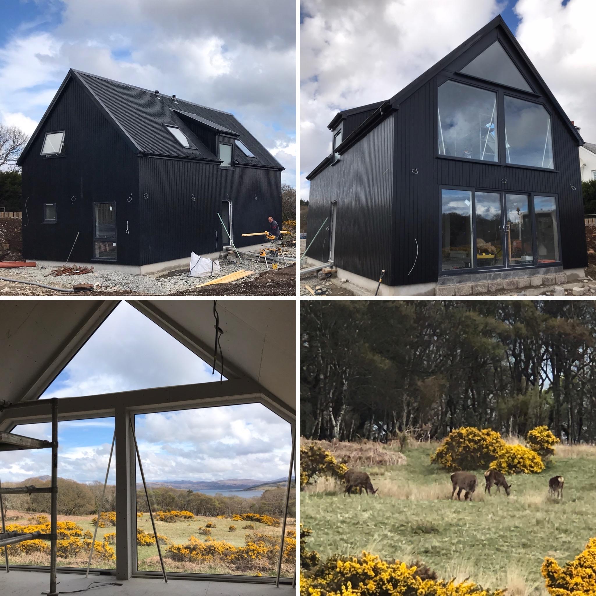

Sorry, haven't logged on for a while. This is our house nearing completion on Isle of Mull. It is a steel portal and timber frame construction, 110m2 plus there is a separate double garage. There is a premium for building on the island - additional transport costs in particular. Originally permission was a 3-bedroom, 'upside-down' design whereas this is a 2-bedroom - ground floor kitchen / diner with bed 1 and shower room. Upstairs is lounge, bed 2 and bathroom. As above, it means we can live on the groundfloor only if needed - this is very much our forever home.
