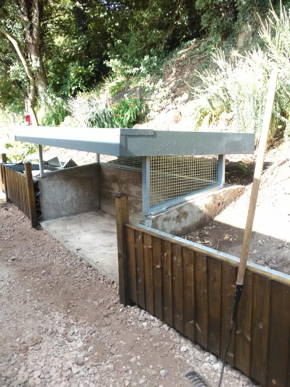

canalsiderenovation Posted August 28, 2021 Author Share Posted August 28, 2021 Before logs.... 1 Link to comment Share on other sites More sharing options...

Onoff Posted August 28, 2021 Share Posted August 28, 2021 4 hours ago, canalsiderenovation said: Yep, dad got lengths and then cut them and welded them to build the frame and galvanised sheet mesh, again a sheet which we cut three sides from and fixed into the frame. It's cost a small fortune but dad doesn't do anything by halves. Like getting an answer from SWMBO! ? Did he buy the lengths of steel "mill finish", weld them together then get the whole assembly galvanised at a place that specialises in hot dip galvanising? Did he weld on plain finish mesh and send the whole lot to the galvanisers or did he get the galv frame back etc? Is your Dad on here, can I ask him??? ?? Link to comment Share on other sites More sharing options...

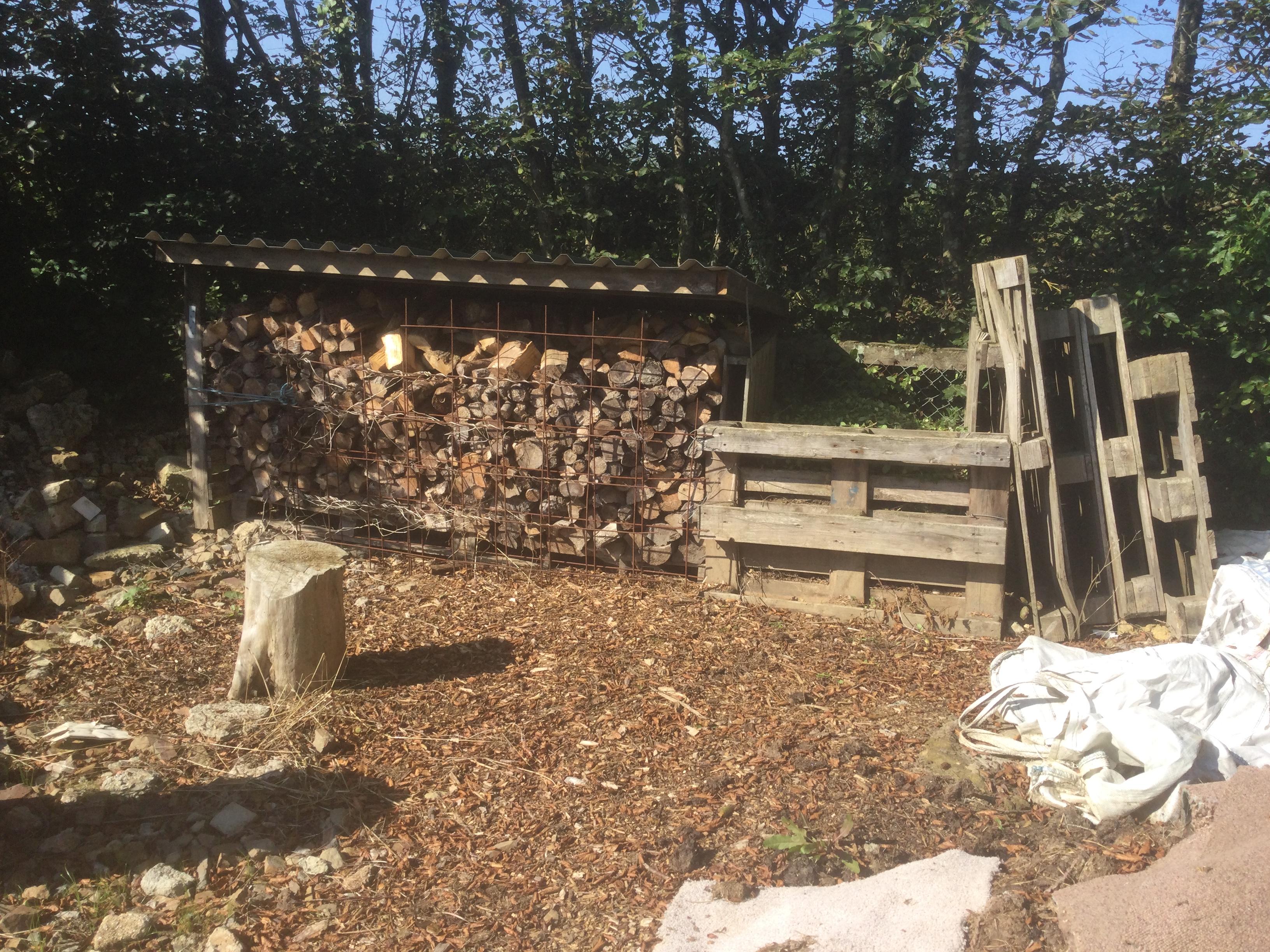

joe90 Posted August 29, 2021 Share Posted August 29, 2021 Oh go on then, includes compost heap as well (the steel mesh is to stop my terrier pulling logs out to get to mice/rats in the log pile) 1 Link to comment Share on other sites More sharing options...

Onoff Posted August 29, 2021 Share Posted August 29, 2021 1 hour ago, joe90 said: Oh go on then, includes compost heap as well (the steel mesh is to stop my terrier pulling logs out to get to mice/rats in the log pile) I've watched a jack burrow through a bag of feed to get to the rat's nest behind. 1 Link to comment Share on other sites More sharing options...
canalsiderenovation Posted August 29, 2021 Author Share Posted August 29, 2021 12 hours ago, Onoff said: Like getting an answer from SWMBO! ? Did he buy the lengths of steel "mill finish", weld them together then get the whole assembly galvanised at a place that specialises in hot dip galvanising? Did he weld on plain finish mesh and send the whole lot to the galvanisers or did he get the galv frame back etc? Is your Dad on here, can I ask him??? ?? The mesh was bought already galvanised then cut to size. The steel frame were second hand fence post again ready galvanised with fence brackets on (took 6 posts with off cuts left over). Dad made it all up and welded up in situ then just silver can car spray on weld joints, mesh screw on inside frame to secure, then all bolted in and fixed. Link to comment Share on other sites More sharing options...
SteamyTea Posted August 29, 2021 Share Posted August 29, 2021 1 minute ago, canalsiderenovation said: mesh was bought already galvanised then cut to size. The steel frame were second hand fence post again ready galvanised 1 minute ago, canalsiderenovation said: Dad made it all up and welded up in situ I love the smell of galvanised steel being welded, gives me time take a few steps back before I take in a deep breath. Link to comment Share on other sites More sharing options...
markc Posted August 29, 2021 Share Posted August 29, 2021 1 minute ago, SteamyTea said: I love the smell of galvanised steel being welded, gives me time take a few steps back before I take in a deep breath. Haha, once spent a whole day flame cutting halved steel structure … that evenings “hot and cold shakes” zincpoisioning wasn’t pleasant ? Link to comment Share on other sites More sharing options...
SteamyTea Posted August 29, 2021 Share Posted August 29, 2021 1 minute ago, markc said: zincpoisioning wasn’t pleasant Similar to a night on the piss, except it lasts a lifetime. 1 1 Link to comment Share on other sites More sharing options...
markc Posted August 29, 2021 Share Posted August 29, 2021 Galv’d not halved ? Link to comment Share on other sites More sharing options...
Onoff Posted August 29, 2021 Share Posted August 29, 2021 1 hour ago, SteamyTea said: Similar to a night on the piss, except it lasts a lifetime. If it doesn't kill you! Link to comment Share on other sites More sharing options...
Onoff Posted August 29, 2021 Share Posted August 29, 2021 1 hour ago, canalsiderenovation said: The mesh was bought already galvanised then cut to size. The steel frame were second hand fence post again ready galvanised with fence brackets on (took 6 posts with off cuts left over). Dad made it all up and welded up in situ then just silver can car spray on weld joints, mesh screw on inside frame to secure, then all bolted in and fixed. Gotcha! It did look "sprayed" around the plates etc. Würth Zinc Light is an excellent "silver" cold galvanising paint. For a darker zinc then their Zinc Dark. The term "cold galvanising" is a bit misleading tbh - they all come in a can but some are better than others. Zinga is very good. Galvafroid is the old favourite. Link to comment Share on other sites More sharing options...
