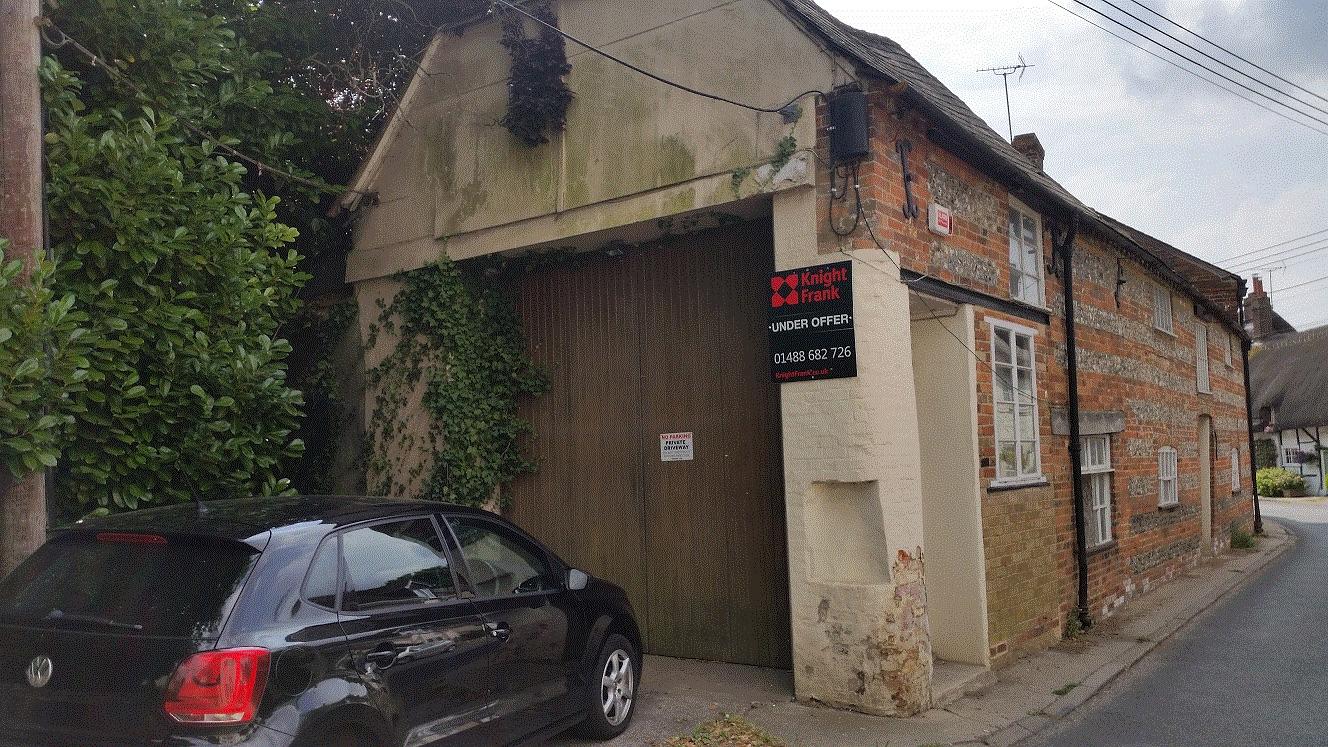

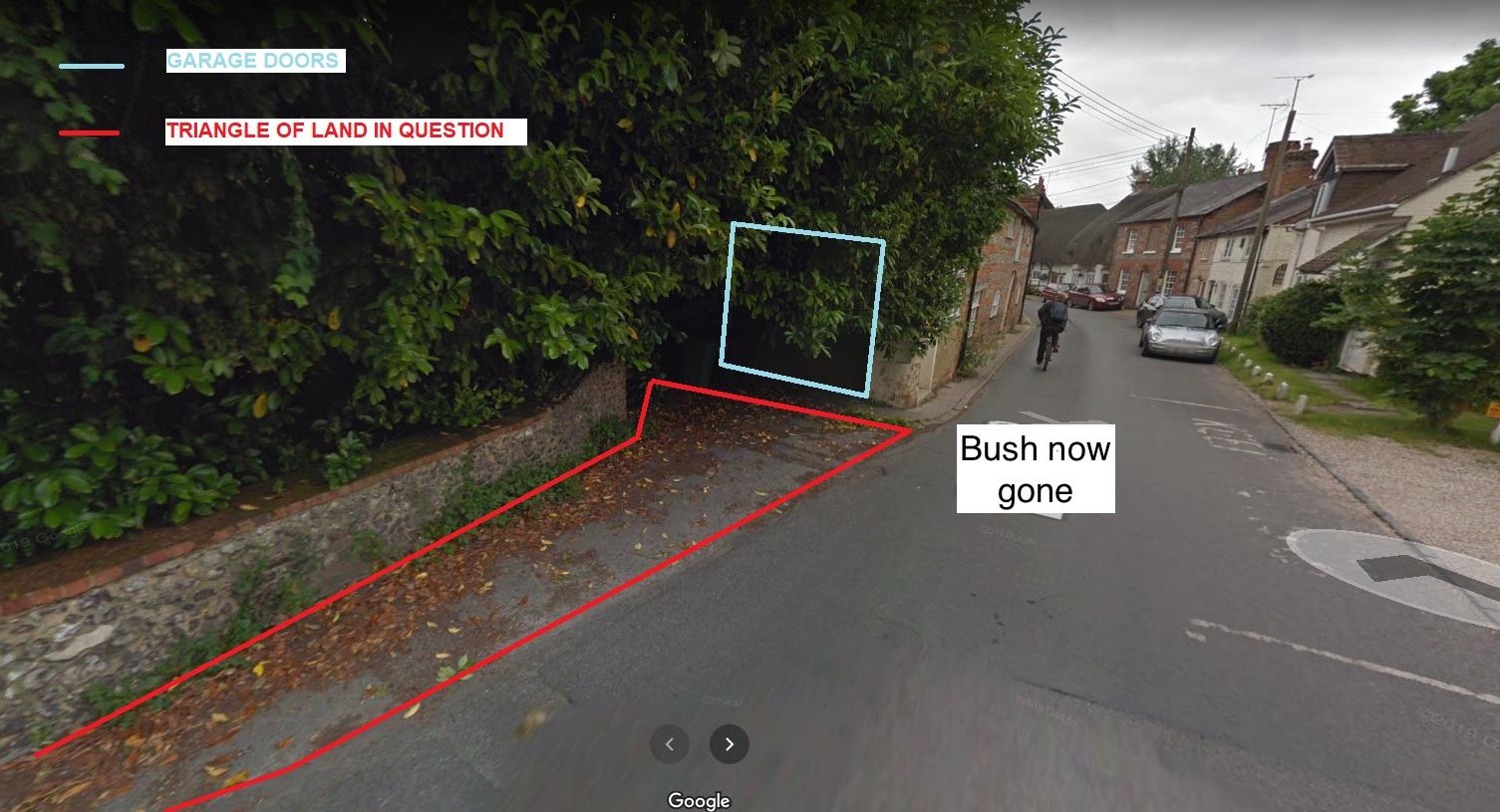

These photos are quite old now but they the best ones to show what I mean.
The car parked is just one of many who consistently park there but the current owner of the neighbouring property isn't understandably concerned because it's not affecting them. It does of course affect my access to garage doors and also the pathway that should be allowed as per my right of access to maintain the wall along the side of my property and gain access to my back garden.
The outline in red is the land in question. Please ignore the large bush which is gone now. It might be a bit confusing.

Well that's just poor behaviour from the people who park there. They can plainly see that it's not part of the road and is blocking your garage access. I think signs and markings won't help unfortunately - you'll need to stick a lockable post or something there to break them of the habit and make it impossible to park there I think. What do the markings on the road the other side say?
My guess is the "under offer" sign screams "building is vacant an not in use"
Put up a "garage in constant use" sign and that will help.
The tapered bit, to a casual observer looks like part of the highway, there really is nothing to say otherwise.  you could try painting a white line just inside your boundary and painting "private" on the bit inside the line?
The Under Offer sign was taken off 3 years ago when I bought it but you are right, during the time it was up for sale people took advantage for sure and now still do.
I’m not sure the conservation officer would allow a lockable post unfortunately but until I own the land I won’t be able to enforce any private parking/access only on it.
As its outside the walled boundary its unlikely to be "within the curtilage of the listed building" so it shouldn't be a problem.
