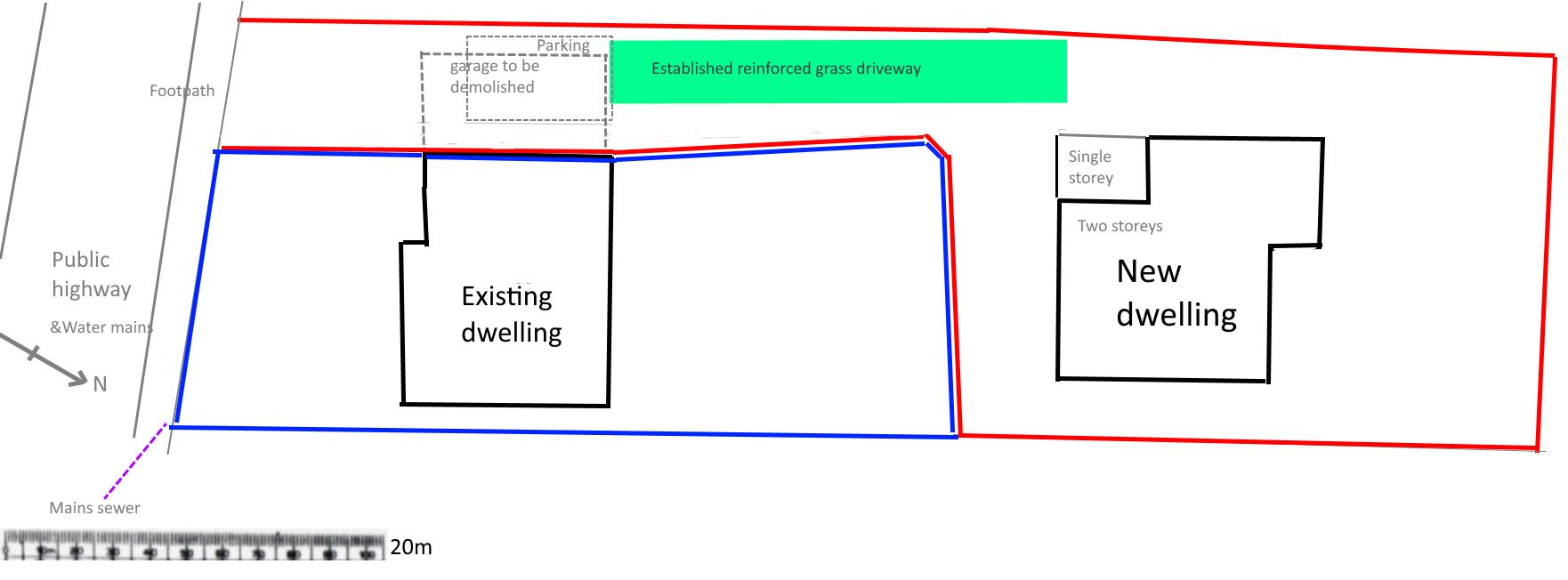

WWilts Posted April 19, 2021 Share Posted April 19, 2021 (edited) Where would you put the water meter/stop for the new dwelling? & 2) Where would you have the water supply pipe entering the new dwelling (meant to ask that, sorry) Edited April 19, 2021 by WWilts forgot what I was actually needing to ask ... duh Link to comment Share on other sites More sharing options...
ProDave Posted April 19, 2021 Share Posted April 19, 2021 What does your water Co say? Usually the water meter is in the underground Toby (stopcock) box where it enters your land. 1 Link to comment Share on other sites More sharing options...
Conor Posted April 19, 2021 Share Posted April 19, 2021 On the footpath, where it says footpath on your drawing. The boxes are always installed in the public realm unless the closestain is already in private land. 1 Link to comment Share on other sites More sharing options...
Conor Posted April 19, 2021 Share Posted April 19, 2021 Run the pipe down the driveway and then in to either the plant room or kitchen. Wherever is a sensible place to have the internal stopcock. You normally run the pipe straight with no bends / joins etc until it's inside the building and above the floor slab. Use ducting then bringing the pipe though the footings and slab. 1 Link to comment Share on other sites More sharing options...

WWilts Posted April 19, 2021 Author Share Posted April 19, 2021 Trying to work out Should I ask for a temporary connection (water / electrics)? Or do as the builder proposes, and apply for a new connection right away? Or do both? Link to comment Share on other sites More sharing options...
TonyT Posted April 19, 2021 Share Posted April 19, 2021 If you can get the permanent connection in, the utility companies will only mess you about and when you want the permanent supply they will be nowhere to be seen. Get the supplies in early and let the only drama be the painter not finishing on time? 1 Link to comment Share on other sites More sharing options...
Gus Potter Posted April 19, 2021 Share Posted April 19, 2021 Just a thought. Once you get the connection sorted make the pipe diameter 32mm alkathene rather than 25mm which is standard for a shortish run on a single dwelling. The pipe will cost a little more, not much cf the trench etc. Doing this means that if you have a few bends in the pipe you reduce flow loss over the under ground section.. lets you play with the rest of the plumbing. 1 Link to comment Share on other sites More sharing options...
Jilly Posted April 20, 2021 Share Posted April 20, 2021 Yup, and learn to check everything, as the builder annoyingly put 25mm in mine instead of the specified 32mm. Also try to have no joins, they put them in mine and tried to hide them I know its not the end of the world, but as Gus says, the pipe is only a few pounds more and comes in 50m lengths. 1 Link to comment Share on other sites More sharing options...
