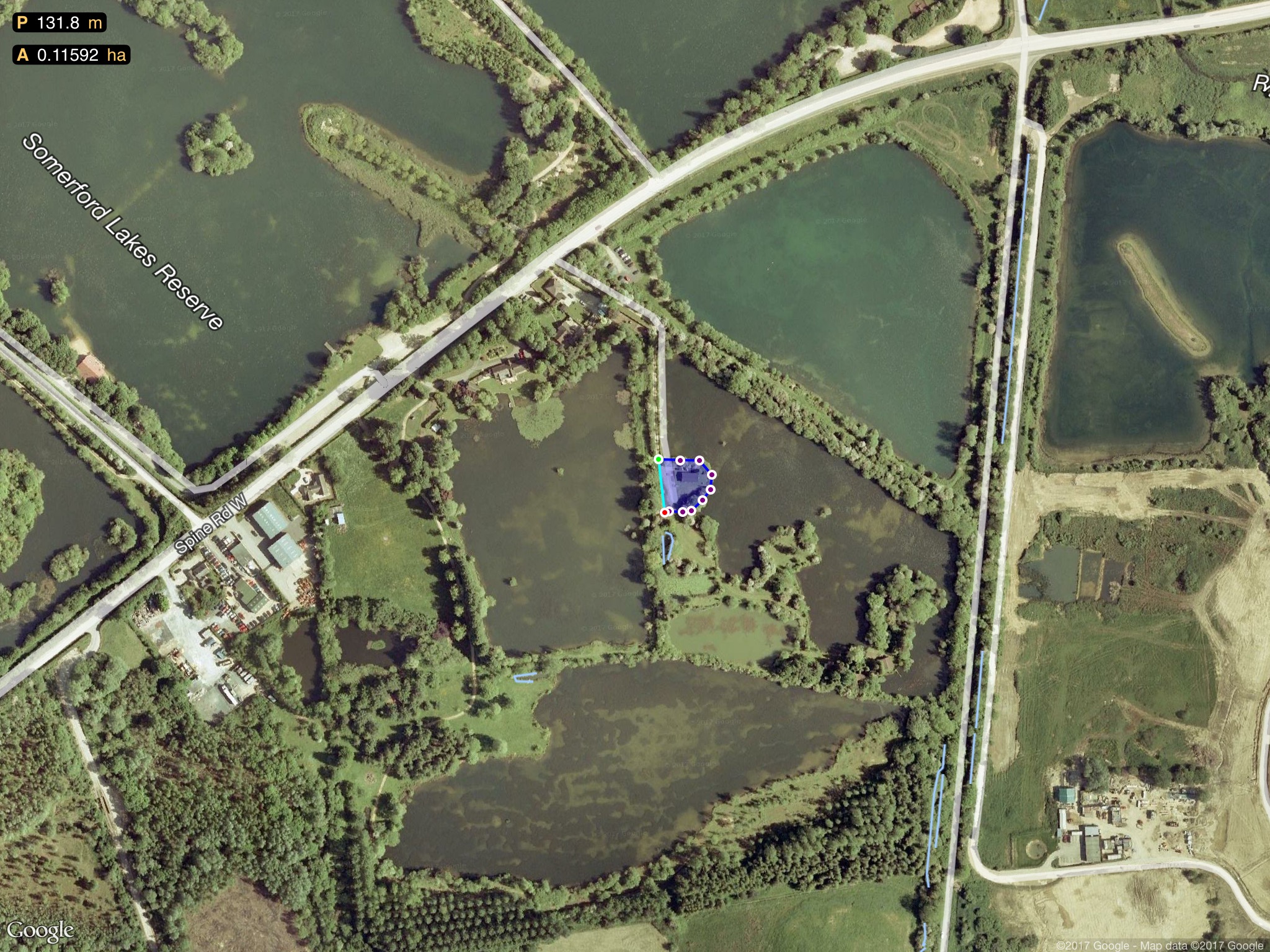

Russell griffiths Posted February 22, 2017 Author Share Posted February 22, 2017 Thanks for all your input guys. Thanks to @JSHarris for his explanation on how this all works. @ProDave I'm going to have a dig around on Friday to check level of water, i will try to up load a pic and it will probably explain why our water table is so high. If you look at the wooden looking building with the car parked in front this is where we are trying to get consent for the new place,as far as the leach field goes I have no idea where it is we have owned the site since 1991 and the septic just does its thing, I get it emptied every 2 years. We have loads of space for a new one, we also have a company working with us on flood risk assessment and disposal of rainwater and it was them that suggested the biorock as they said the cleaner discharge means we could stick it different places. I will go back to them. For the money they are charging they might as well earn it. Link to comment Share on other sites More sharing options...
ProDave Posted February 22, 2017 Share Posted February 22, 2017 Wow. Where are you. the middle of Hollamd below sea level? Do you own the whole "island"? I take it from the pictures that the water table is pretty constant, unlike here where it goes up and down a lot, sometimes very quickly. I had to choose when to dig the hole and plant our treatment plant, and even at the end of a fairly dry summer, it filled with water quicker than I could fill it with concrete. I'll assume you are in England. I am not up to speed with the English regs, only the Scottish ones. Up here, any infiltration system and indeed the treatment plant itself has to be 10 metres away from a watercourse. I would say that rules out the triangle of land next to the existing building. You would be looking at "land" further to the bottom of that picture to find an area of land that is >10 metres from any water to install an infiltration system. I really think your best bet (whatever treatment system you use) would be an above ground disposal like the filter mound or puraflow system. I can go into more details if you want to. I had a long thread running on the old place while I looked at different solutions, and learned a lot of stuff I never actually needed to put into practice. Do those "watercoures" flow? would you get permission to discharge into them? Link to comment Share on other sites More sharing options...

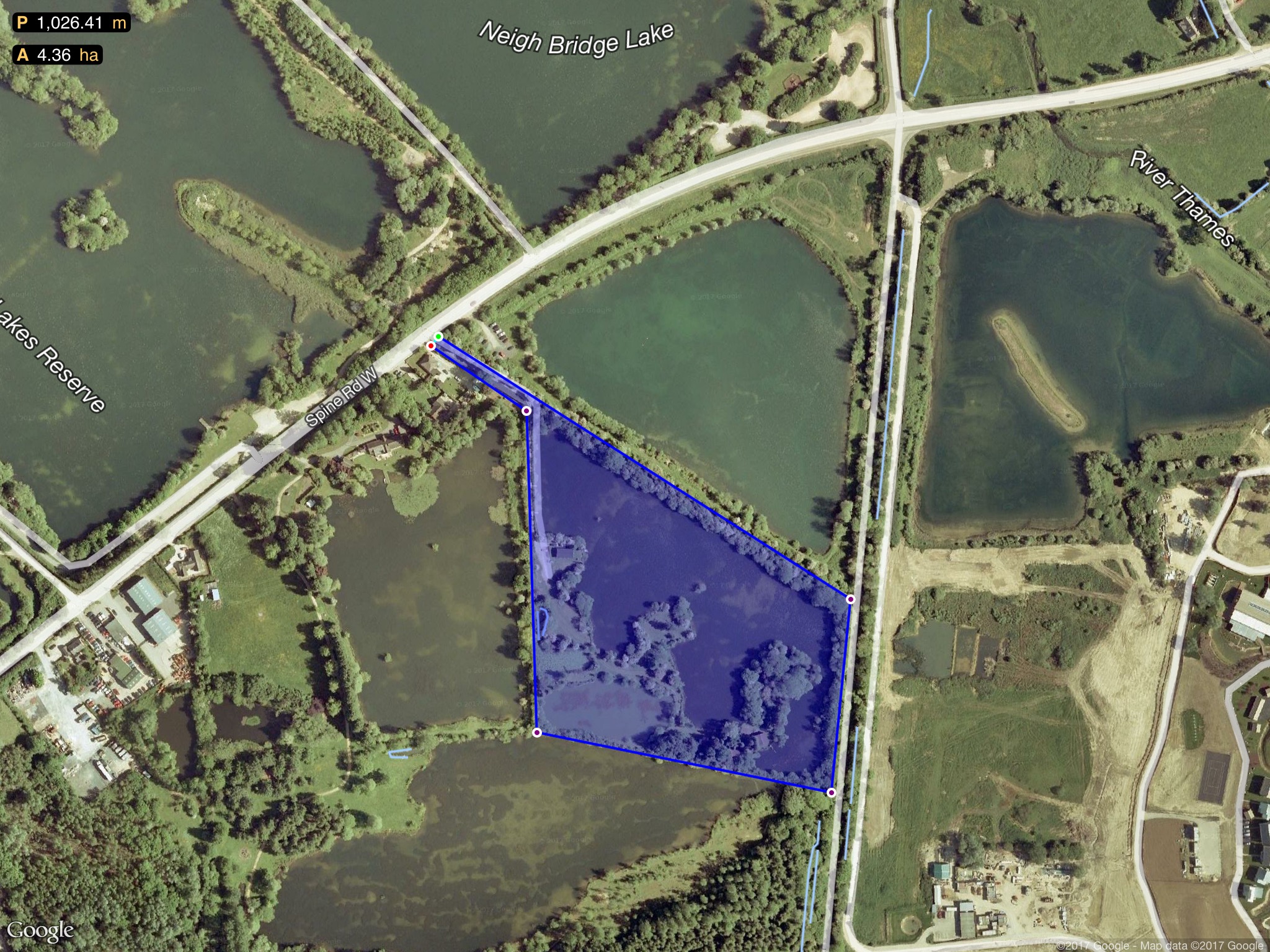

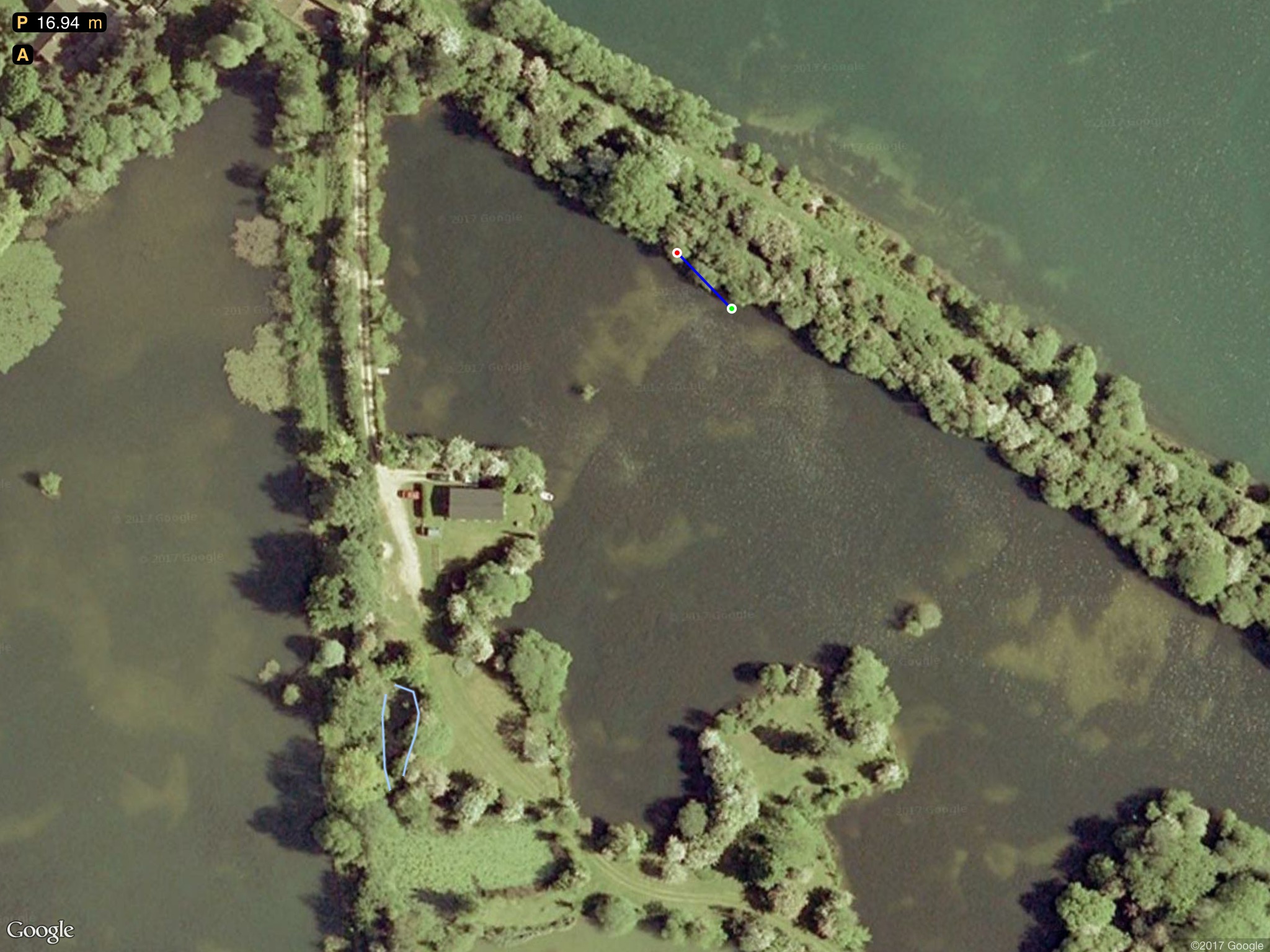

Russell griffiths Posted February 22, 2017 Author Share Posted February 22, 2017 Another pic to give you a better idea. The area is in the Cotswolds it's a system of gravel pits that where dug in the late 40s, we own the lake immediately in front of the cabin, this lake is aprox 7 acres in size we have 2 other lakes on site, the build plot is aprox 1 third of an acre, I don't see a problem finding a space that is 10m from water but it will probably mean having to put it under the car park. I will get the hydrology guy on it, we have had a full topo survey done and we actually sit at 88m above sea level, the lake surface is aprox 600mm below ground level and the soil is 200mm topsoil and then gravel. The lake fluctuates by about 100 mm in the course of the year and has an outlet into a small stream at its furthest point from the house site. Link to comment Share on other sites More sharing options...
ProDave Posted February 22, 2017 Share Posted February 22, 2017 Do you only own the bit of land you have encircled or any of the land further "south" (assuming north up) Being on gravel, you will have a good infiltration rate so the soakaway area shouldn't need to be too big. The problem is the infiltration field needs to be above the water table at it's highest seasonal level. That may rule out an underground infiltration filed. Even if a shallow infiltration field was allowed, you would probably need a treatment plant with a pumped output, as just about all of them will have an invert depth of more than 600mm (mine is closer to 900mm) At the end of the day, it's building control who say what you can do. I think you need to talk to them and see if they are happy with a shallow underground infiltration field. Link to comment Share on other sites More sharing options...

Russell griffiths Posted February 22, 2017 Author Share Posted February 22, 2017 3 hours ago, JSHarris said: I know that area well, and have stayed in a cabin nearby, right on a lakeside. That had a pumped air treatment plant discharging into the lake. I know the owner reasonably well and can ask what problems he had sorting out the treatment plants he has discharging into the same lake, if you like (he has 7 or 8 cabins around the same lake). Anthony Edmonson. By any chance. If so we are just over the road. Link to comment Share on other sites More sharing options...
Russell griffiths Posted February 22, 2017 Author Share Posted February 22, 2017 This is the basic outline. We have just over 11 acres, but 8.5 of that is water ? Link to comment Share on other sites More sharing options...
