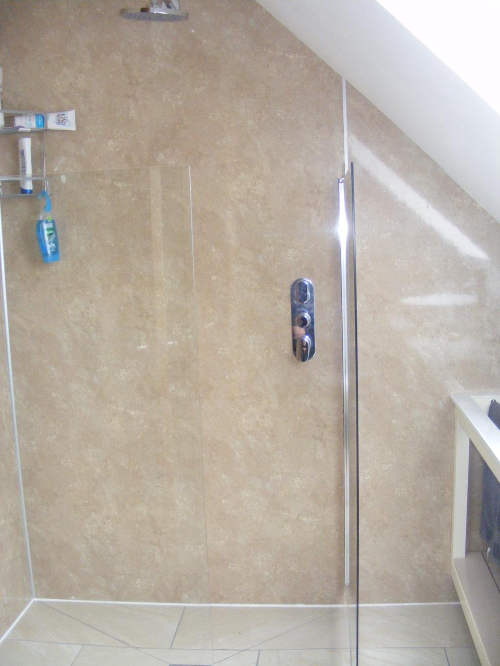

ProDave Posted April 6, 2021 Share Posted April 6, 2021 Wet room. Multipanel on the walls, tiles on the floor. Hinged glass screens just to stop spray splashing too far, that are not very tall and don't touch the floor. Squeegee the lot after use . COLD causes mould. in a warm house never get mould on any surface. Link to comment Share on other sites More sharing options...

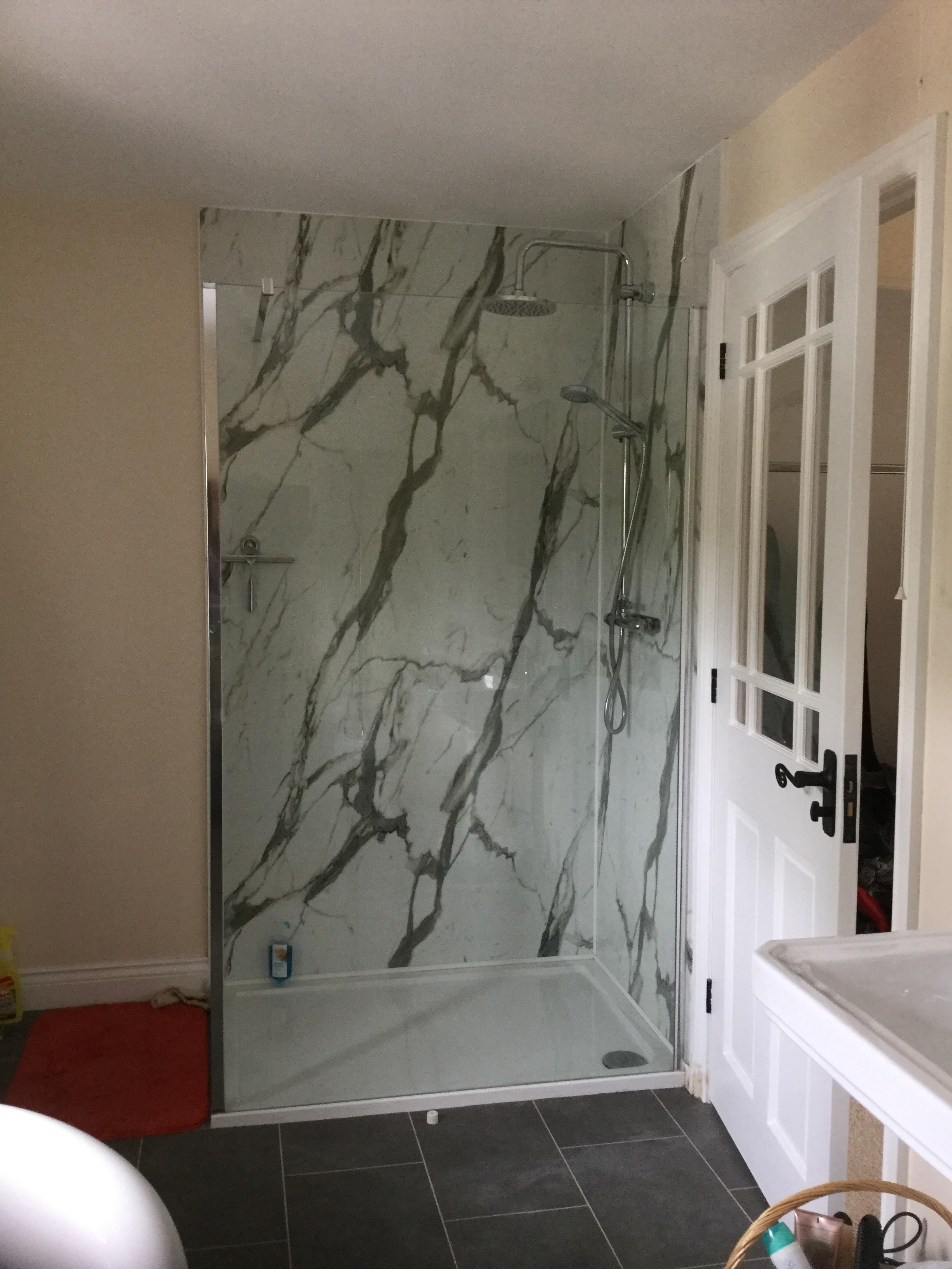

TonyT Posted April 8, 2021 Share Posted April 8, 2021 I’m a shower tray with upstand. Multipanel board, with manufacturers adhesive and then a good quality anti bacterial silicone around the perimeter. Link to comment Share on other sites More sharing options...
joe90 Posted April 8, 2021 Share Posted April 8, 2021 (edited) I don’t like wet rooms, I have slim shower trays (large) fixed glass panel with flipper and with multi panel and a clip system that has the sealant within/behind it so no sealant showing to get mouldy ( edit... only silicone is glass to tray and mild bleach ensures no mould). Edited April 8, 2021 by joe90 Link to comment Share on other sites More sharing options...

SoldierDog Posted April 9, 2021 Share Posted April 9, 2021 Just finished mine, low profile shower tray sealed with abacus no more leaks tape. Multipanel on the walls and i didnt use the multipanel seal kit following recommendations here, I wouldnt go back to tiles. Silicon (UniBond Triple Protection) also finished with Cramer tool, nice pro finish but still a bugger getting a nice 3 way corner to look good. Link to comment Share on other sites More sharing options...
Onoff Posted April 9, 2021 Share Posted April 9, 2021 55 minutes ago, SoldierDog said: still a bugger getting a nice 3 way corner to look good. +1! Do you attack in 2/3 hits or do you just need to be better? Link to comment Share on other sites More sharing options...
SoldierDog Posted April 9, 2021 Share Posted April 9, 2021 23 minutes ago, Onoff said: +1! Do you attack in 2/3 hits or do you just need to be better? I couldnt get it nice with the tool ended up doing the corners the old school method, wet soapy finger and blended it in, looks ok. Link to comment Share on other sites More sharing options...
