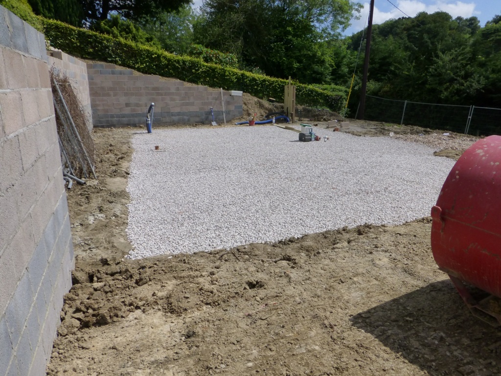

All I did was lay the base stone in compacted layers, to their spec, with around 300mm all around as an additional French drain.  I had a soil pipe coming up and some ducts for the water pipe, phone line and power cable, all in exactly the right place according to my plans.  They had those positions and they laid and levelled the 50mm grit layer and placed the outer ring of EPS, with the upstands, so that the North East corner was in the correct position relative to my datum point near that corner, and with the North wall parallel with the retaining wall we'd already built, and the correct distance away from it (again, as per my plans).
The didn't lay any drainage pipes for us, as we'd already put them all in well under the sub-base and had them pressure tested for BC before MBC arrived on site.  That, together with the compacted sub-base of type 3, was all done by our ground works guy.
The did leave the UFH tails poking up out of the slab on a temporary timber frame and also put the 25mm conduit I'd made up to take power from the wall to the kitchen island in the place I'd marked out on the plans.
This is what our site looked like not long before the MBC guys arrived; you can just make out the ducts and soil pipe poking up at the centre left in the distance (the other stuff is the ground works guys radio and tool box).  The type 3 is 150mm deep, whacked down in layers:

From memory we just gave them a FFL mark and a site plan, and they worked from there.
I suspect that even if you mark it out they'll double check anyway, and since they're doing drains as well I suspect they'll be even more sure to carefully measure everything.
I think i will leave it to them. But check and check again as we have seen that sometimes the pipes are in the wrong place.
