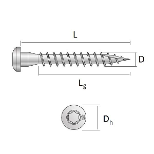

fiaraziqbal Posted April 5, 2021 Share Posted April 5, 2021 I really hate asking this. In every aspect of my life joist = nails for every conceivable reason. However, i am time restricted and was really looking at getting hold of the DeWalt DCN694P2 positiv placement toy( all power tools still hold that excitement for me) every one is out of stock and i a left with a dillema, wait or...... screws, now not your every day found atthe bottom of my box screw but something like https://www.tcfixings.co.uk/product/simpson-tx20-csa-connector-screws-50mm-x-40mm/17500?gclid=CjwKCAjw6qqDBhB-EiwACBs6xwa2SF90DhDM2TIJryAP2KBUXeJfDaWTM8FCfaywxZxP-ZfdeOndGhoCkqYQAvD_BwE Opinions? product reviews? I actually hate the thought of screws... ahhhhhh Thanks in advance Link to comment Share on other sites More sharing options...

fiaraziqbal Posted April 5, 2021 Author Share Posted April 5, 2021 10 minutes ago, Mr Punter said: Never used the screws before but assuming the fit OK through the holes in the hangers they look good. Also, if you mis-nail a hanger they are tricky to move and the screws could help. I am a bit crap with a hammer and the twist nails just seem designed so I keep smacking my fingers. The screws would also be good for the concealed type hangers. Do you need the 4mm ones for a standard hanger? 5mm seems quite fat. i worry about shearng forces on a screw but really havnt decided on which one quite yet Link to comment Share on other sites More sharing options...
tonyshouse Posted April 5, 2021 Share Posted April 5, 2021 For joist hangers NEVER EVER USE SCREWS! The heads sheer off, need to use heavy duty twist nails buy a compressed air nailer cheapo ones are ok , never look back Link to comment Share on other sites More sharing options...
fiaraziqbal Posted April 5, 2021 Author Share Posted April 5, 2021 18 minutes ago, Russell griffiths said: Depends how many you need to put in, I hired a positive placement nailer for a week, about £100 all in but I had a few hundred joist hangers plus triple grips for the roof in total over 2000 nails, so it was a no brainier I looked at hiring the paslode, i like purchasing tools especially when i have three builds of one sort or another planned. BUt i may go down the route as wife isnt too impressed with me spending money on tools! Link to comment Share on other sites More sharing options...
fiaraziqbal Posted April 5, 2021 Author Share Posted April 5, 2021 23 minutes ago, tonyshouse said: For joist hangers NEVER EVER USE SCREWS! The heads sheer off, need to use heavy duty twist nails buy a compressed air nailer cheapo ones are ok , never look back I have a hikoki and love it, just not so keen on missing the hole so wanted a positive placement, i do know what you mean in terms of screws but apparently that link i shared is for screws you can use in structural appliactions Link to comment Share on other sites More sharing options...
tonyshouse Posted April 5, 2021 Share Posted April 5, 2021 The screws look OK must have happened since I retired, sorry Link to comment Share on other sites More sharing options...
Russell griffiths Posted April 5, 2021 Share Posted April 5, 2021 All the hanger manufacturers make screws now, just don’t use standard wood screws. Link to comment Share on other sites More sharing options...
Mr Punter Posted April 5, 2021 Share Posted April 5, 2021 30 minutes ago, tonyshouse said: The screws look OK must have happened since I retired, sorry Yes, it was news to me too. Chunky looking though and clearly designed to work with the shear forces. Link to comment Share on other sites More sharing options...
tonyshouse Posted April 5, 2021 Share Posted April 5, 2021 I still would never use screws, too easy to make a mistake Link to comment Share on other sites More sharing options...
MortarThePoint Posted April 9, 2021 Share Posted April 9, 2021 On 05/04/2021 at 20:27, tonyshouse said: I still would never use screws, too easy to make a mistake I was windy about using screws and spoke to the technical guy at Simpson StrogTie who put me at ease. To paraphrase (so don't quote me on it) you should be able to use the CSA 4.0 x 30mm anywhere you'd normally use a 3.75x30 twist nail. He said they are hoping to do a paper on it. I needed to add some frame anchors to tiny truss infill that had already had tiles fitted to so didn't fancy hammering. Worked a charm. Don't use an impact driver and set your combi or screwdriver to low torque so as not to strip the thread when tightening. It even looks really nice when done, semi architectural. I wouldn't mind having brackets covered in these on show but I would be less keen on having brackets covered in twist nails no show. I'd be more nervous using them on a big girder truss, but I think that's just me being old fashioned. Screws are the future I think, as long as it's the right screw! A wood screw would be a shocker. Link to comment Share on other sites More sharing options...
