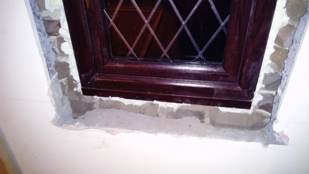

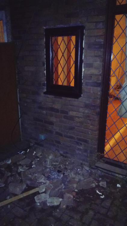

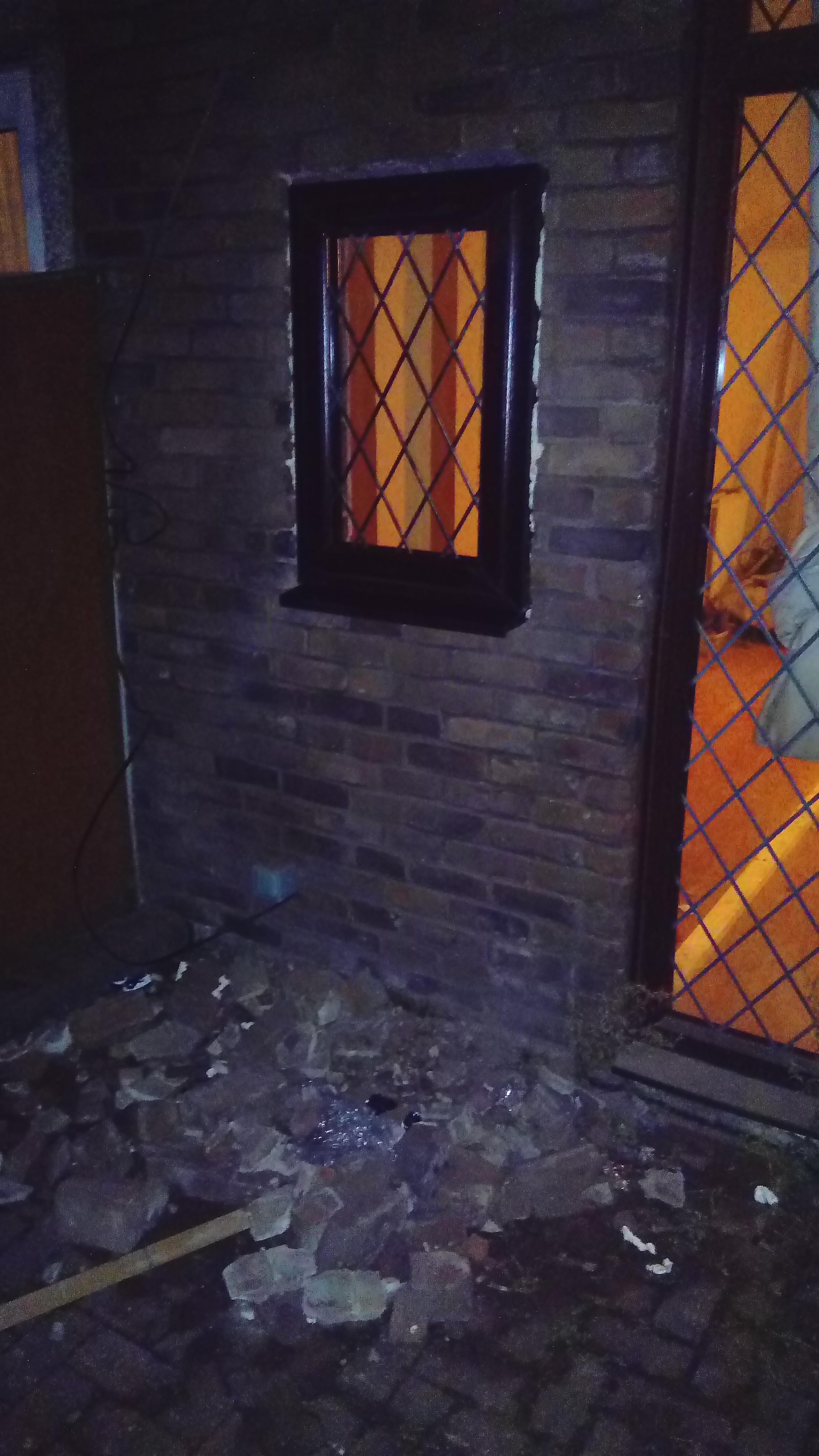

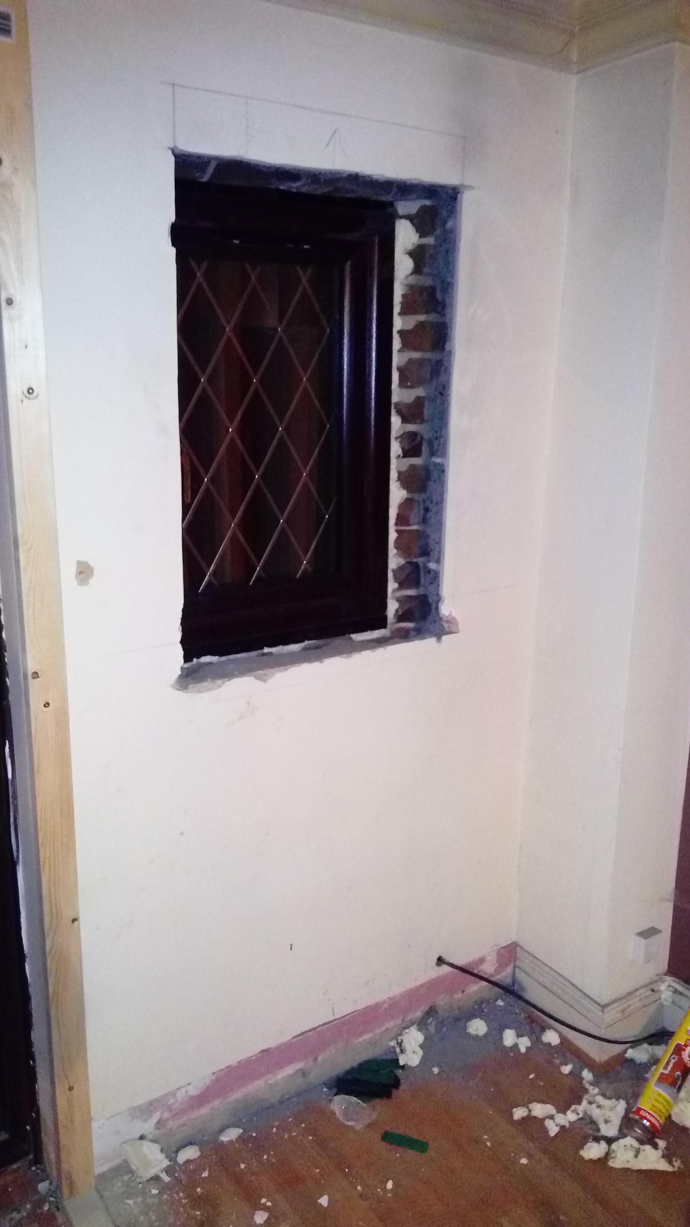

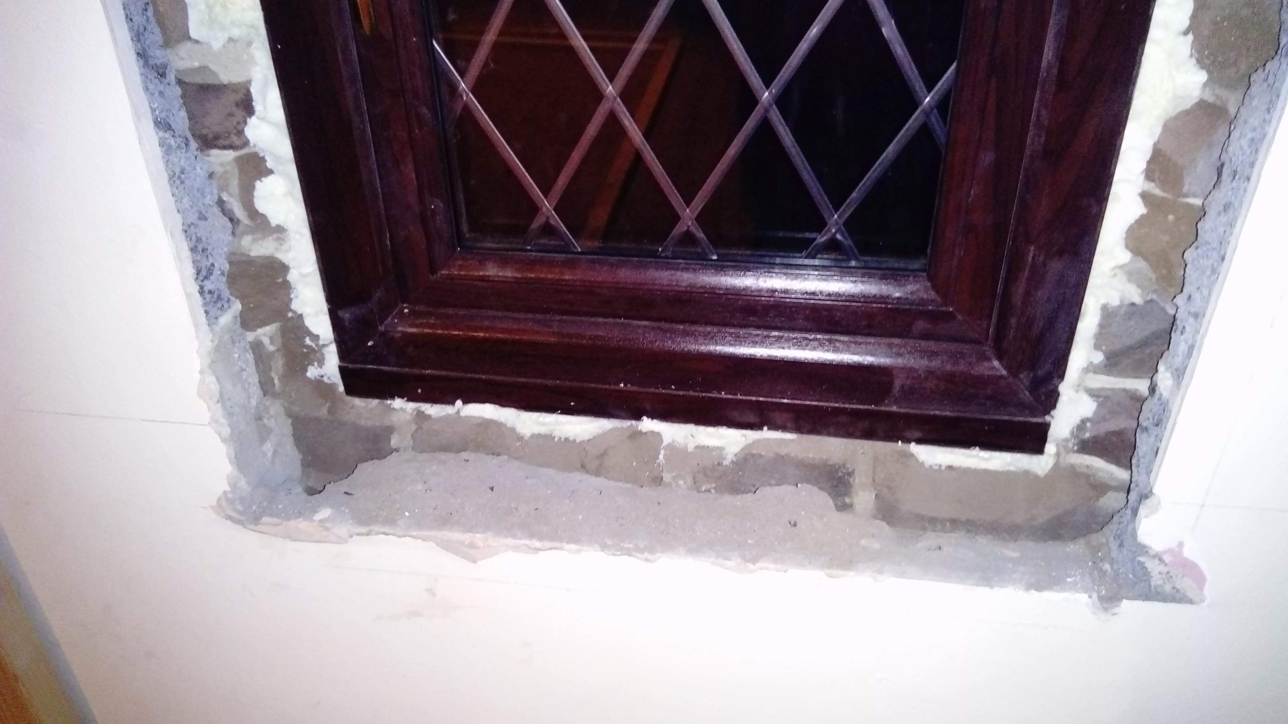

Bradley Posted March 28, 2021 Share Posted March 28, 2021 Please can someone help me. I have just had a survey done and the surveyor has reported that my house is 'of non traditional PRC construction with an asbestos roof, believed to be of concept 4 type' ...SO, my mortgage lender will not lend on the house. My term has ended and i am going to be repossessed. I have owned the house for 15years. I have 2 previous surveys 1. when i originally purchased the house and 2 when neighbour did new roof which say my house is traditional construction with a semi pitched asbestos roof. My house has beed mortgaged before. I have photos of when a window was installed a few years ago. Can anyone look at the photos and tell me if you think my house exterior walls are Traditional Construction brick and block or Non traditional PRC Concrete. Please see photos of the wall when a new window was installed. There are clearly bricks on the floor. Any help appreciated. Link to comment Share on other sites More sharing options...

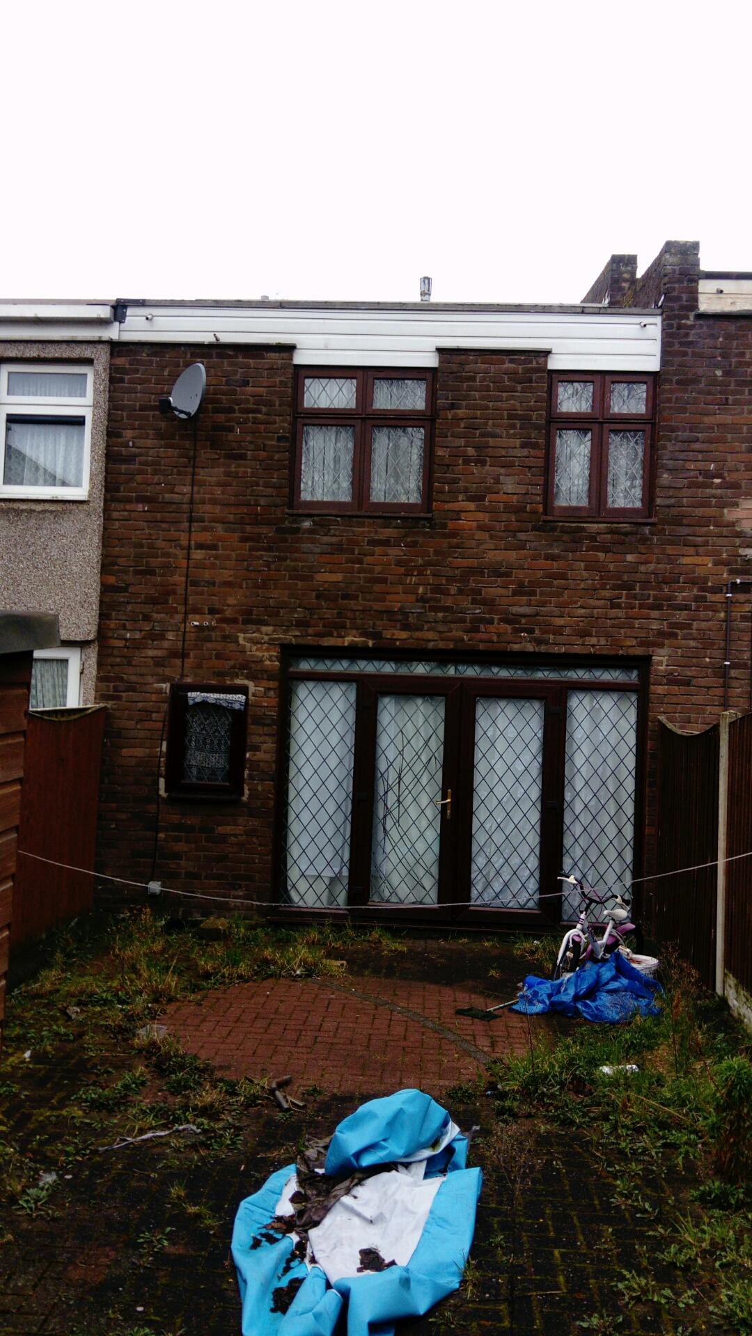

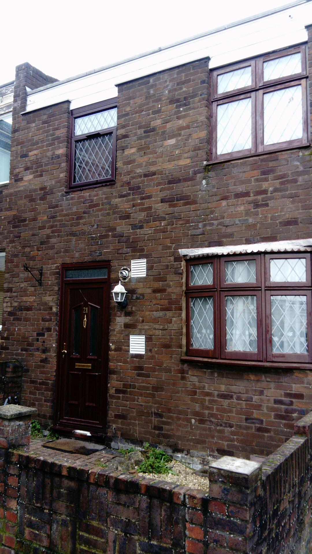

Bradley Posted March 28, 2021 Author Share Posted March 28, 2021 Here is the front and back of the house Link to comment Share on other sites More sharing options...

Mr Punter Posted March 28, 2021 Share Posted March 28, 2021 Cab you talk to someone in your local Building Control departments? They must be familiar with these. From the picture it looks like brick and block. I guess if you looked in the cavity you could see if it had a steel frame? Link to comment Share on other sites More sharing options...
Big Jimbo Posted March 29, 2021 Share Posted March 29, 2021 Go and talk to the neighbours. All the houses look the same, so it should be easy to find out from them what method of construction has been used. Best of luck. Link to comment Share on other sites More sharing options...
Gone West Posted March 29, 2021 Share Posted March 29, 2021 As you are in a terrace I would find out who your neighbours use for lenders. Link to comment Share on other sites More sharing options...
Bradley Posted March 30, 2021 Author Share Posted March 30, 2021 hi all, thank for your replies. Its a remortgage, the current lender will not lend to me because i have more than 3 buy-to-lets so i need to find another lender. Ive have exhausted all efforts with the council in trying to obtain history and construction with the house. The neighbors are council properties and the tenants know nothing. I just need as many experienced surveyors or builders to look at the wall in my photos and give me their opinion on whether its Traditional Construction brick and block or Non traditional PRC Concrete. I am in the process or trying to find a structural engineer to come and give me a report. Bear in mind i have 2 previous surveys which both say the house is traditional brick...I think the recent surveyor from the lender has made a crucial error Link to comment Share on other sites More sharing options...

Bradley Posted March 30, 2021 Author Share Posted March 30, 2021 Hi Peter, yes the surveyor is registered with RICS. Oh i didn't know i could complain to RICS. I will look into that. Thankyou. Yes i am getting a structural engineer to survey. I posted the photos on here for additional opinions of the wall construction in case 10 people replied and said, yes it PRC construction. Link to comment Share on other sites More sharing options...
Bradley Posted April 9, 2021 Author Share Posted April 9, 2021 SOLVED - The surveyor amended the construction to traditional brick. Thank you all for your kind help and advice. Take care 5 Link to comment Share on other sites More sharing options...
