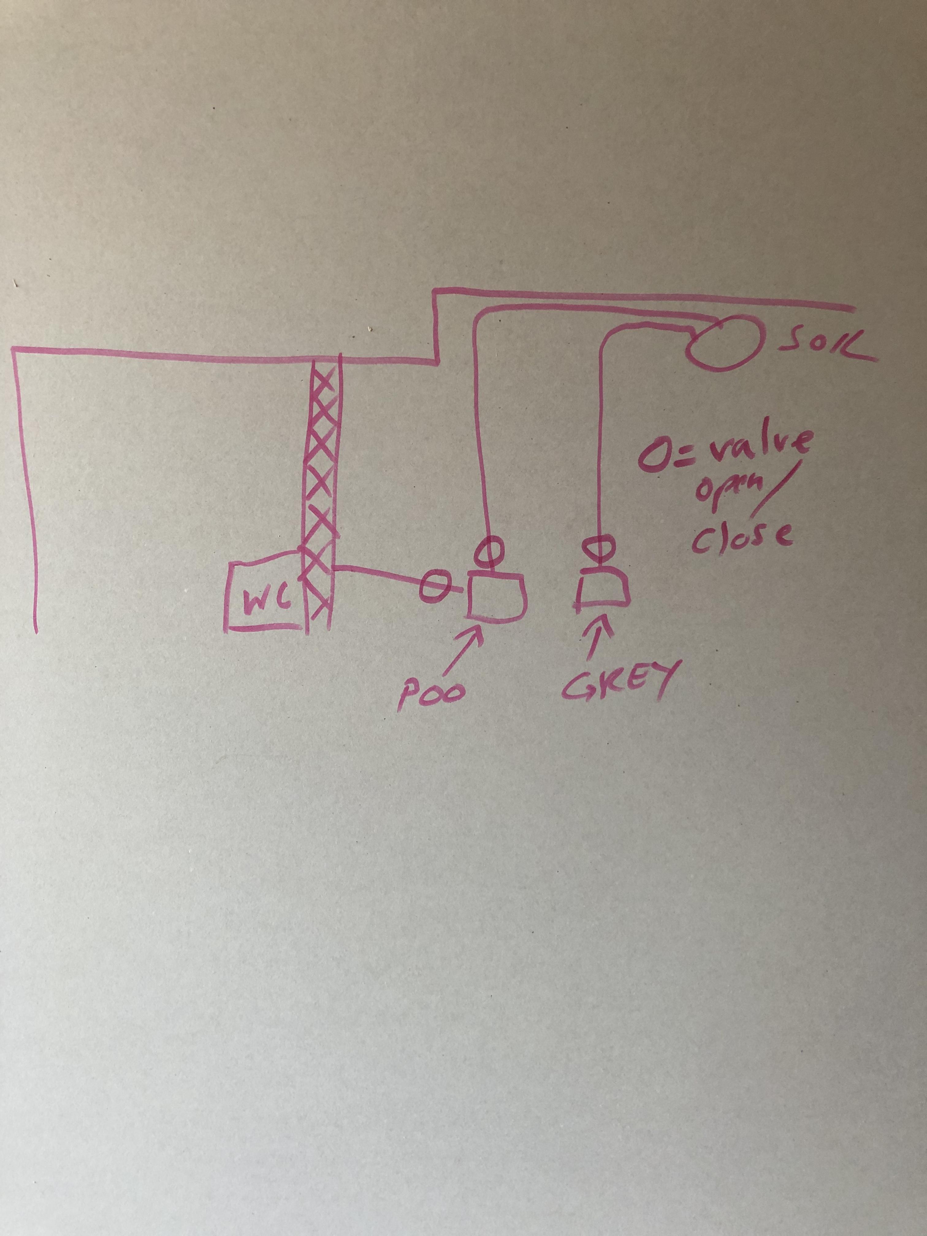

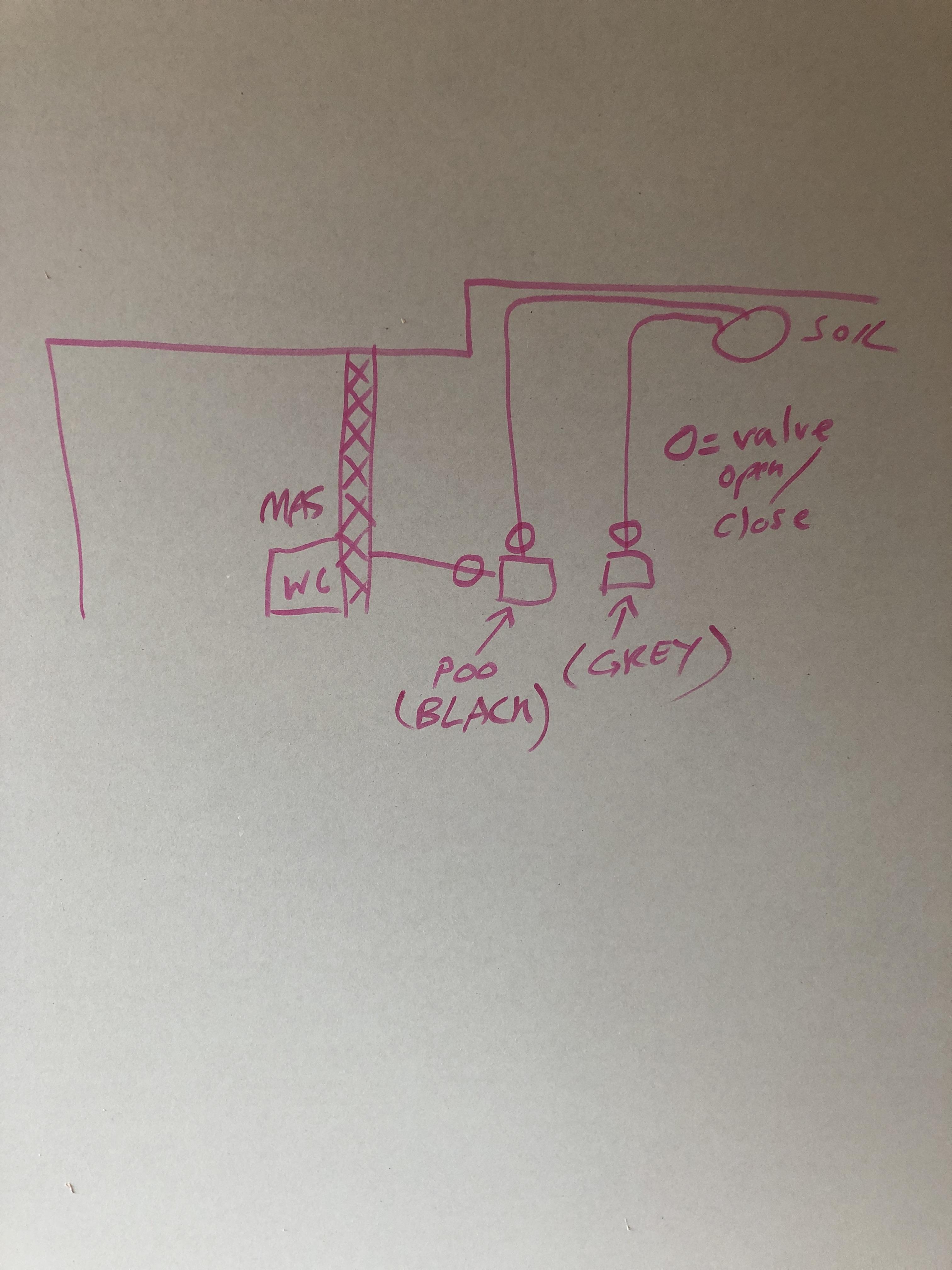

Pocster Posted March 25, 2021 Author Posted March 25, 2021 SWMBO was over again ffs Current plan is this . Macerating WC pumps ? into grey water macerator which then dumps into soil pipe . Meanwhile sink/washer etc. grey water uses a seperate pump . I’ll put valves on both vertical runs so I can avoid grey or ? running Back when they break ( not if ) . I’ll set a zwave sensor on macerator that receives the ?. So at least if it doesn’t trigger I.e draws too little current or indeed too much than at least HA can inform me . I’ll probably put a valve on the input pipe . So when it busts can turn inlet pipe and outlet pipe off . My other plan was when it fails I see no reason why I can’t drill a hole straight into the saniflo unit to drain it of ?. Trying to minimise the fun when it goes wrong . Apart from relatively easy access to the pumps any other suggestions to take into account when failure strikes ?
PeterW Posted March 25, 2021 Posted March 25, 2021 Don’t think a grey water pump will accept black waste - you will need a pair of macerators and block the WC connection to add the feed from blender No.1 in to this ...
PeterW Posted March 25, 2021 Posted March 25, 2021 Ok ignore that - thought you wanted to do an A-B pump route
Pocster Posted March 25, 2021 Author Posted March 25, 2021 2 minutes ago, PeterW said: Ok ignore that - thought you wanted to do an A-B pump route Erm . You’ve confused me wc has a ? macerator which then pumps to the first grey pump ( making it not grey anymore ? ) - then up and out ( hopefully )
markc Posted March 25, 2021 Posted March 25, 2021 Macerated waste will still have solids that a grey water pump is unlikely to cope with .... blockage clearing wont be pleasant 1
PeterW Posted March 25, 2021 Posted March 25, 2021 3 minutes ago, markc said: Macerated waste will still have solids that a grey water pump is unlikely to cope with .... blockage clearing wont be pleasant +1 to this ..! Which is the point I was making. Grey water saniflo are just a pump and a float switch in a box. WC waste is known as black water and contains solids. Different type of pump.
Pocster Posted March 25, 2021 Author Posted March 25, 2021 4 minutes ago, PeterW said: +1 to this ..! Which is the point I was making. Grey water saniflo are just a pump and a float switch in a box. WC waste is known as black water and contains solids. Different type of pump. Ok . So wc macerator into black water macerator . So ......

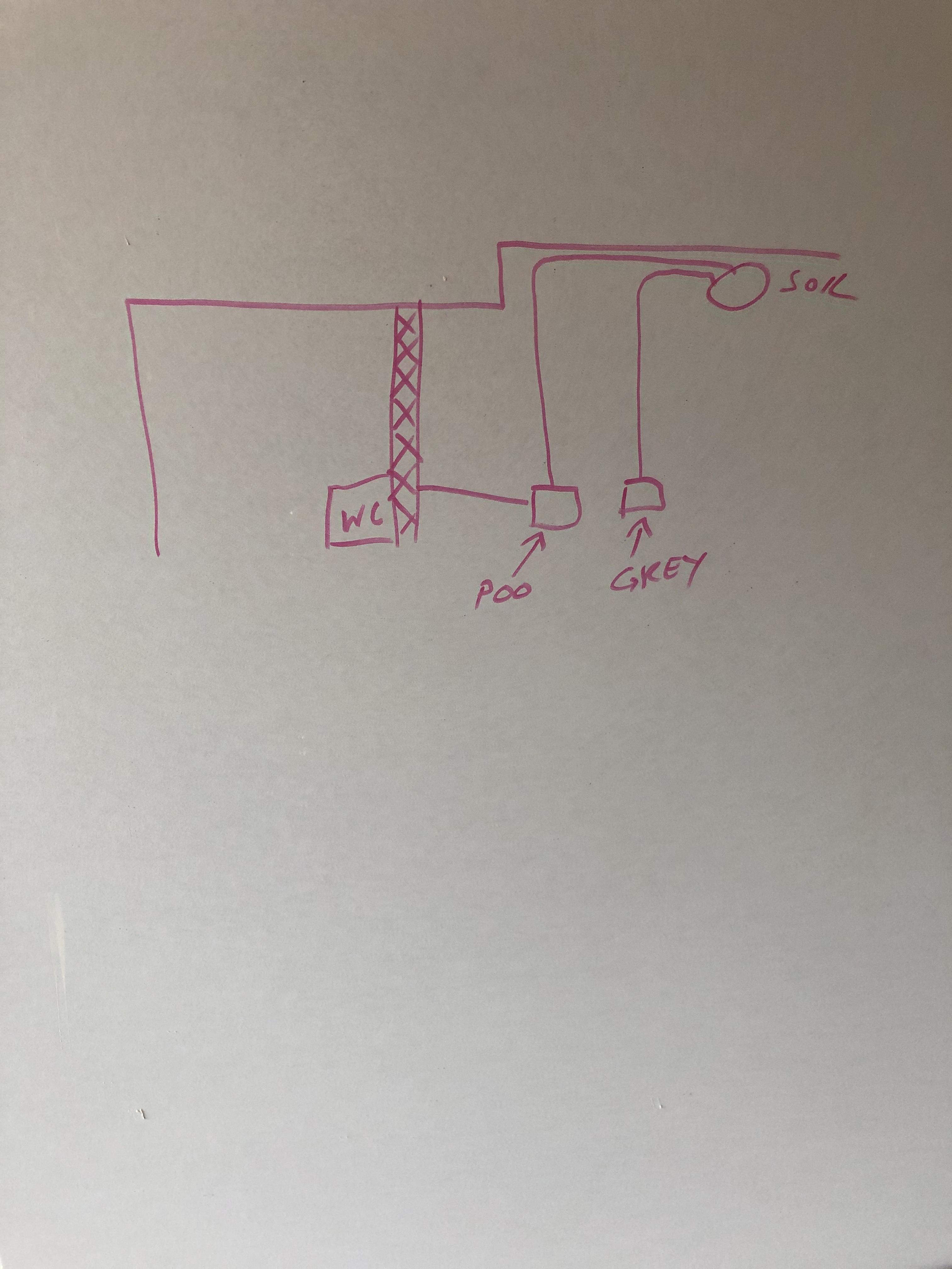

Pocster Posted March 25, 2021 Author Posted March 25, 2021 The horizontal pipe at the top that goes into the soil pipe . Should both outputs go into that 1 pipe ? . Or better to have a independent pipe into the soil I.e 2 horizontal pipes
Pocster Posted March 25, 2021 Author Posted March 25, 2021 Can you get a cap to seal off the toilet standard waste input ? ( that’s what you meant @PeterW I assume ) .
Pocster Posted March 25, 2021 Author Posted March 25, 2021 Should the pipe run from wc macerator to black macerator be a larger bore ? . My logic being if black macerator blocks ( for example ) the pipe will hold the contents . Or am I overthinking it now ? ?
Pocster Posted March 25, 2021 Author Posted March 25, 2021 Thinking about it . if the vertical black pump pipe is full of ? and it fails would you be able to turn the valve to isolate and stop it running back ? . Trying to think of a guaranteed way to isolate or even drain the pipe in a “nice” I.e controlled way .
PeterW Posted March 25, 2021 Posted March 25, 2021 So these can take a standard 110mm waste pipe which you can cap off and then run a 38mm pipe or similar into them. That needs to be as short as possible but also your input pipe needs a fall on it, especially if it has just a WC feeding it. You’ll need to come up out of the macerator by a foot or so then get a decent slope to the next one. Not sure if this will work in reality and these things are noisy - one is bad enough, a pair running ...??? Have you not had the sensible conversation and said the “No” word to Mrs Pocster or is that something that is banned in the dungeon ..??

Pocster Posted March 25, 2021 Author Posted March 25, 2021 This type of thing for the black macerator . Block the conventional inlet and use a low one ( so I get the fall from the Wc macerator ) https://www.plumbworld.co.uk/flo-force-max-macerator-pump-101425-1252355

Pocster Posted March 25, 2021 Author Posted March 25, 2021 3 minutes ago, Gav_P said: I was just thinking whether there is a way to do it with only 1 macerator. No. Because the liquid will run ahead of the solid from the WC. So eventually you will get a blocked pipe. Saniflo confirmed this method was a bad idea.
