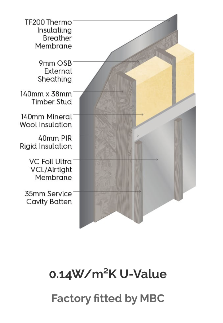

Thorfun Posted March 17, 2021 Share Posted March 17, 2021 agree with @dpmiller and @Russell griffiths. we're simply copying what a lot of the major TF manufacturers do in the factory. here's the MBC example. https://www.mbctimberframe.co.uk/closed-panel-wall-options/ Link to comment Share on other sites More sharing options...

Mike_scotland Posted March 17, 2021 Author Share Posted March 17, 2021 5 hours ago, Russell griffiths said: You still need insulation on the inside to mitigate against the cold bridges through the studs, just fitting 140 between studs does not make a good wall build up. Im sure the mbc diagram i seen doesnt have insulation on the inside? Link to comment Share on other sites More sharing options...
Mike_scotland Posted March 17, 2021 Author Share Posted March 17, 2021 Link to comment Share on other sites More sharing options...
Thorfun Posted March 17, 2021 Share Posted March 17, 2021 14 minutes ago, Mike_scotland said: you're right. that is their 0.18W/m2K wall. if you look at their other walls (0.14 and 0.11) you'll see they do. e.g. all 3 walls are shown on the link I posted. Link to comment Share on other sites More sharing options...
Mike_scotland Posted March 17, 2021 Author Share Posted March 17, 2021 Yeah sorry i dont mean to call amyone out, i just wanted tp make sure my builder not trying a fast one. So would it be worth having 140mm wool inbetween stud then 50mm of pir then cavity batten? I take it this cavity batten is to keep the cold hard off the plasterboard? Do you require one if you have one on the outside? Obviously we have a 50mm cavity after blockwork. Link to comment Share on other sites More sharing options...
Russell griffiths Posted March 17, 2021 Share Posted March 17, 2021 No it’s a service batten to run pipes and cables through. Link to comment Share on other sites More sharing options...
Thorfun Posted March 17, 2021 Share Posted March 17, 2021 2 hours ago, Mike_scotland said: So would it be worth having 140mm wool inbetween stud then 50mm of pir then cavity batten? in my opinion I believe it is as it reduces U-values AND reduces cold bridging. we're going for 80mm to get to around 0.11W/m2K. Also, for us, it's easier to install the mineral wool insulation between the studs and layer the PIR over the top and as we're doing the insulation ourselves this is very important for me! obviously, each person needs to decide what's important for them though! Link to comment Share on other sites More sharing options...
