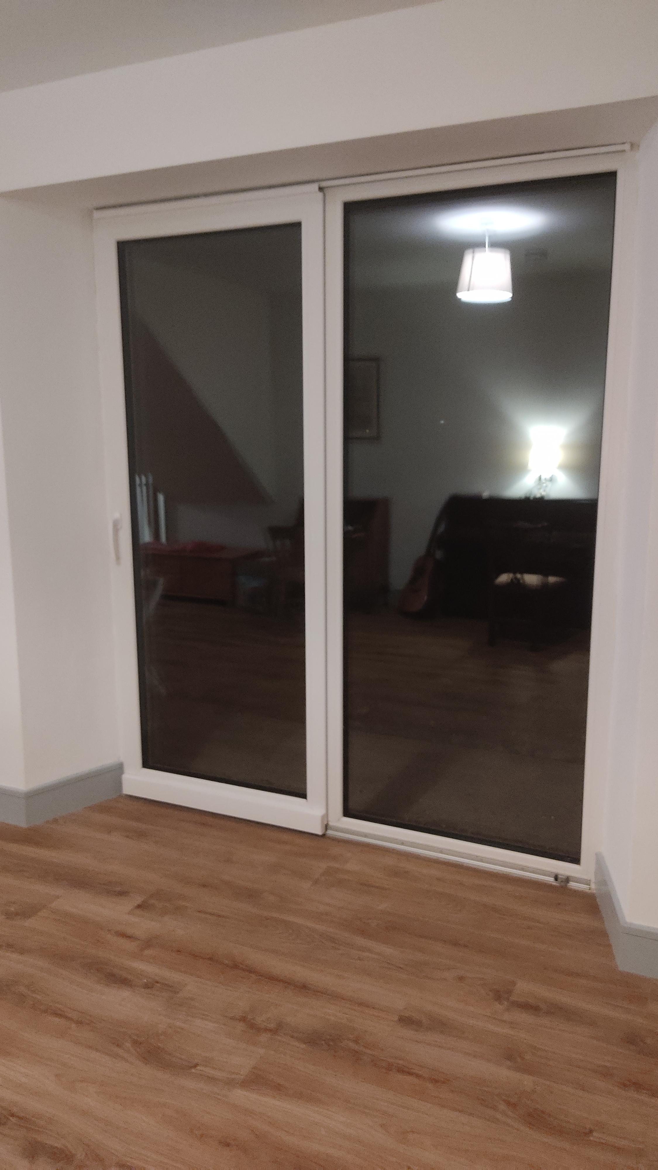

Iceverge Posted March 13, 2021 Posted March 13, 2021 2.0m x 2.4m Veka triple glazed uPVC tilt and slide doors here. Overall U value 0.73 W/m2/k. Good compression seals meant me a 0.3ACH blowerdoor test result. About €3k installed Inc VAT. 1

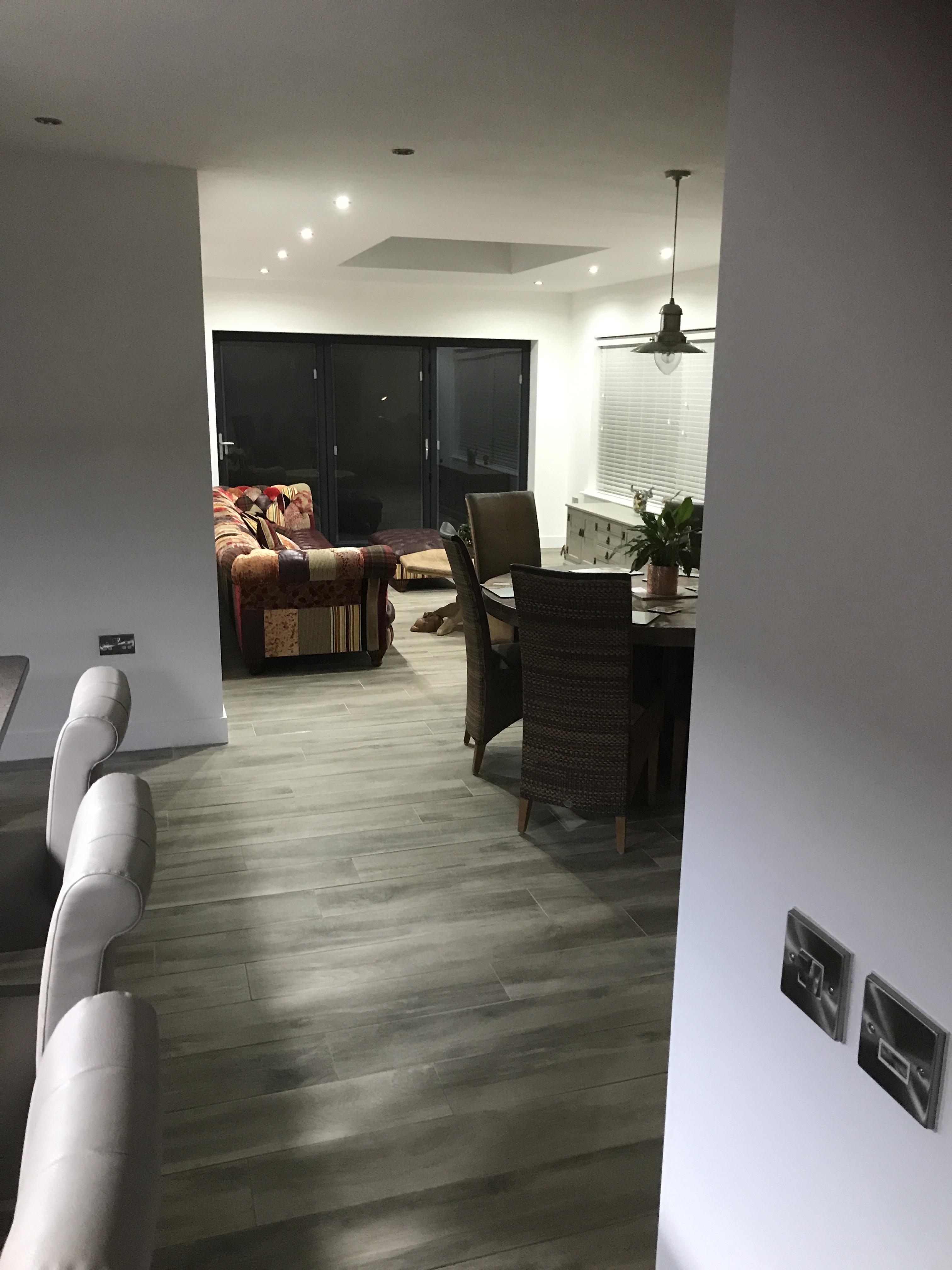

joe90 Posted March 14, 2021 Posted March 14, 2021 My bifolds are between house and a conservatory , great for letting light in floor to ceiling and if the temp is above 20’ in the conservatory they are opened (to the kitchen diner and another to the lounge). I call it my solar collector!!!. In high summer when it’s hot we keep them closed to stop the house overheating, but that’s rare. 1
nod Posted March 14, 2021 Posted March 14, 2021 2 hours ago, Oz07 said: I think French doors are more forgiving if your just using 1 door all the time. Its a lot of expense to have opened up a handful of times but all depends how you live. I've always had French doors in my places and I never seem to open the slave door. We sit either inside or outside Yes To the right of my picture we have a set of French doors Which are used everyday in summer 1
PeterW Posted March 14, 2021 Posted March 14, 2021 (edited) Sliders - at 2.4m you have a good chance of them sealing and can get them triple glazed and they don’t cost the earth. I’ve seen so many sets of bifold doors installed thanks to the glossies that never get used. They are a structural nightmare and on a cost basis when you include everything, at over 3m they become about 4 times the cost of the same glazed area of French doors. We replaced a full sliding wall (6m) from an architects design with 3 sets of French doors for 15% of the price of the bifolds, they are more useable and they seal better !! Edited March 14, 2021 by PeterW Edited out the duplication ..!! More coffee needed ... 3
