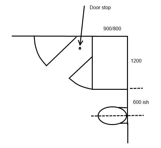

My old man is looking for some help and advice in finishing off bathroom. It’s been like this for 3 years now and my mums had enough.
He is  not sure what would fit best, some sort of quadrant shower or a low profile tray with some sort of screening. Here are a couple of measurements,
from wall to tight to toilet it’s 1.86 m but would want some sort of room between toilet and end of shower.
and from wall to where door opens to is 1.4m.
 Regards James

You have quite a large space.  I would leave at least 50cm from the centre line of the WC to the shower screen. That gives you 1.3m ish for a tray in that direction. I would fit something like  a rectangular 1200 * 800 or 900 mm tray with the door  on the long side. Fit a door stop to the floor to prevent the bathroom door handle damaging the shower. Put the shower controls on the long side wall.
You don't show a waste pipe but if that's low enough you can fit something like 18mm WBP to the joists and a low profile tray on top. I wouldn't go for an ultra low tray unless you are sure the waste pipe can cope with a decent flow rate eg its a short run to the stack.
The position of the waste will depend on the pipe run so don't buy the tray until you know how that looks.

He was hoping to have a low ish profile tray will deffo put door stop in unless door goes on other side?. would a 1200x900 tray work with glass screens and walk in entrance or would water go everywhere?
he is thinking of a ceiling fed shower similar to this. https://www.screwfix.com/p/aqualisa-smart-link-hp-combi-ceiling-fed-chrome-thermostatic-smart-shower/334jk  but not as expensive.
waste is going in the far right hand corner out through ceiling and into utility and in 50 mm soldered pipe washer waste in there he can connect to.

@James94 first question - has that ever been a bathroom ..?? That looks like ordinary chipboard not moisture resistant board so I wouldn’t want it anywhere near a shower. Same with the walls - that is standard plasterboard, so you will need to do some tanking in this area.
What does your mum want in terms of floor finish in there ..?? That will affect floor build up, and also the decision as to how far to recess the shower tray (or not) and what you do next.
Looks like the wall stops the door swinging open and hitting anything so you’ve got options for the shower tray in there - could comfortably get a 1400 x 800 in there similar to this

Onoff, they are a little way off requiring level access, but you never quite now what’s around the corner. He did think about former and wetroom but I think he was a little worried about getting all the levels correct and tanking and tiling.
the reason for a ceiling fed shower is he can fit it him self and not have to have the feed buried in the wall.
pocster,
He’s not bothered about under floor heating, I think he was just going to LVT the whole area, easy for him to do and any issues simple to come up again.
PeterW,
yes when he extended the bathroom this was the chipboard they sent, he told them it was for bathroom, I think he was hoping for the caberdek but to late now(3 years to late) just have to use a lot of silicone around shower area?
walls, he was just thinking of a type of mermaid board adhered to plaster board.
Temp, He will  keep looking on the net to give him some ideas, He does like the look of a larger tray as flush as possible to finish at the choice of floor finish height with some glass around it. I don’t  think he’s looked at many with doors but we live in an area of hard water so will probably have a similar problem with scale.
 Regards. James

Think first thing I would do is work out or measure how high the waste pipe is in relation to the joists when it gets to the shower area with the right fall. That and the height of the trap can dictate the height of the underside of the tray. That in turn may determine or influence how high the tray is and how its fitted. McAlpine do several top access/top fitting traps that work well although some have a better flow rate than others.
Pre Covid I had to replace a tray on a beam and block floor with UFH in screed. The shower screen had already been purchased to suit the old tray and reached from top of the existing tray to the ceiling. Being toughened glass it could not be cut so I had a fun job getting a new deeper tray and trap combination that would end up at the right height to within a few mm. Soon as the tray was bedded on the mortar I stood the glass on top and it was such a perfect fit between tray and ceiling that it stood up on its own.

Temp, the waste will go directly down  through ceiling in the corner into 50mm pipe, see pic. So hopefully He won’t have to worry to much about heights of waste and tray and fall.
TonyT, he did double up the joists when the extension was done so hopefully they’ll be ok. Think he’s going to get some of my roof laths and run them along joist for ply to sit on. I’ll get him to look at the tray you mentioned.
 Regards. James

Not thick enough by a long way ..!! Use tanalised CLS, set below the joists 22mm and then glued and screwed to the joists. Then cut the ply to fit the gaps, glue and screw the ply to the CLS. That forms your deck for the shower tray to sit on and will be bombproof. Tanking would be preferable but LVT doesn’t really sit well on tanking. You could add a 6mm ply all over to strengthen the floor and sandwich a tanking membrane to stop any issues.
I would be cutting the bottom 300mm from the plasterboard all round and replacing with moisture resistant board.
