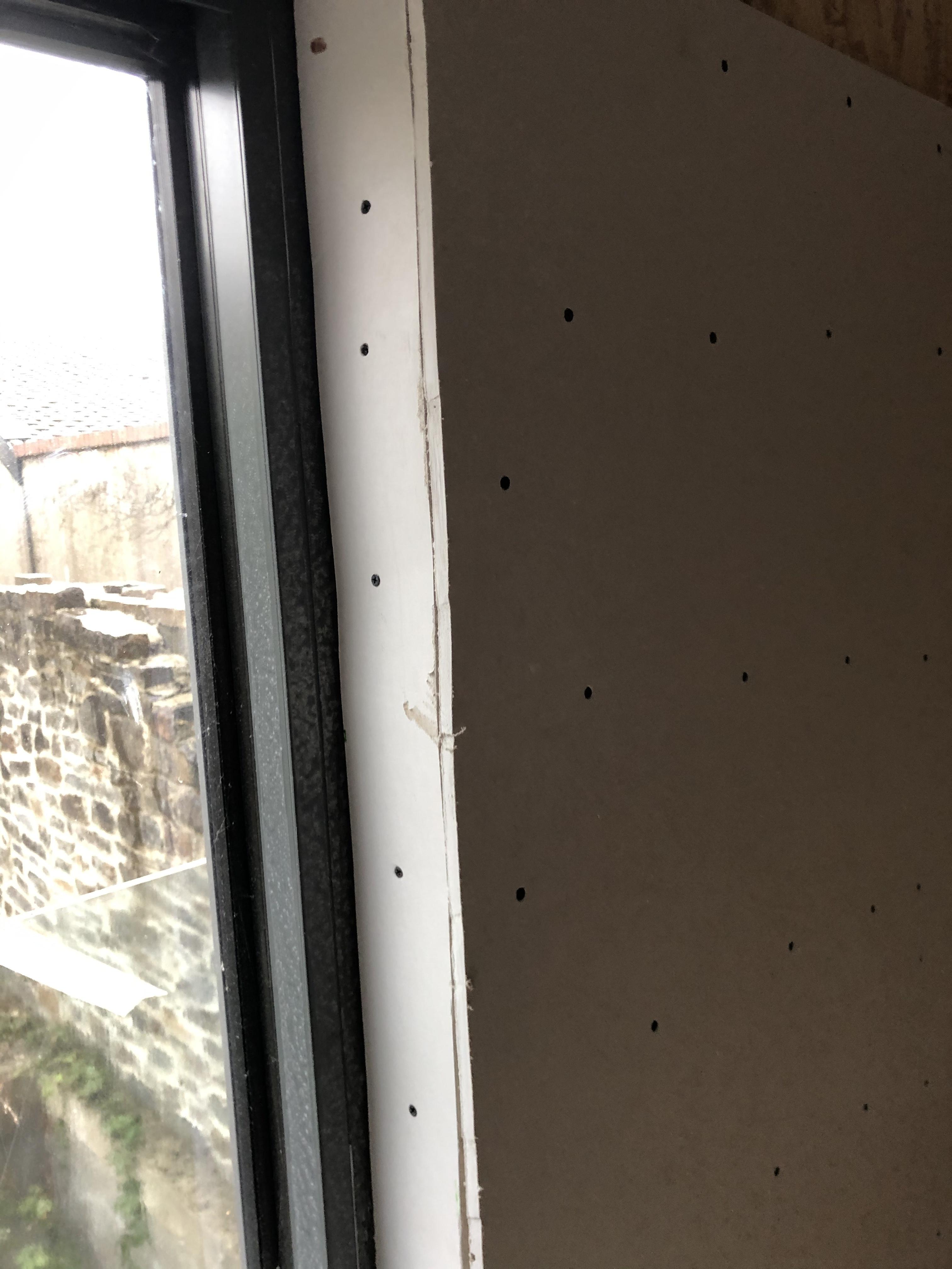

Pocster Posted March 11, 2021 Author Share Posted March 11, 2021 Taking some of the advice on here . I boarded past the corner . Cut it back with a multi tool then a quick file over it . I presume this is better as a supported corner ? Link to comment Share on other sites More sharing options...
TonyT Posted March 11, 2021 Share Posted March 11, 2021 Leave it as it is now, the plasterer will fit an angle bead anyway which will straighten and strengthen the external corner 1 1 Link to comment Share on other sites More sharing options...
Pocster Posted March 11, 2021 Author Share Posted March 11, 2021 12 minutes ago, TonyT said: Leave it as it is now, the plasterer will fit an angle bead anyway which will straighten and strengthen the external corner That was exactly my thinking . Can always change the other external edges if he cries too much ? 1 Link to comment Share on other sites More sharing options...
