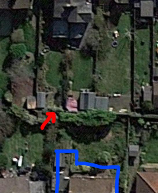

puntloos Posted July 31, 2021 Share Posted July 31, 2021 7 hours ago, Dave Jones said: don't forget your neighbours, how far will it be from neighbouring buildings ? Expensive to rip it out when they complain about the constant noise. The plan is in the far corner of my plot (red, new house in blue) which is an area of a bunch of sheds. Perhaps straight behind the two big sheds might be mildly better but then I Imagine installing the stuff will basically kill most of the laurel hedge (the huge green one) which would be a pity, not to mention I imagine (?) an ASHP will have some trouble 'breathing' in a hedge, and the hedge might even react poorly to the different 'climate' either. 7 hours ago, SteamyTea said: It is usual to have flexible pipes from the monobloc, the manufacturer specifies the length of them. Ah makes sense thx. 7 hours ago, SteamyTea said: This is to stop vibration from travelling along solid pipework. So it is usual to fit them in a service channel/duct. Link to comment Share on other sites More sharing options...
SteamyTea Posted July 31, 2021 Share Posted July 31, 2021 (edited) 2 hours ago, puntloos said: I Imagine installing the stuff will basically kill most of the laurel hedge (the huge green one) which would be a pity, not to mention I imagine (?) an ASHP will have some trouble 'breathing' in a hedge, and the hedge might even react poorly to the different 'climate' either. As long as it is not totally overgrown, and you have a metre and half diameter circle around it, it should not be a problem. Any air that is cooled is soon dispersed, and it only comes out a little bit lower than ambient. I would be more concerned about losses though the pipe runs, as well as electrical losses depending on cable sizing and length. A cubic metre of air has a mass of about 1.25 kg, and a specific heat capacity of around 1 kJ/kg.K, which is 0.0002778 kWh. So if that cubic metre of air is cooled by 5K (or °C), you get 0.00173625 kWh of energy. To get a kWh out of that air, you need to shift 575.95 kg of air, or about 720 cubic metres. Sounds a lot, but is not in reality. About a third of what my car sucks in though the air intake in my car when I am doing 70 MPH. Edited July 31, 2021 by SteamyTea Link to comment Share on other sites More sharing options...
