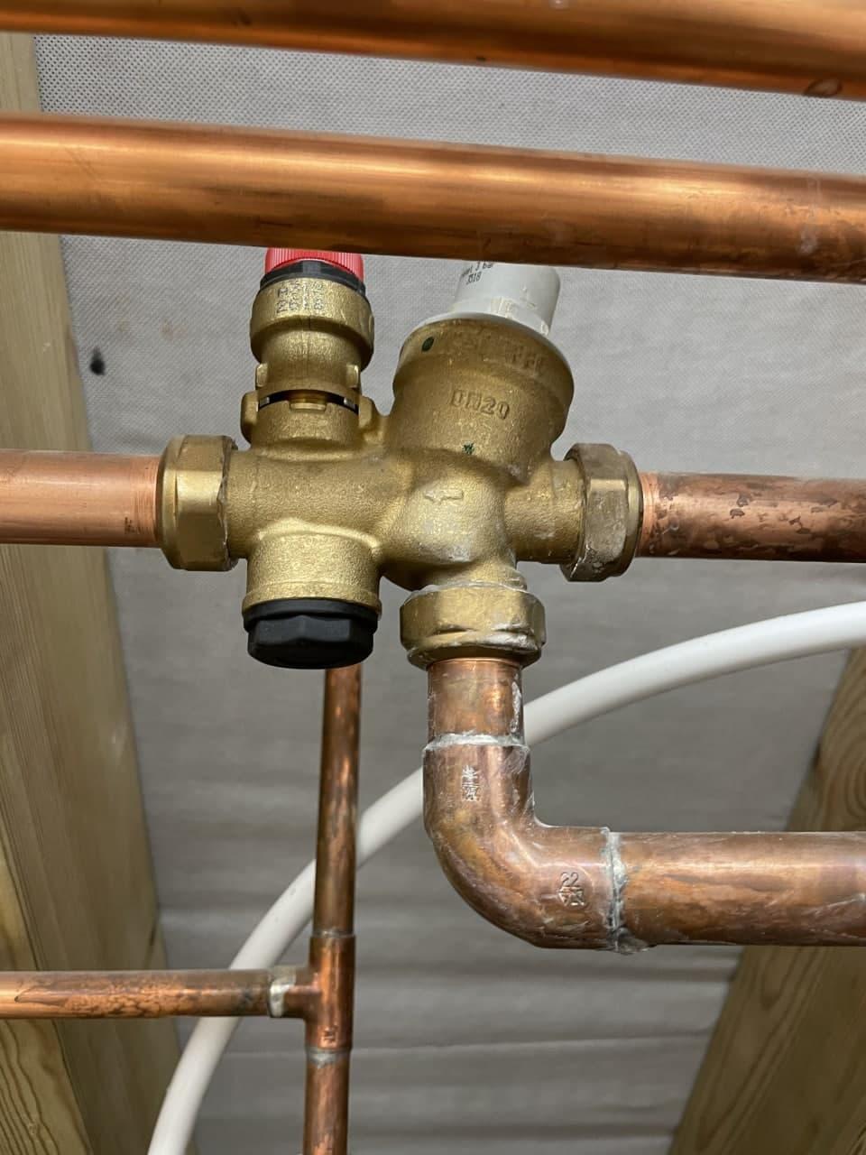

tomcoleman Posted March 5, 2021 Author Posted March 5, 2021 (edited) thanks guys, my PRV doesn't have a pressure hole for some reason so i would need to swap that over to a version that does. attached is my PRV any ideas on what model to replace with ? on the other side is another port which goes off to a mini expansion vessel Edited March 5, 2021 by tomcoleman

Temp Posted March 5, 2021 Posted March 5, 2021 On 05/03/2021 at 08:07, tomcoleman said: thanks guys, my PRV doesn't have a pressure hole for some reason so i would need to swap that over to a version that does. attached is my PRV any ideas on what model to replace with ? on the other side is another port which goes off to a mini expansion vessel Expand Sorry if Im being slow but.. All the pressure regulator/reduction valves I've ever had were two port (eg in and out) . Can you tell us where each of the pipes on yours goes?
ProDave Posted March 5, 2021 Posted March 5, 2021 On 05/03/2021 at 13:50, Temp said: Sorry if Im being slow but.. All the pressure regulator/reduction valves I've ever had were two port (eg in and out) . Can you tell us where each of the pipes on yours goes? Expand That is more than just a simple PRV. Cold raw mains in one side. Pressure reduced out to the HW cylinder the other. The 22mm from the bottom is cold pressure reduced water out to feed the cold taps so they match the pressure of the hot, and the 15mm is the vent from an over pressure relief valve to a drain via a tundish.
