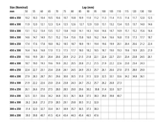

Buzz Posted March 10, 2021 Posted March 10, 2021 Hi @Thorfun found this useful for working out number of slates per m2 required , and what's in budget. 1
Thorfun Posted March 10, 2021 Posted March 10, 2021 1 minute ago, Buzz said: Hi @Thorfun found this useful for working out number of slates per m2 required , and what's in budget. Thanks and could be useful. But then raises the question as to how do you know what lap length do you need?

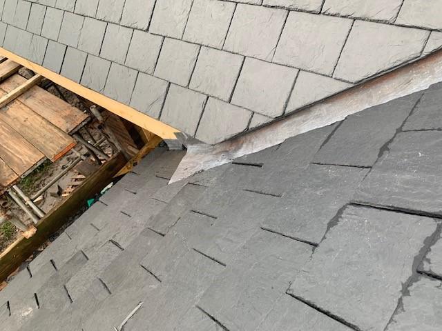

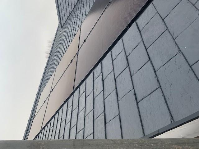

Johnnyt Posted March 10, 2021 Posted March 10, 2021 Just had our roof finished in Matacouta 8-9mm, they are quite dark and were more or less evenly pre-graded. We did not want a flat looking roof and are please with overall look and finish. 1
dnb Posted March 10, 2021 Posted March 10, 2021 I asked my BCO about lap. We discussed the local area weather and how sheltered the site was and settled on a number. I selected 600x300 slates because it meant fewer battens and fewer slates to nail so was cost neutral over the 500x250 slates. The roof is big enough to look right with larger slates. 1
