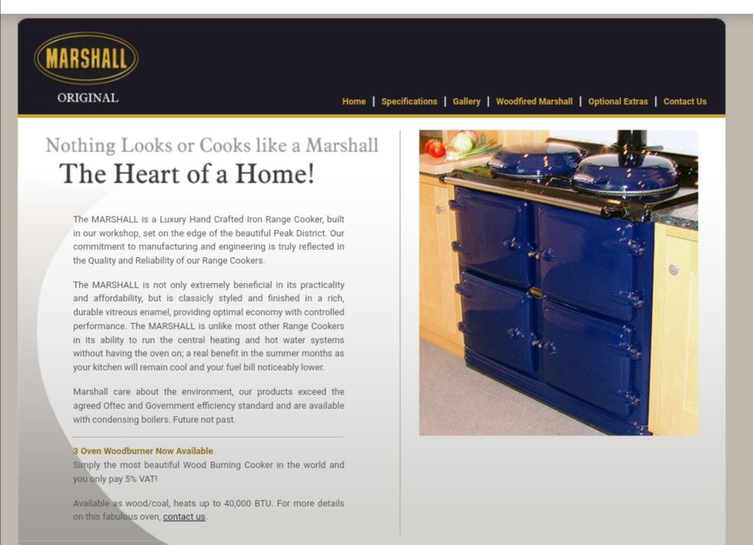

Coops Posted March 1, 2021 Author Share Posted March 1, 2021 Was also considering a product from a company called Marshall, it's a company in Derby that make Aga type cookers that run heating and HW but crucially the oven can be turned on and off instead of it being on 24/7 like an Aga or Rayburn. Link to comment Share on other sites More sharing options...
