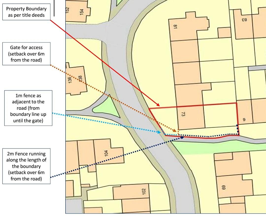

Al1son Posted July 25, 2022 Author Share Posted July 25, 2022 Attached is the proposal 1 Link to comment Share on other sites More sharing options...
ProDave Posted July 25, 2022 Share Posted July 25, 2022 I am suggesting a 1M fence adjacent to the footpath and a 2M fence a short distance in. That won't enclose all of your garden for your use but most of it. but the planners would have a hard time saying the 2M fence is "adjacent" to any highway or footpath. 1 Link to comment Share on other sites More sharing options...
Al1son Posted July 25, 2022 Author Share Posted July 25, 2022 3 minutes ago, ProDave said: I am suggesting a 1M fence adjacent to the footpath and a 2M fence a short distance in. That won't enclose all of your garden for your use but most of it. but the planners would have a hard time saying the 2M fence is "adjacent" to any highway or footpath. @ProDave the 2m fence will be set back over 6m from the front of the road. Link to comment Share on other sites More sharing options...
ProDave Posted July 25, 2022 Share Posted July 25, 2022 4 minutes ago, Al1son said: @ProDave the 2m fence will be set back over 6m from the front of the road. Yes but as I am trying to say (obviously not very clearly) the planners are regarding the path as "the highway" and saying a 2M fence cannot be adjacent to that. So my suggestion is a 1M fence adjacent to the path, which is allowed, and then a 2M fence a short distance back from the footpath so they cannot say it is "adjacent" and fill the gap with some shrubs. 1 1 Link to comment Share on other sites More sharing options...
Al1son Posted July 25, 2022 Author Share Posted July 25, 2022 3 minutes ago, ProDave said: Yes but as I am trying to say (obviously not very clearly) the planners are regarding the path as "the highway" and saying a 2M fence cannot be adjacent to that. So my suggestion is a 1M fence adjacent to the path, which is allowed, and then a 2M fence a short distance back from the footpath so they cannot say it is "adjacent" and fill the gap with some shrubs. Got you, that is an option I could propose as a last resort, so first few metres along the footpath erect 1m and lay down shrubs behind them which will eventually get to the height of 2m and the rest of the length erect a 2m fence Link to comment Share on other sites More sharing options...
ProDave Posted July 25, 2022 Share Posted July 25, 2022 No I will try one more time, don't have time to do a drawing. 1M fence all the way along adjacent to the footpath, that we have established is allowed. Then next to and parallel with that a short distance away from the footpath, a 2M fence all the way. That cannot then be described as "adjacent" Suggestion to fill the gap with shrubs was an alternative to having a little strip of grass to keep mowing. 1 Link to comment Share on other sites More sharing options...
Al1son Posted July 25, 2022 Author Share Posted July 25, 2022 7 minutes ago, ProDave said: No I will try one more time, don't have time to do a drawing. 1M fence all the way along adjacent to the footpath, that we have established is allowed. Then next to and parallel with that a short distance away from the footpath, a 2M fence all the way. That cannot then be described as "adjacent" Suggestion to fill the gap with shrubs was an alternative to having a little strip of grass to keep mowing. If I've understood correctly don't think that work as it will restrict access to the land as it is quite narrow Link to comment Share on other sites More sharing options...

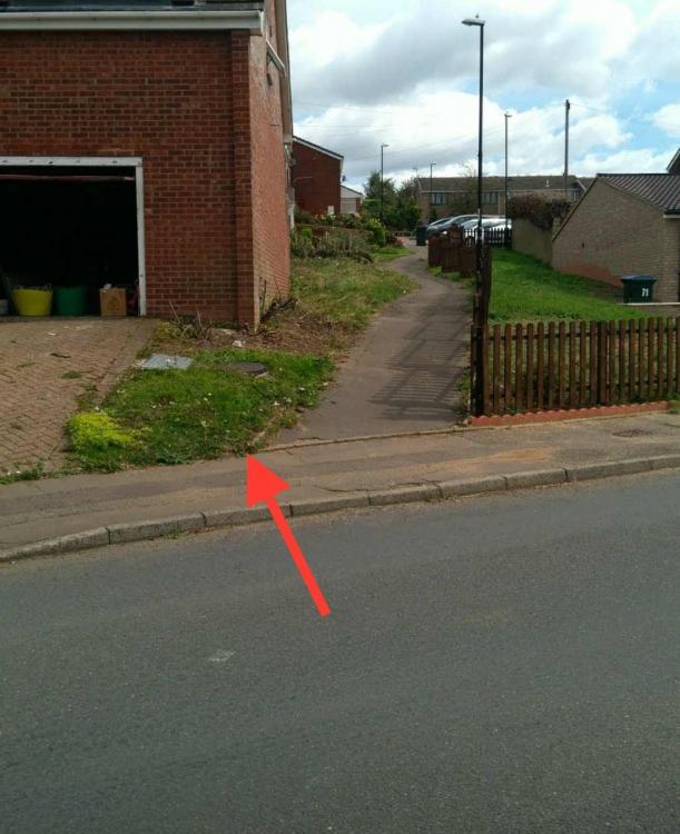

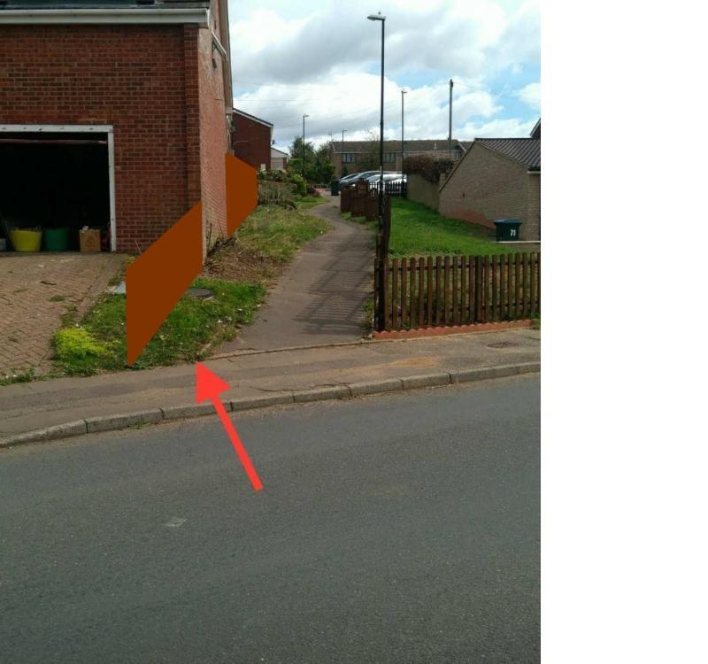

Temp Posted July 25, 2022 Share Posted July 25, 2022 I think at best they would allow a tall fence in line with the wall. Do some photoshop on this view. Link to comment Share on other sites More sharing options...
Al1son Posted July 25, 2022 Author Share Posted July 25, 2022 (edited) @Temp I've uploaded the proposal on the location plan the 2m fence will be set back over 6m from the road which is in line to the wall Edited July 25, 2022 by Al1son Link to comment Share on other sites More sharing options...

Temp Posted July 25, 2022 Share Posted July 25, 2022 40 minutes ago, Al1son said: @Temp I've uploaded the proposal on the location plan the 2m fence will be set back over 6m from the road which is in line to the wall No I mean the other wall like this. Link to comment Share on other sites More sharing options...

Al1son Posted July 25, 2022 Author Share Posted July 25, 2022 12 minutes ago, Temp said: No I mean the other wall like this. 😂 They'll be no land or benefit if I do that! Link to comment Share on other sites More sharing options...

Al1son Posted July 25, 2022 Author Share Posted July 25, 2022 @Temp if we go with what you proposed the width will only be 1m wide vs being 4 to 5m wide We do not intend to incorporate that land into the garden we are just merely looking to enclose the curtilage of our boundary Link to comment Share on other sites More sharing options...
