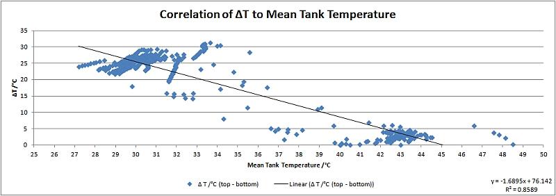

Brian Paul Posted February 28, 2021 Posted February 28, 2021 I am in the process of designing (with architects!) and commissioning a small low-energy house which will rely mainly on solar pv for energy. There is no gas at the property. I have over 15 years experience of solar thermal and solar pv. My current house uses solar pv exclusively for hot water for more than 7 months per year, uses gas for ch & backup hw for colder months. My current 3 immersion design cylinder has proved very effective. I have trawled through various heating and dhw designs including thermal stores and multi-tank solutions but cannot reconcile the different requirements (eg thermal stores need a good temperature gradient to provide dhw - heat pumps provide 55º as a working maximum). I have also noted comments on this forum. (“Hot water and heating are different – keep them separate!”) However I’m still looking for an efficient & effective solution. I am considering using a large unvented cylinder (say 500 litres) which will also act as a buffer for a heat pump and a thermal store for underfloor heating. For at least 8 months of the year the total input would be from solar pv through immersion heaters. For the colder months there would be the possibility of input from a heat pump. Primary heating would be through 3 immersion heaters. I have included a diagram. I see the following as advantages : 1. A single tank with straight-forward plumbing. No complex valves or diversions. 2. Separation of circuits for input/output. Antifreeze needed only in the heat pump circuit. - Better heat transfer to UFH with water than with antifreeze mixture. (and much less of it) 3. Ability to maximise use of solar pv (8kW) throughout the year. 4. Possibility of running as a fully electric system without heat pump - under consideration for at least one year to assess relative costs. Also provides alternative heating if heat pump fails. 5. Typically : we boost heat in the mornings (before 9.00) and in the late afternoon/early evening. Background temperature maintained at other times (although with a good store in the slab this will become less pronounced). Best efficiency from an ASHP will be when the outside temperature is highest and the best use of solar pv will be between 9.00 and 17.00. So having a facility to store heat at these times will maximise both efficiencies. I recognise one potential problem: In our current location, with excessive water hardness, cylinders frequently deposit more than 0.5kg calcium salts per year. We have completely avoided this by quality water softening and would do so in the new location. Although the physical design is simple the efficiency will depend on the control circuits. I propose to design & program these myself rather than rely on the current commercial provisions which seem to be over-complicated but still limit options to those provided by manufacturers. All of the plumbing would be installed by G3 qualified tradespeople. So I would welcome constructive guidance … 1. Is there any commercial system which already follows these lines which I’ve missed? 2. Has anyone on this forum taken a similar line – with what results? 3. Are there any genuine down-sides which I’ve missed?

PeterW Posted February 28, 2021 Posted February 28, 2021 On 28/02/2021 at 09:45, Brian Paul said: Although the physical design is simple the efficiency will depend on the control circuits. I propose to design & program these myself rather than rely on the current commercial provisions which seem to be over-complicated but still limit options to those provided by manufacturers. Expand Ask yourself the question who will maintain this when you can’t ..? A number of members here started down the custom controls track, and some have removed them as the need for such granular control is not necessary. Your issue will be one of stratification in a UVC (or lack of) and where your coils go. Most tank manufacturers will only give you two coils at best that will be enough to get heat in and assuming you use the solar coil, heat out for UFH. A better design would be to mirror in some way what @TerryE has done and use the slab as the “store” for heating and load shift to an overnight tariff. You could if you wanted use a pair of 250 slimline UVCs side by side and use one as DHW but the other as the buffer. Use the UVC coil in the buffer tank as a preheat circuit to your DHW UVC and you’ve pretty much got a standard set up. UFH then would be on the buffer side, and would give you a tank for secondary PV diversion and also you can decide to either use PV, E7 direct, or a small ASHP to heat the tanks. On 28/02/2021 at 09:45, Brian Paul said: Best efficiency from an ASHP will be when the outside temperature is highest Expand That isn’t actually true ...! Best efficiency is when the RH is at its lowest for the temperature. On 28/02/2021 at 09:45, Brian Paul said: Antifreeze needed only in the heat pump circuit. - Better heat transfer to UFH with water than with antifreeze mixture. (and much less of it) Expand Again - not sure where you have got this but a 25% antifreeze mix will be virtually identical for heat transfer at the temperatures you’re talking about. Yes it’s better for having limited volume because it’s cheaper but not much else.

SteamyTea Posted February 28, 2021 Posted February 28, 2021 On 28/02/2021 at 09:57, PeterW said: Your issue will be one of stratification in a UVC (or lack of) and where your coils go Expand Yes, you get 'clumping'. Stratification does not really happen, more a case of a spatial-temporal changing temperature gradient. There is probably good reasons they are not common. 1
