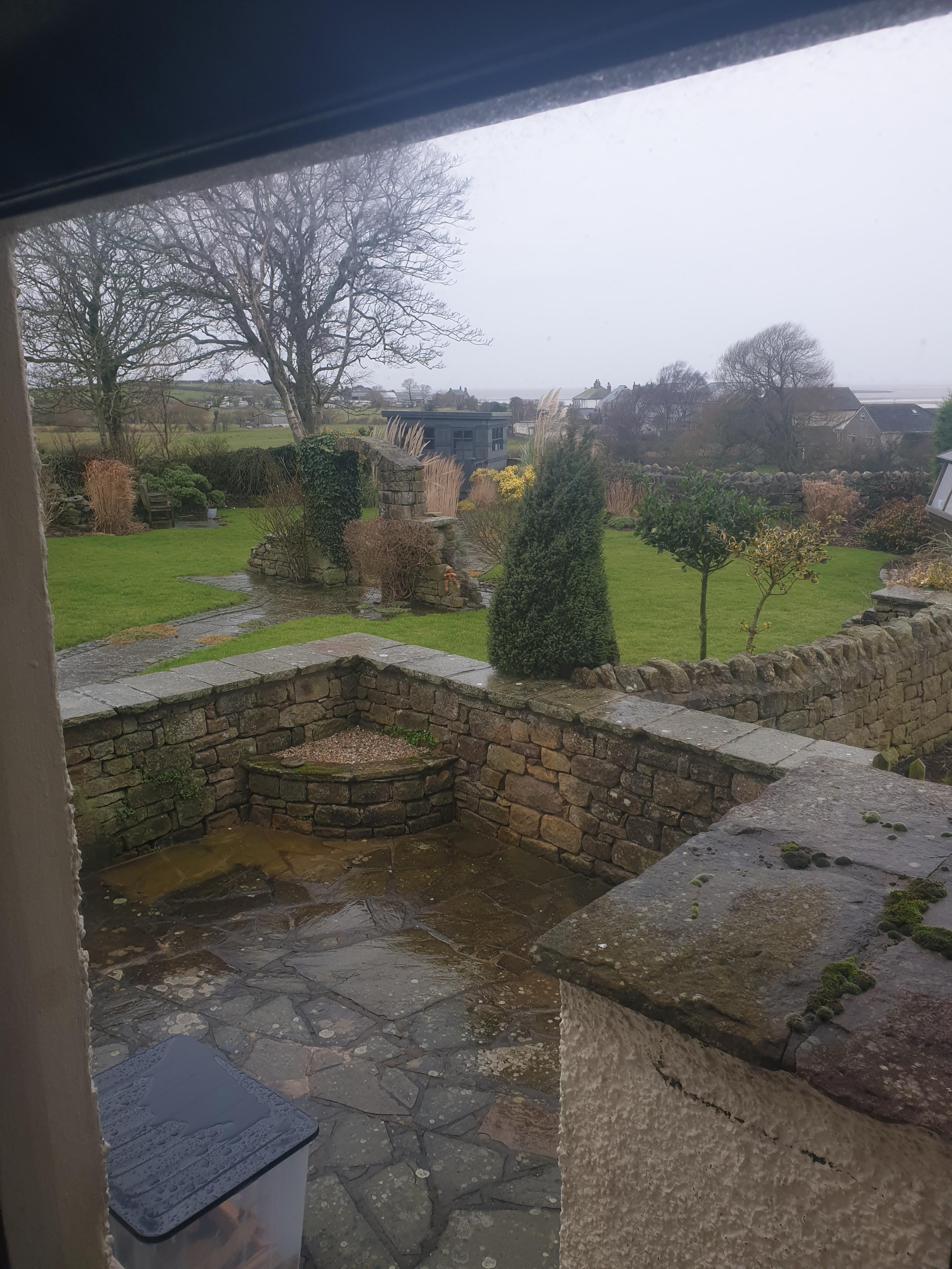

iSelfBuild Posted February 20, 2021 Posted February 20, 2021 I'm just about to build a large garden office and I need to fit a toilet in there. The garden office will be about 35m away from the soil stack and is slightly lower by about 50cm at the garden office location so I can't really get a traditional soil pipe in. I know absolutely nothing about saniflos and reading some conflicting info about what they should be discharged into. Some say 22mm some say 40mm. Ideally I wanted to lay down 35m of 32mm MDPE pipe and then boss this into the soil stack. Has anyone done similar?

iSelfBuild Posted February 20, 2021 Author Posted February 20, 2021 1 minute ago, ProDave said: I think it would, but the trouble is, the pump is in the saniflow, so when it stops pumping, all the "sludge" is still in the pipe and will remain there until the next time it runs. What @joe90 is suggesting is to get all the uphill pumping done very locally from where it can then drain downhill in a conventional drain pipe with rodding access. If you laid a conventional drain at the minimum fall from the house towards the office, how close would it get before it comes out of the ground? If it would get quite close then that with a shorter pumped route from the saniflow might be a better option? If necessary raising the ground level along that hedge to get a conventional pipe closer but still "underground" I'm a bit confused but the ground level of the garden room location is maybe 500mm lower than the patio area where the soil stack is, so to get this to work over 35m would mean a very deep trench in the patio (1m maybe?)
ProDave Posted February 20, 2021 Posted February 20, 2021 How deep is the drain it will connect to at the house? that is the fixed point you have to work back from.

iSelfBuild Posted February 20, 2021 Author Posted February 20, 2021 I'm going to try and put a proper pipe in, found a gully in the drive - which means I can take it straight across the back of the garden - hopefully the gully goes into the main sewer as I expect it's a shared grey and waste water situation - I'll have to test with food die and take some levels but should work OK. Thanks everyone for the advice. 1
