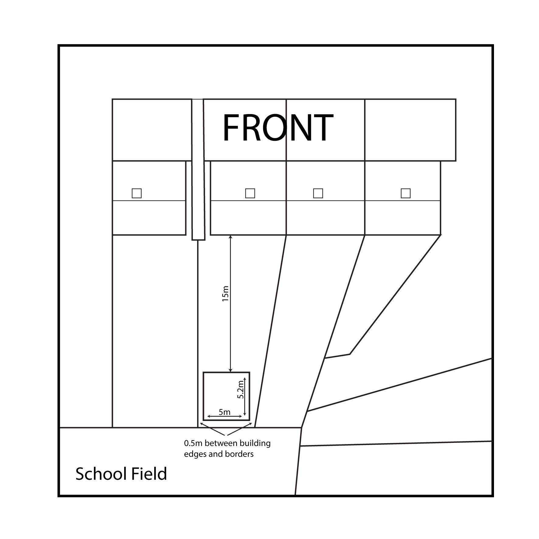

mazzlebizzle Posted February 17, 2021 Share Posted February 17, 2021 Hi Folks, My first post here. I have so far put down an elevated concrete pad (30cm high) and have also built the walls out of solid dense 7.3N concrete blocks.Aas it stands the height of the highest block is 2.73m high including the concrete pad height (front of build). The problem is once the single-pitched roof is on the building height will be roughly 3.10m high. I have since been doing some digging and it seems the building may be too high? I have attached an image below so you can see the plan. I know people who have buildings just as high and some higher! that actually touch the boundaries of their neighbours and have been passed by the local council (Norwich, UK). So I'm confused as to what is ACTUALLY permissible and what's not, given the information online and the contradictory reality. Can somebody help? Also is there anything else I need to think about given the size of the building. Thanks Link to comment Share on other sites More sharing options...
Olf Posted February 17, 2021 Share Posted February 17, 2021 https://www.planningportal.co.uk/info/200130/common_projects/43/outbuildings Outbuildings are considered to be permitted development, not needing planning permission, subject to the following limits and conditions: Maximum height of 2.5 metres in the case of a building, enclosure or container within two metres of a boundary of the curtilage of the dwellinghouse This is UK wide law, you are at breach of it I'm afraid. Check if you can apply for a retrospective planning permission - even if positive, due to proximity to the boundary (< 1 m) you'll be limited as to what roof materials can be used to comply with ' constructed substantially of non-combustible materials ' rule. 1 Link to comment Share on other sites More sharing options...

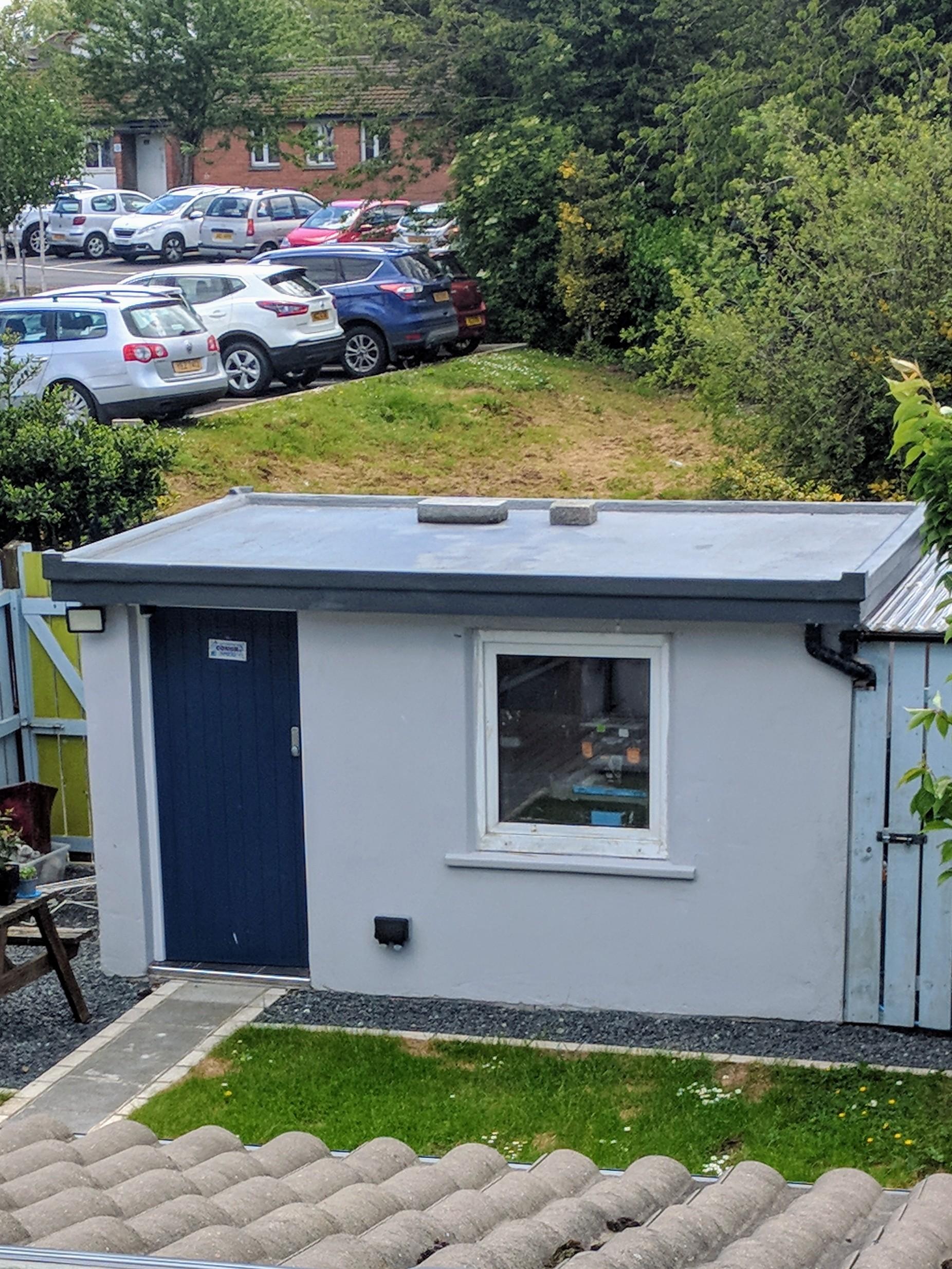

mazzlebizzle Posted February 19, 2021 Author Share Posted February 19, 2021 Thank you all for your suggestions. So to confirm we are going to take a whole block off the top at the front so all four sides are the same height. Then a wooden wall plate placed on top. The 150mm rafters will have a 25mm birdmouth cut into them. The flat roof will be made of rafters and hangers, osb, PIR insulation, osb and then EPDM on top. I believe theres a vapour barrier in there too. After the floor has been built up there'll be a clearance of round 2.2m. By the time its all installed it'll be at around the 2.7m mark HOWEVER I will be ordering a few ton of top soil and build the ground up to the pad as my garden does have high/low points and so at least one side of the building will be 2.5 high or maybe shorter and the other 2.7 max. The ground level will be level with bottom fence one side and slow down to 2.7 the other. That'll be ok now right? Square footage shouldnt matter as long as the dimensions are within permissable guidelines and all materials are non-combustable? The walls will be studded and insulated then plaster board and plaster. Electric will be fed up there using a buried armoured cable etc Anything else I'm missing? Link to comment Share on other sites More sharing options...
