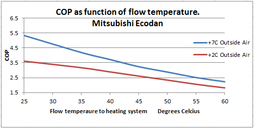

Temp Posted March 2, 2021 Posted March 2, 2021 Just for info here is another COP vs flow temperature graph.. Source: https://heatpumps.co.uk/2014/03/06/getting-the-best-from-underfloor-heating/
CallMeMeryl Posted March 2, 2021 Posted March 2, 2021 On 02/03/2021 at 12:57, Temp said: COP vs flow temperature graph Expand Aah, OK I think the penny has dropped. So a bit like thrashing my car 0-60 in 3 seconds uses more fuel than if I slowly accelerate at a reasonable pace? Thank you
SteamyTea Posted March 2, 2021 Posted March 2, 2021 On 02/03/2021 at 13:03, CallMeMeryl said: Aah, OK I think the penny has dropped. So a bit like thrashing my car 0-60 in 3 seconds uses more fuel than if I slowly accelerate at a reasonable pace? Thank you Expand Or more a case of driving at 50MPH instead of 90MPH. The air resistance goes up with the square of the speed. (Velocity and Speed are different)
CallMeMeryl Posted March 2, 2021 Posted March 2, 2021 On 02/03/2021 at 13:07, SteamyTea said: Or more a case of driving at 50MPH instead of 90MPH. The air resistance goes up with the square of the speed. (Velocity and Speed are different) Expand got it
