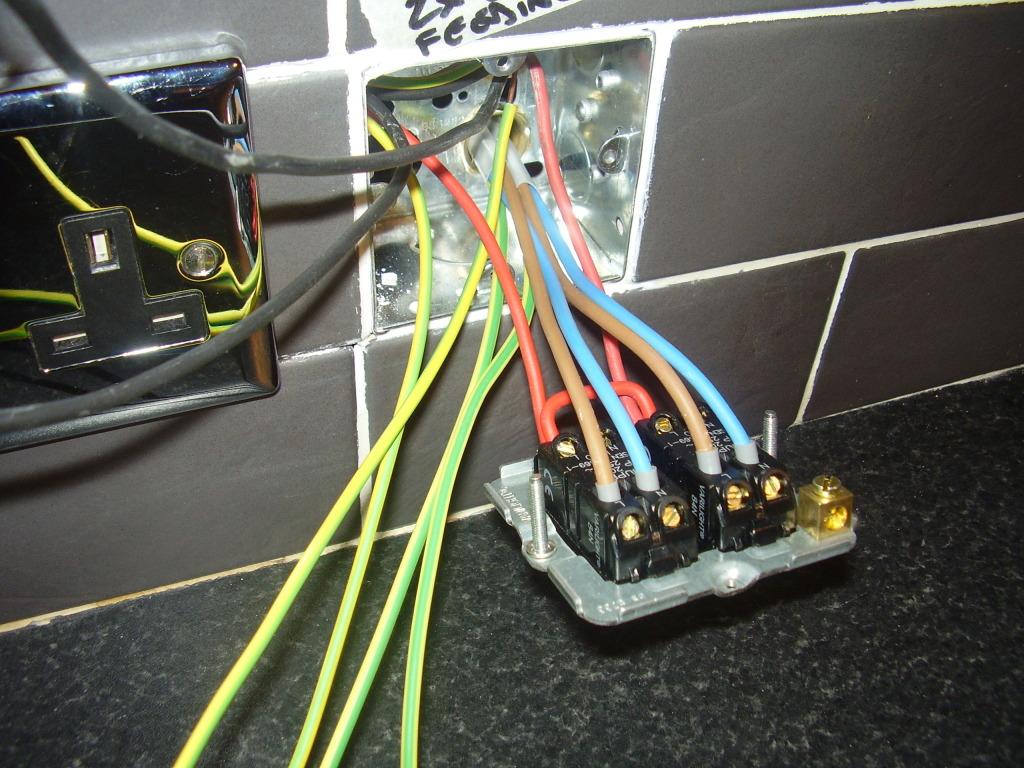

3 hours ago, Onoff said:
I was looking for a photo of grid switch wiring but this was all i could find:
What's the maximum load on a grid switch though. I'm guessing more powerful ovens and hobs can't be isolated via this sort of grid?
Generally 20a
But you can get larger, but it's going to take up more ways, and not really practical,
I'd have to check if a contactor could be used for isolation, but I doubt it.
