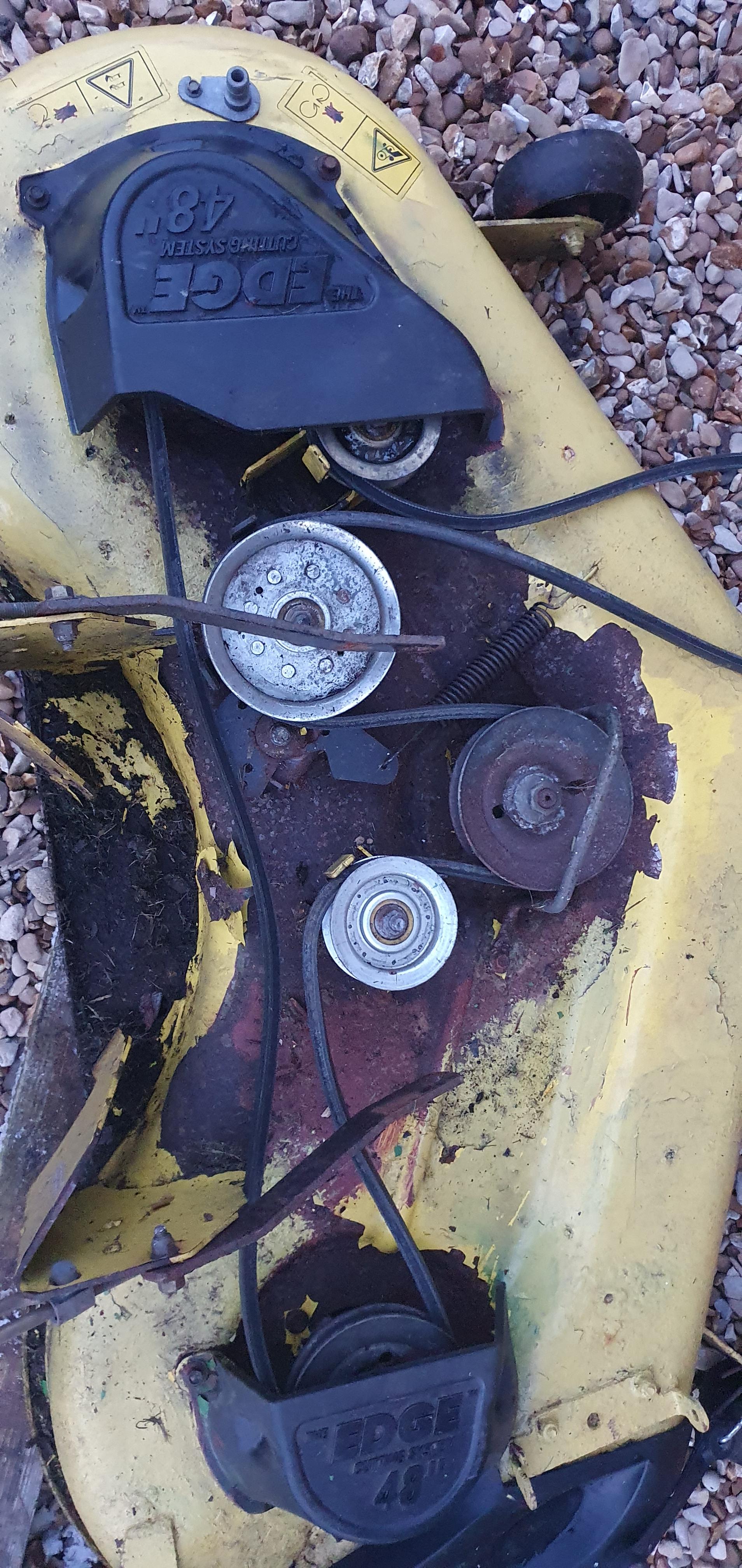

Roundtuit Posted February 14, 2021 Posted February 14, 2021 In anticipation of getting chance to grow some grass to cut this year, I've taken a bit of an off-season punt on a ride-on mower on ebay. Mechanically, its looking pretty good and seems fairly solid, but the paintwork is poor and going need some work. So, starting with the deck, top and bottom - with a good wire-brushing prep only - any recommendations for a bullet proof paint please?
joe90 Posted February 14, 2021 Posted February 14, 2021 I really rate hammerite fir this kind of work, I actually found the right colour fir my deck when I refurbed it like you are. Direct to rust, no undercoat ? 1
joe90 Posted February 14, 2021 Posted February 14, 2021 (edited) From someone I know who deals with these, most are scrapped because of rusted decks, such a shame when they can be saved with a little work. His top tip is to clean the deck underneath with a pressure washer regularly, stops grass building up like a poultice and breeding rust. Edited February 14, 2021 by joe90

Onoff Posted February 14, 2021 Posted February 14, 2021 Just now, Roundtuit said: @OnoffYes, read the thread (with admiration!,) but could only find reference to 'zinc rich' paint I think; us amateurs need a bit more of a steer! It's a John Deere, 22hp B&S engine, 48inch deck. 2009 model, but only 220 hours on the clock, if the clock works... Steering is a bit sloppy, and paintwork is $h!te (must have lived outside for an extended period), but looks like it will cut grass! ? As others have said keeping them clean is key. I push ours on it's side and hose it off periodically. You can buy or make a stand that you drive onto then jack it up. This is typical: https://www.amazon.co.uk/Lifter-Lifting-Device-Garden-Tractor/dp/B00OV5JKLK I think I used Pro-Cote Cold Galv Spray from T'station (quite a fan of it). Also Simoniz Tough Black spray paint. I got a couple of cans of "orange" top coat from Halfords, it was a country mile off of the original Westwood colour! ? There's a lawnmower forum when you're ready... 1

dnb Posted February 15, 2021 Posted February 15, 2021 Those black scouring pad looking things in a grinder are excellent for removing rust and scale. Then my choice would be to paint with a couple of coats of POR15 and something like Jotomastic (another epoxy mastic paint) on the inside and whatever colour you want outside over the POR15. (The POR15 is not UV stable so needs something to cover it.) 1

Roundtuit Posted February 15, 2021 Author Posted February 15, 2021 17 hours ago, SuperJohnG said: Come on pictures..... Haven't taken many yet, but this is the top side of the deck photographed for reference before I started taking too many bits off it. It's had some sort of poor tarting-up paint job on areas previously, but seems solid enough.
ProDave Posted February 15, 2021 Posted February 15, 2021 Why can't they make ride on mowers with plastic cutting decks? Our present push along mower is all plastic, hoping this time it might be the engine breaking down that kills it not the deck rusting out.
Roundtuit Posted February 15, 2021 Author Posted February 15, 2021 15 minutes ago, joe90 said: That’s not bad, what’s the underside like? Still waiting to be power-washed to find out! ? 1
