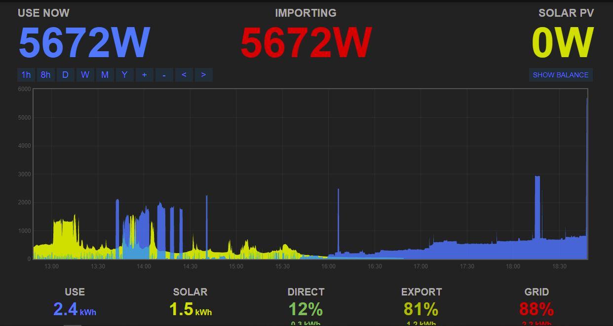

Bramco Posted February 9, 2021 Posted February 9, 2021 If you want more detail and some history get an emonPi from the open energy crew in Wales - great kit. You can set up as many dashboards as you want and also measure temperatures. https://shop.openenergymonitor.com/emonpi/ I should add I'm nothing to do with them, except from being a member of the forum there. It's all open source, so we set up our own system on a spare Rasp Pi and also built a Solar PV diverter following guides. There's a huge amount of info on the forum. Simon 1 1

Bramco Posted February 9, 2021 Posted February 9, 2021 (edited) An emonPi would give you more granularity and the possibility of tailoring it to your requirements, but hey, it's horses for courses. There are many ways to do this - was just suggesting one we've found very useful. For example Simon Edited February 9, 2021 by Bramco

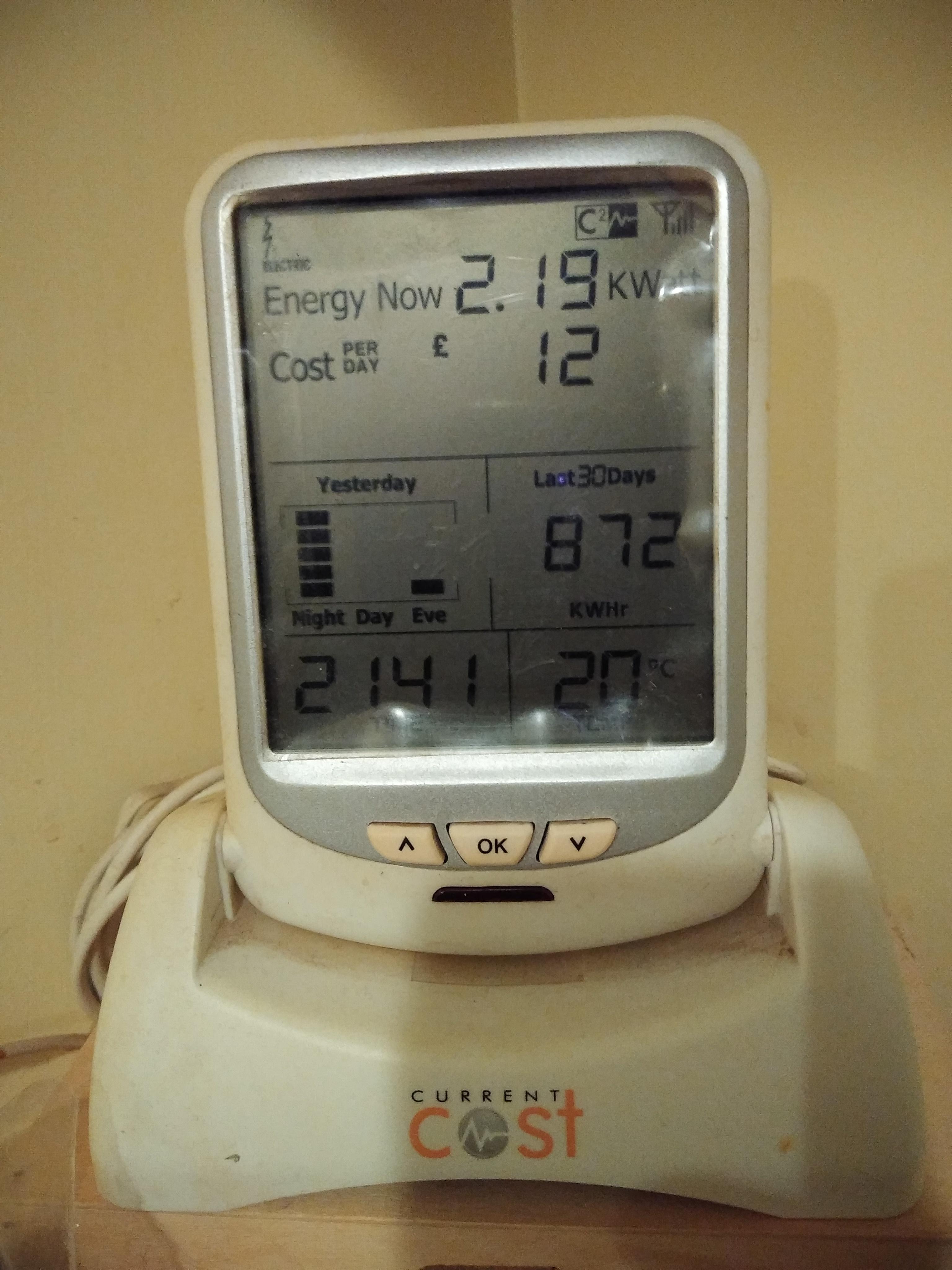

SteamyTea Posted February 9, 2021 Posted February 9, 2021 Here is a picture of my CurrentCost monitor. What you cannot see us the little Raspberry Pi Zero in the box it is sitting on. All the RPi does is collect all the data for later analysis in Excel. Very simple and reliable.
Bramco Posted February 10, 2021 Posted February 10, 2021 19 hours ago, canalsiderenovation said: You lost me at Rasp Pi I didn't say Rasp Pi - I said emonPi. It has a Pi in it with everything set up. Simon
