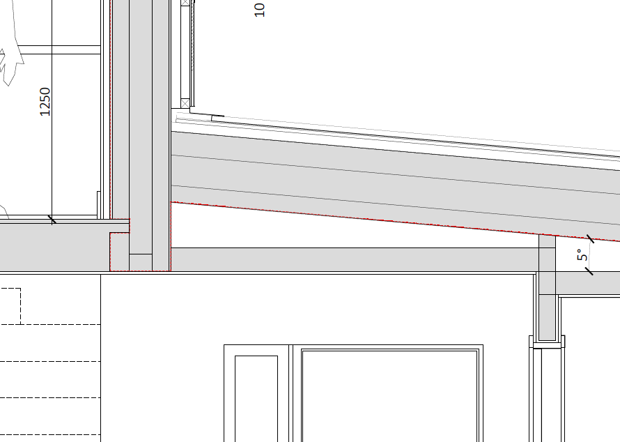

Hi,
We are getting conflicting advice so any thoughts that might help us get through this very much appreciated.
We are building a 4m deep x11m long single story extension on the back of our house, mono-pitched roof joined to the exiting house. Due to the lay of the land and upper story windows we are limited for height at the back/house side (3m) and still want to achieve a fall above 5 degrees.
There are two questions this raises.
1. One installer recommended a vented or cold roof zinc installation (something to do with moisture trapped during installation of the zinc) where as our design/architect guy recommended a warm roof i.e. unvented. Has anyone got views on which is better and/or any advantages of each?
2. If we were to go down the vented route. I have been unable to see how the back/house side of the venting would work and upstand for that matter. I have seen venting details on roof ridges. Has anyone got any experience of how that might work?
Again any help much appreciated.
Thanks
Graeme

I have a cold roof ventilated at the eaves and abutment wall, a warm roof will be 175mm approx higher than a cold roof as the insulation goes on the top, my ceiling height is 75mm lower than a warm roof as I have insulation under my roof rafters.
So you need to draw draw it out and work out the dimensions you have to play with. 62F6584B-6ABB-42D7-8A3C-1722E9C7C151.thumb.jpeg.5160186706adea21ebc91ab7ffe0d162.jpeg

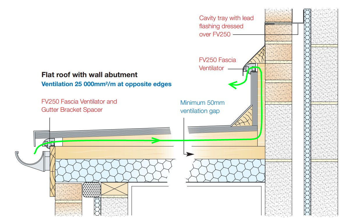

cold roof ventilation detail at abutment.

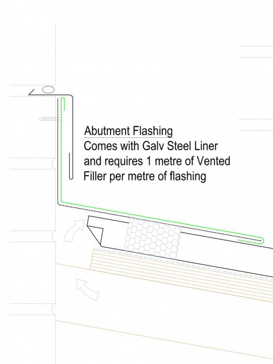

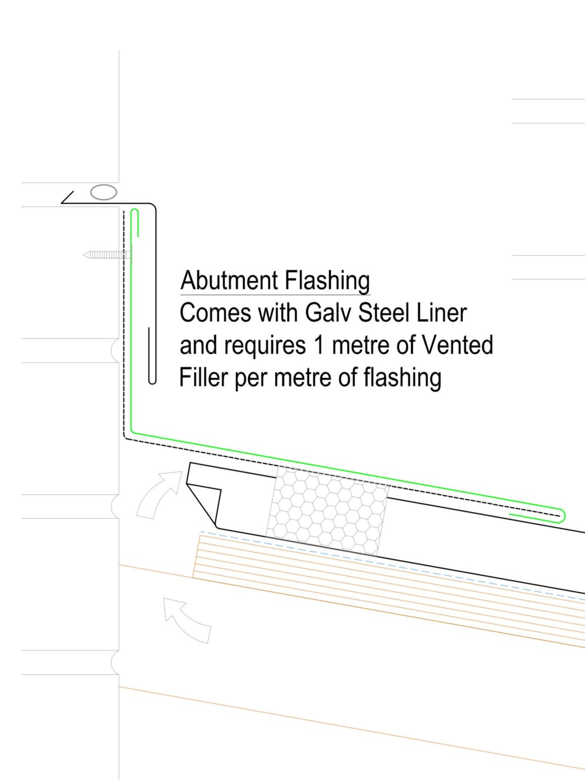

Not sure I completely understand the diagram..sorry, but let me see if I can get this right.....I see the flashing bit. Does that sit on top of the standing seam? with vented filler in between seams. Then beneath the zinc is vapour control on a bed of ply? Batten on top of the rafter where the bottom arrow shows airflow coming up?
I've attached a pdf diagram what one installer has recommended.Zink roof detail.pdf
Roughly how high/tall does that upstand/abutment flashing have to be?

Flashing sits on top and goes up the wall 150mm, I think this height has something to do with rain bounce, any lower and rain can bounce above this height and get behind the flashing, I believe this is a very old regulation and might be a bit more relaxed now, check with building control.
Inbetween the pans and the upstands of the sheets is a foam filler, it has sticky tape on one side, it prevents insects getting in and rain being blown up, but allows airflow.
I have seen other makes that consisted of a perforated metal trim that you stuck down with sealant and the flashing went over the top.

Google for roof abutment vent.   If your zinc is going to have a profile then the supplier may also have a matching abutment vent.
On regular pitch roofs the abutment vents sometimes just lift the flashing up a bit so air can get out from under it.
On flat or shallow roof pitches there is an upstand that lets air go up between it and the wall then down and out from under the top flashing. If you are pushed for height under a window you will have to find a shallow solution (reduced upstand).
Image borrowed from here: http://www.glidevale.com/article/70/faq-how-do-i-ventilate-a-cold-flat-roof-and-which-product-do-i-use

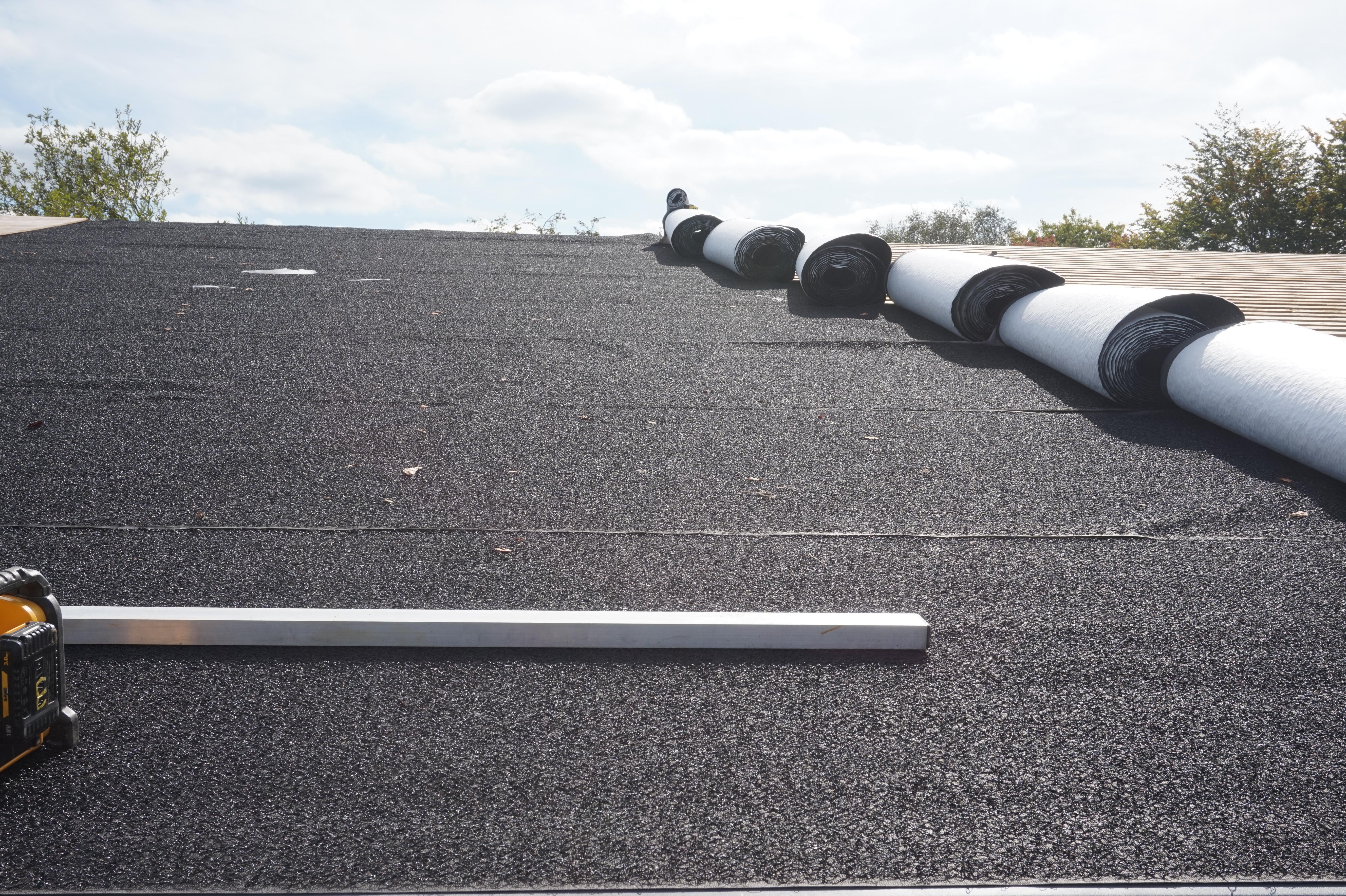

I wasn’t to keen on any of the designed systems so included the eye watering cost of one of those fancy membranes with the plastic fibres all over them to allow condensation to drain away. FF80A2F2-A346-4595-9B00-FCBEFF6109CE.thumb.jpeg.70f1a4d474fc4be9fde192d53a2da31a.jpeg
That's funny stuff, for a moment I thought it was just bitument felt with a fleece backing! Looks like your roof was the size of a football pitch ?

When I put mine on I had sheets just sat on the roof not fixed, you would think that the temperature was the same on the top of the sheet and the underneath, so how come when you pick a sheet up the underside is dripping in condensation, it can only be 1-2 degrees warmer on the underside.
We have used the membrane with scouring pad / pubic hair topping like @Russell griffiths used.  I think it means that you don't get a puddle of condensation directly on the zinc.  I think the risk is reduced with some of the zincs with pre-patinated finish.
I'm sure it does prevent pooling and build up of condensation against the zinc and as it lets it run off the roof it's got to be a good thing. The membrane I recieved with my coated steel has a fleecy backing to it but more normal fibre weave on the top.
