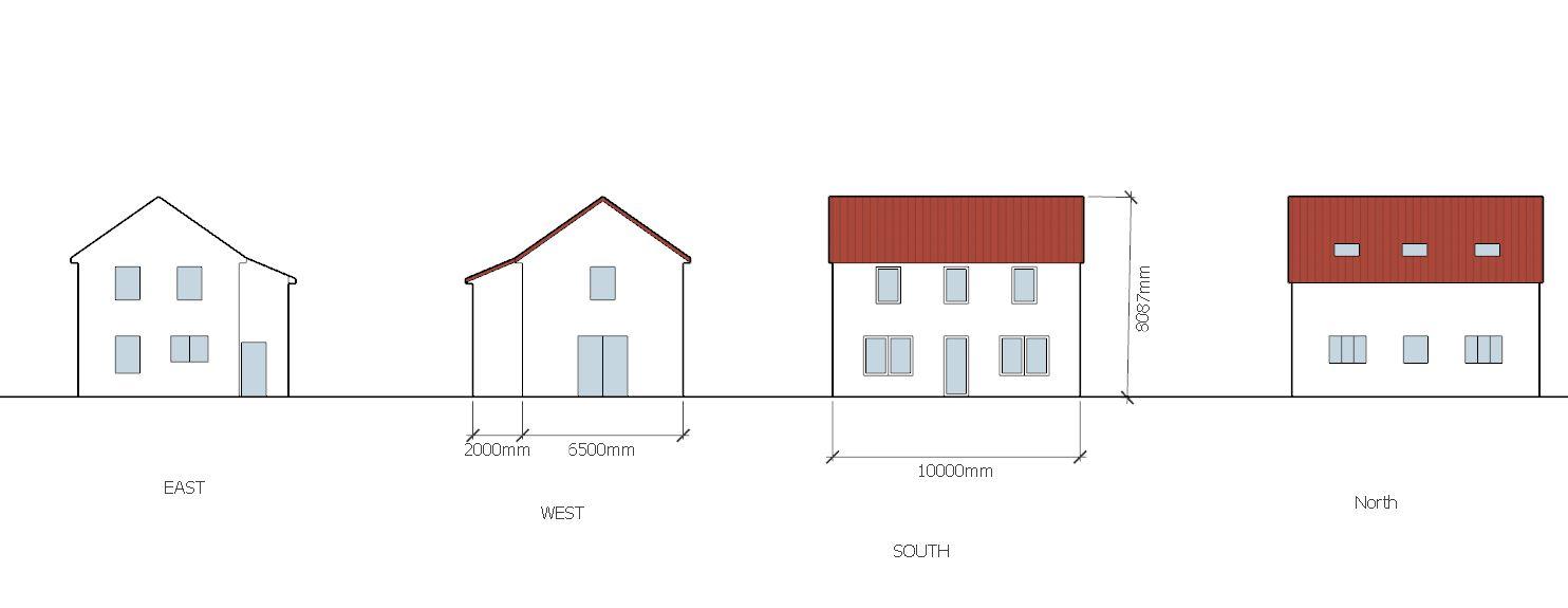

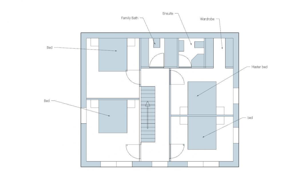

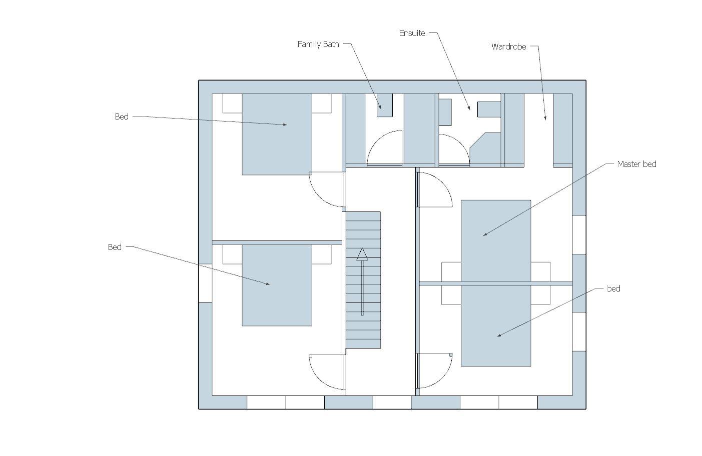

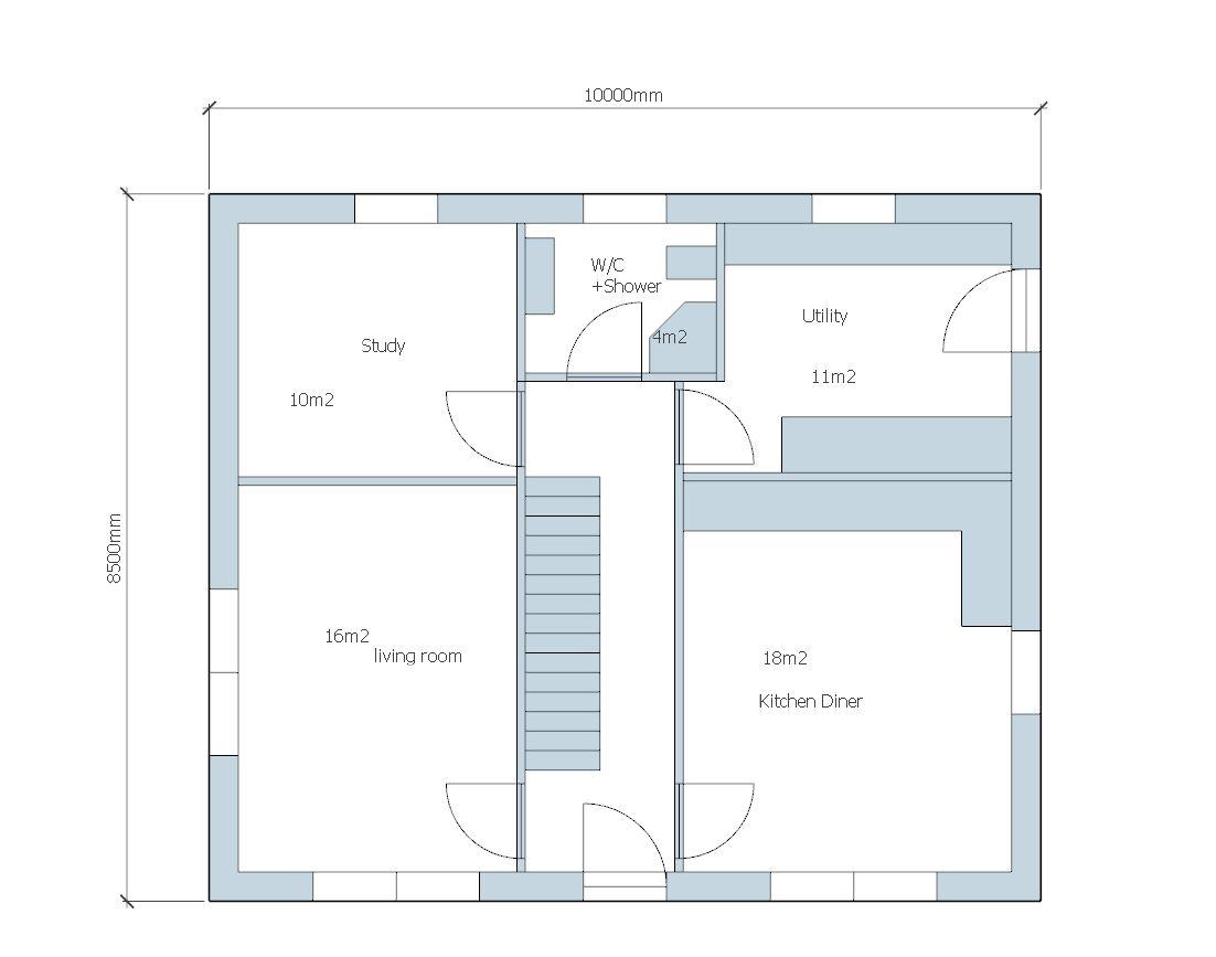

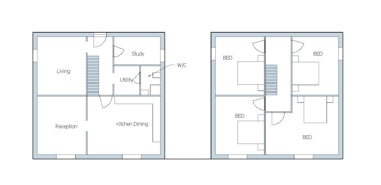

Iceverge Posted February 10, 2021 Share Posted February 10, 2021 This design is 145m2. It's unlikely you actually need 180m2. 350mm cavity wall. 2650mm ceilings downstairs and 2400mm upstairs. It allows for 4 beds, 1 ensuite, Walk in wardrobe, entrance hall, generous Utility, kitchen diner, large living room, study, family bathroom and a ground floor shower and W/C. I think unless a very large family demands it you could loose the study, a bedroom, the walk in wardrobe, the ensuite and make the living room smaller. Link to comment Share on other sites More sharing options...

Amateur bob Posted February 10, 2021 Share Posted February 10, 2021 2 hours ago, Iceverge said: This design is 145m2. It's unlikely you actually need 180m2. 350mm cavity wall. 2650mm ceilings downstairs and 2400mm upstairs. It allows for 4 beds, 1 ensuite, Walk in wardrobe, entrance hall, generous Utility, kitchen diner, large living room, study, family bathroom and a ground floor shower and W/C. I think unless a very large family demands it you could loose the study, a bedroom, the walk in wardrobe, the ensuite and make the living room smaller. its a similar design to that i was thinking of, how much do u reckon that could be built for with me organising the tradesman? Link to comment Share on other sites More sharing options...

Iceverge Posted February 10, 2021 Share Posted February 10, 2021 3 hours ago, Amateur bob said: its a similar design to that i was thinking of, how much do u reckon that could be built for with me organising the tradesman? £215,000 Smaller houses are more expensive per m2. The only houses I've seen built to mega low prices per m2 have been enormous >300m2 or have been terribly finished or have had huge amounts of unpaid labour by the owner. Often a combination of all 3. A better place to start with is your budget and needs both now and the future. 1 Link to comment Share on other sites More sharing options...

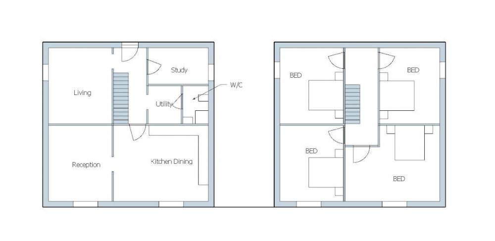

Roger440 Posted February 10, 2021 Share Posted February 10, 2021 10 hours ago, Iceverge said: @Amateur bob This is quick impression of what it could look like. Not pretty but it's a house. Footprint 10.4x10m 4 very large bedrooms, 1 toilet/shower. 2 receptions and a study. Large kitchen. Utility. Apart from reducing the size from your 180m2 I can't see anywhere else obvious to reduce costs. You have been to milton keynes then? These already exist. Though in fairness, they date from the 80's rather than being new. 1 Link to comment Share on other sites More sharing options...
Big Jimbo Posted February 10, 2021 Share Posted February 10, 2021 3 minutes ago, Roger440 said: You have been to milton keynes then? These already exist. Though in fairness, they date from the 80's rather than being new. You must be talking about the "Lakes Estate". That place looks grim. Link to comment Share on other sites More sharing options...
Roger440 Posted February 10, 2021 Share Posted February 10, 2021 1 minute ago, Big Jimbo said: You must be talking about the "Lakes Estate". That place looks grim. It is grim. There are others too. 1 Link to comment Share on other sites More sharing options...
Iceverge Posted February 10, 2021 Share Posted February 10, 2021 1 hour ago, Roger440 said: You have been to milton keynes then? These already exist. Though in fairness, they date from the 80's rather than being new. Good grief. i just looked it up. Someone actually went and did it. Still though, you can’t just blame houses for all of society’s woes. It could have been lovely. 1 Link to comment Share on other sites More sharing options...
