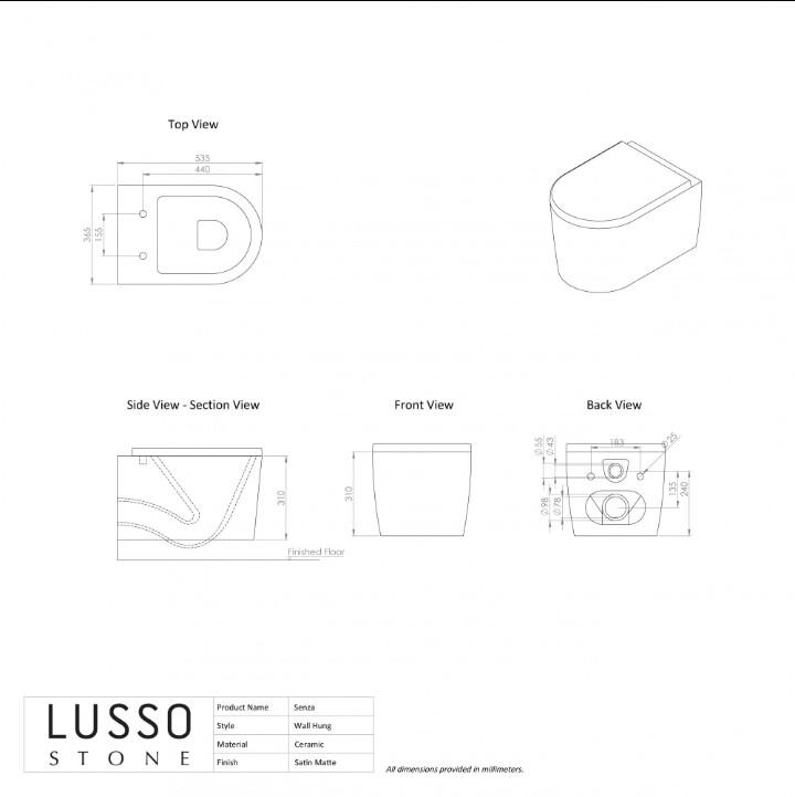

Russdl Posted January 30, 2021 Share Posted January 30, 2021 The instructions for my wall hung toilet are brief. There is no mention of applying mastic between the bowl and the wall. I’m sure I should, shouldn’t I? Top and sides? Guidance appreciated. Link to comment Share on other sites More sharing options...
PeterW Posted January 30, 2021 Share Posted January 30, 2021 What frame ..? And did it come with a gasket..? If not, decent bed of CT1 and then use a replaceable silicone all round the rest of the pan when that has gone off. If there is no gap under the pan then use a 2mm packer wrapped in cling film to make a gap at the bottom of the pan /CT1 so any leaks in the future are visible. 1 Link to comment Share on other sites More sharing options...
Russdl Posted January 30, 2021 Author Share Posted January 30, 2021 The frame is a Geberit Duofix. No gasket. The toilet bowl is Lusso, vague instructions. Link to comment Share on other sites More sharing options...

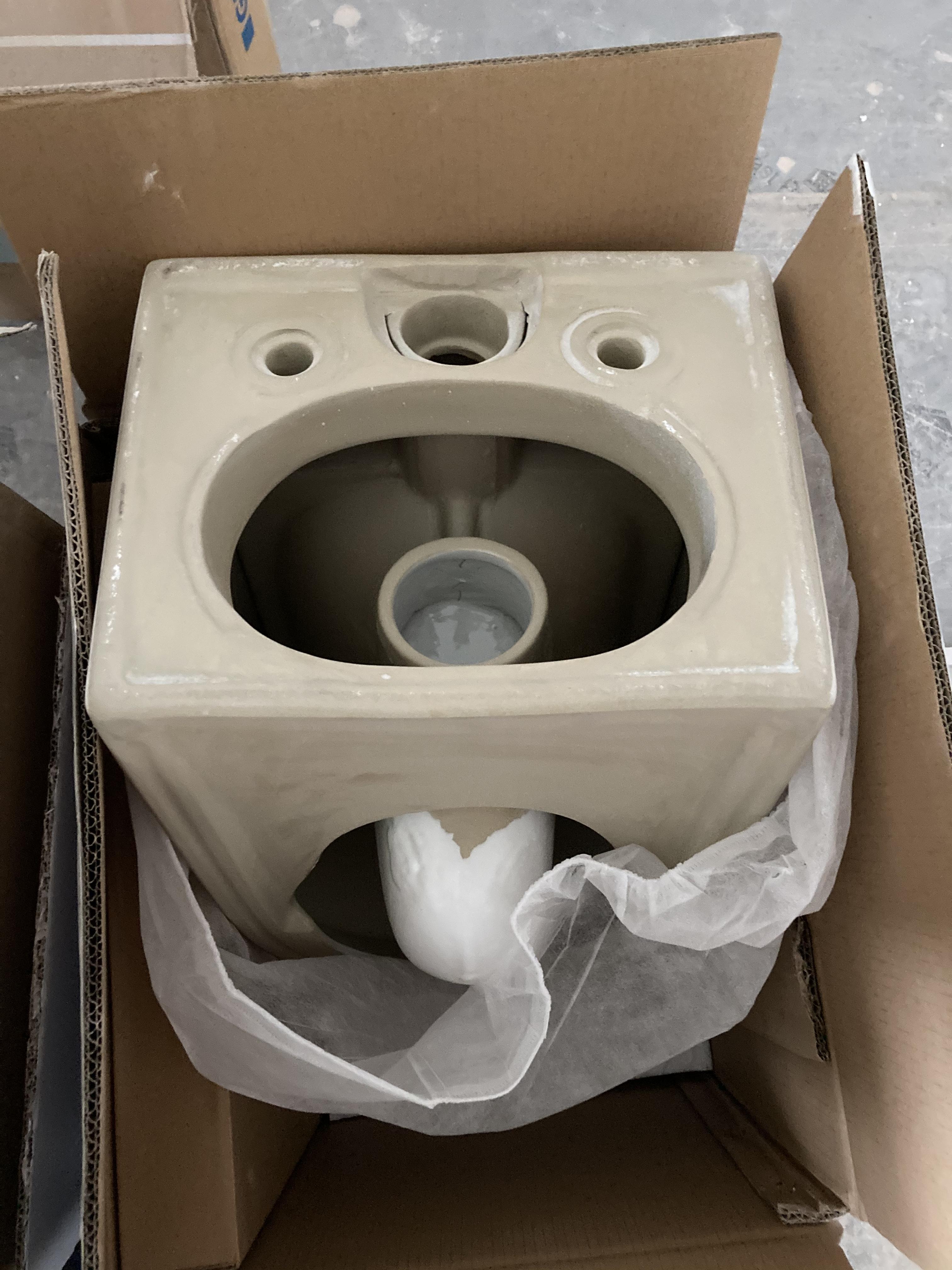

PeterW Posted January 30, 2021 Share Posted January 30, 2021 15 minutes ago, Russdl said: The frame is a Geberit Duofix. No gasket. The toilet bowl is Lusso, vague instructions. got a photo of the bottom / back of the pan ..? Link to comment Share on other sites More sharing options...
Russdl Posted January 30, 2021 Author Share Posted January 30, 2021 @PeterW Here’s one of the back and underside. Link to comment Share on other sites More sharing options...
Mr Punter Posted January 30, 2021 Share Posted January 30, 2021 I would not bed on CT1 as if there is any future issue with the pan or plumbing behind you will wreck the tile. Just silicone will be fine. The frame does the job of supporting the pan, not the mastic. 1 Link to comment Share on other sites More sharing options...

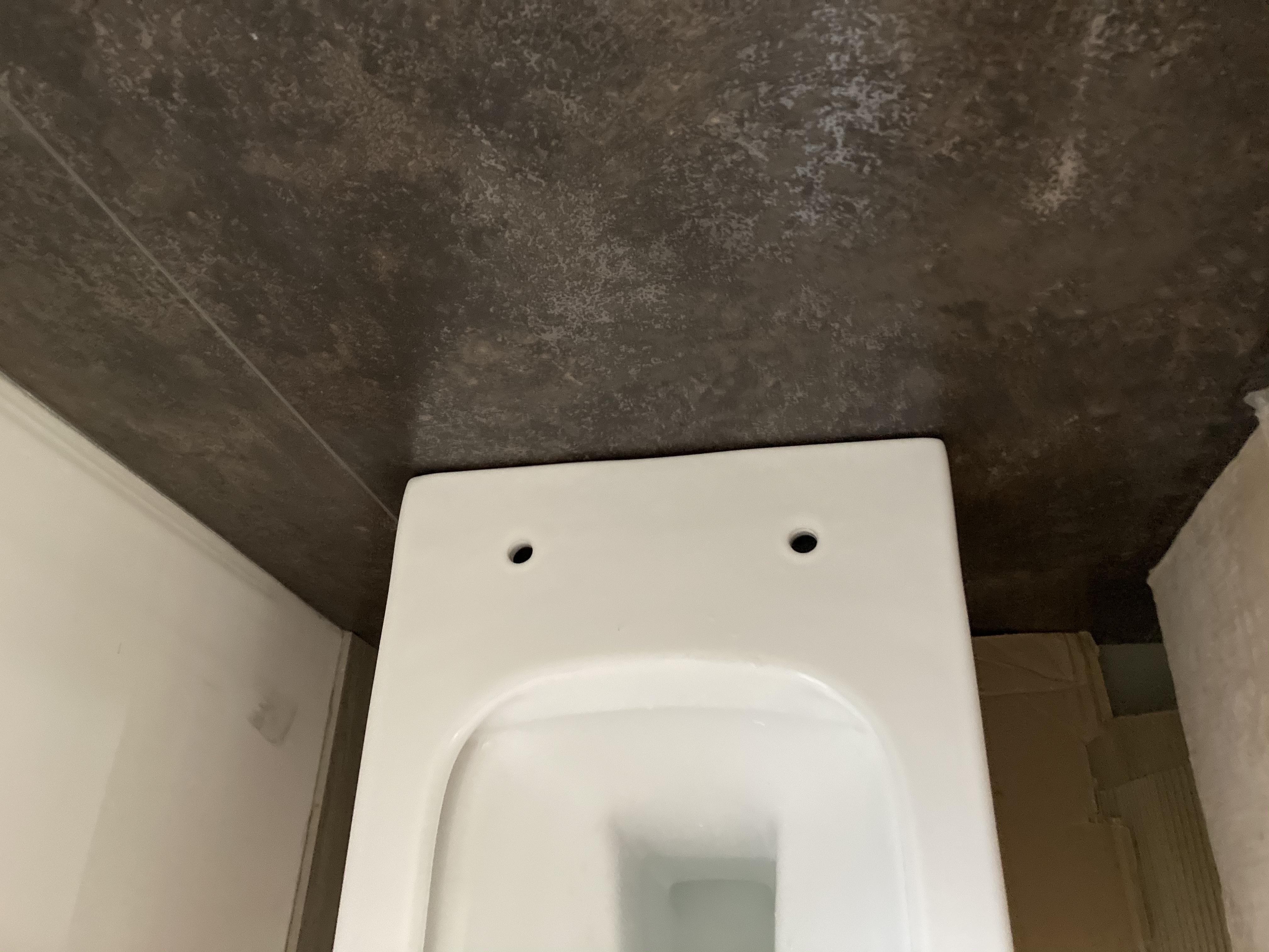

Onoff Posted January 30, 2021 Share Posted January 30, 2021 @pocster is having similar wall hung pan issues at the moment but his frame and pan are both Geberit. Hopefully your fixing inserts fit the pan fine? I'd CT1 it assuming your wastes behind are all good and leak free then the Geberit frame is pretty much bullet proof and accessible through the flush plate for maintenance. If those wastes fail then it's tiles off and cut through the wall board time anyway! I was particularly careful testing before boarding over, not least as I had a two different makes, "wrong way round" F to M joint where the grey meets the brown, solvent joint (done with pvc gap filling cement then CT1'd over): I even mocked up a pan to test the flush etc: 2 Link to comment Share on other sites More sharing options...
Russdl Posted January 30, 2021 Author Share Posted January 30, 2021 @Onoff I’m pleased to say that the pan attaches to the (buried behind tiles) frame without issue. It’s just a case of finishing it off, where to mastic/CT1 and where not to. 1 Link to comment Share on other sites More sharing options...
PeterW Posted January 30, 2021 Share Posted January 30, 2021 Decent bead of CT1 all round about 20mm in from the edge and nip the bolts up. Level it across the back then tighten, wipe any excess CT1 off the pan or tiles and the leave for 24 hours. Then go back over with a decent LMN silicone of your choice. 3 Link to comment Share on other sites More sharing options...
