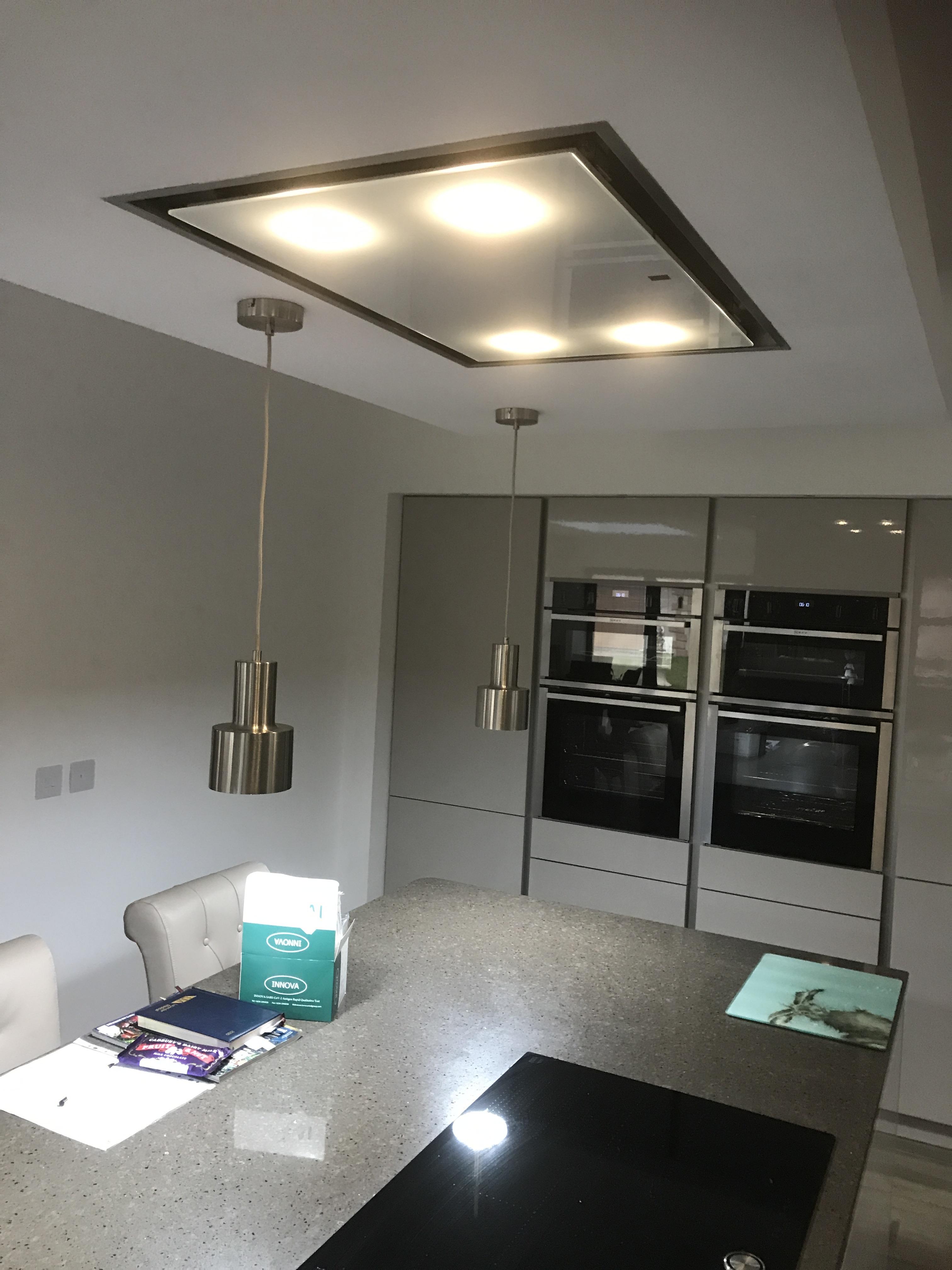

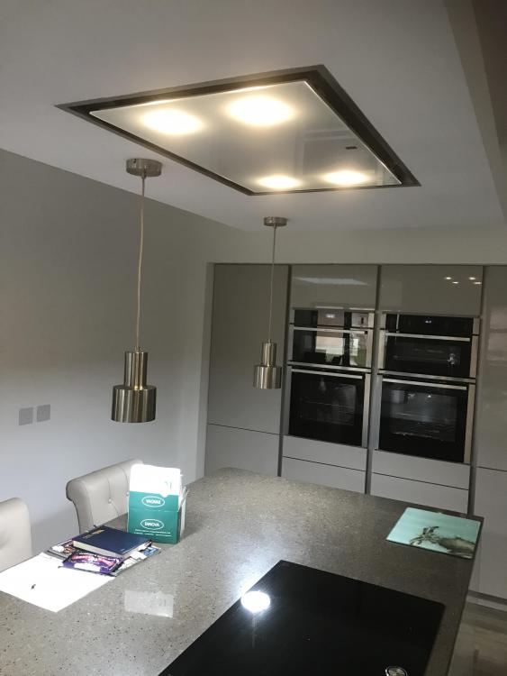

We used a Gealux extractor
Quite pricey but get rid of anything in seconds

The ceilings  are 2.9 and I built the extractor housing to be 1200 off the hob
I can burn Something in the oven Open the door and the extractor drags the smoke in as quick as it comes out
Hmm!  Our distance would be more like 2m so probably wouldn't be as effective as yours.
