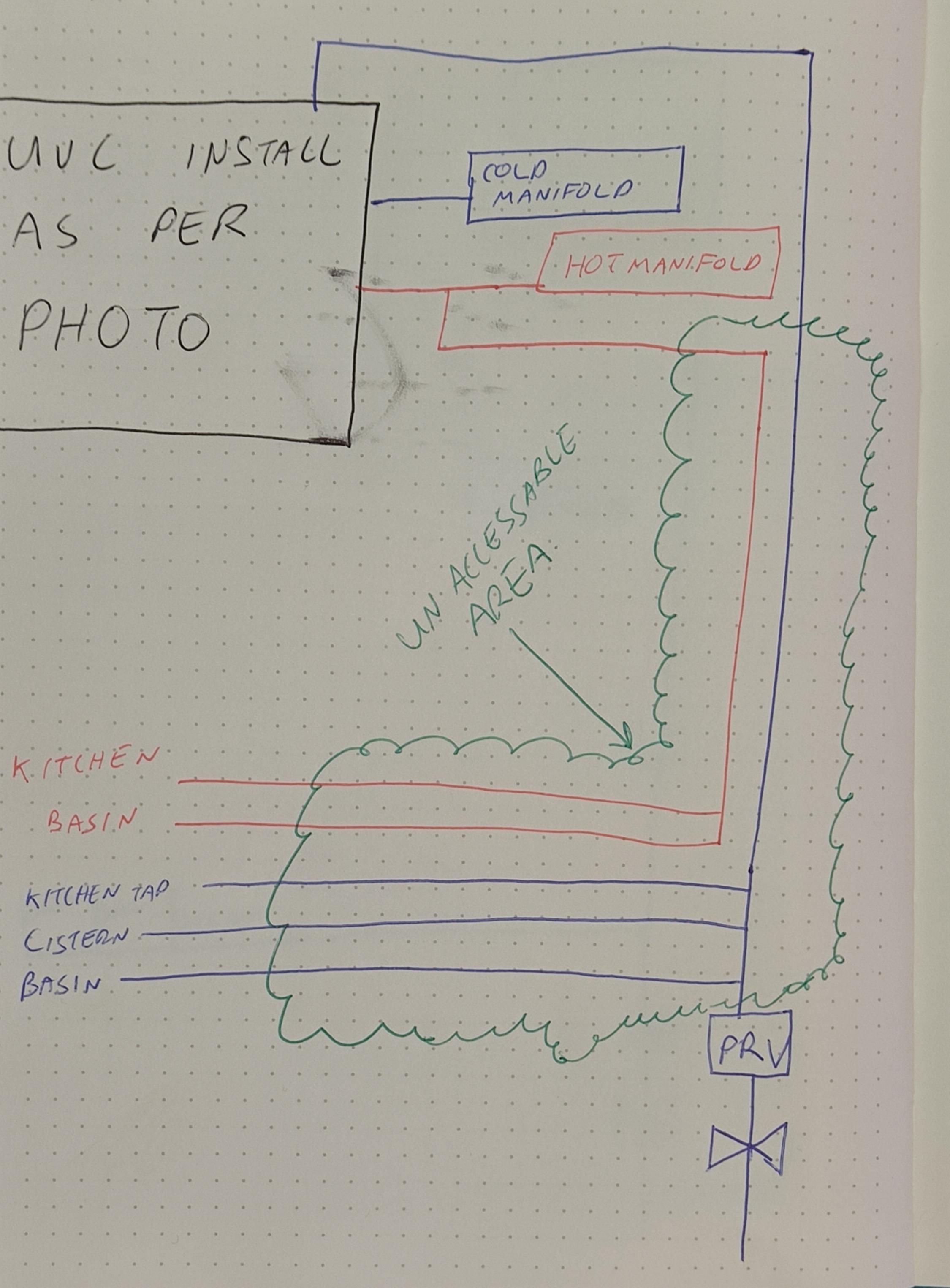

Ok on to the big problem.
As I said above I initially asked  the Cold Mains to be taken to the UVC and everything to be distributed via a manifold system. This didn't happen.
The plumber installed:
1. A Mains stop cock
2. A mains PRV
3. Teeed off the main pipe to provide cold for (downstairs) 1 basin mixer, 1 cistern and the kitchen tap.
4. Routed the mains to the UVC
5. Teeed off for a cold manifold
6. Installed the UVC as shown.
7. Routed the water to a hot manifold
8.Teed off in 26mm pipe for the (downstairs) aforementioned basin and kitchen tap.
9.Went from 26mm to 2x 16mm pipe for the final runs to the taps downstairs.
Will this mean our basin and kitchen mixer will remain unbalanced even if we remedy the UVC installation?
Is this contributing to the 3.5 Litre and 1 minute wait time for hot water in our kitchen tap at full hot? ( I thought it was just the 26mm pipe run holding a lot of cold water)
The basin takes ages to get hot too.
My solution:
Run more 16mm pipes from the UVC to join the final runs to the downstairs taps.
Unfortunately this will require pulling down a ceiling in our utility and either cutting out a section of our built in utility cupboards that were installed last week or removing them.
I'll add a video in a while and sketch a diagram.
Thanks,
Jonathan
Ok,
I've removed the handle to the EV.
I couldn't fit in the non return valve as I have no tools or fittings for the multilayer pipe and I would need to cut it and rejoin.
I measured the kitchen tap's performance.
It is a run of 11m from the UVC. Half 26mm, half 16mm.
It takes an average of 45 seconds and 4 litres of water to get to full hot temperature. This seems very slow. The issue returns if you leave the tap alone and come back to it.
Is it the unbalanced feeds that is causing this or an issue with the TMV?
26mm for 5.5m is roughly 2.65l
16mm for 5.5m is roughly 1.11l
So your total dead leg is approx. 3.76l ( assuming my maths is correct!)
That would tie in with your 4l, so it looks like ypu are simply pulling the dead leg through at 8.89l per minute flow rate.
 No issue with the TMV or balancing, just the distance from the tank to the tap causing the issue.

Tell me! Just whacked the bathroom basin mixer on hot and timed it. 1m to warm, 1m15s to hot ?
So we're in!
The kitchen tap is taking 45 sec on average to get hot water. The downstairs basin 1 minute.
In practice we're not waiting for water to heat up in the basin and in the kitchen we're dumping 20-30 litres a day waiting for the hot tap. With this drawing the equivalent amount of cold into the UVC. As I've set it up to heat all the water with a cheap night rate tariff this meant my 9pm shower went cold half way through.
With more accurate measuring I reckon its a total 16.2m of a hot water run to the kitchen tap. Compromised of 9m of 16mm(12mm internally) and 7.2m of 26mm. (20mm internally)
Doing the sums this gives 2.26l from the 26mm pipe and 1.02l from the 16mm pipe. Where is the remaining 1.22 litres of water coming from. Is it a delay through the TMV?
The reason that this makes a difference is that if i was to change the setup to 16mm pipe all the way through it would speed up time to tap to 18 seconds  about 2 litres best case or 30 second worst case , still too slow.  Alternatively I go 10mm Hep20 and potentially have hot water in 5 seconds, with perhaps a lower flow rate than 6l/m we have currently.
I'm tempted to just install an undersink water heater and cap the hot line off. We'd have very little hot water delay. No pipe losses and wouldn't have to go tearing down the ceiling of our lovely new house.
The only negatives I can see would be less chance to avail of night rate electricity. The losses from storing water in a smaller volume would probably be offset by the lack of pipe losses.
Your thoughts please.

Ouch.
There is a cheap seats fix which will reduce these huge waiting times. Downside is you’ll need to heat hot water on demand by the sounds of things.
You can fit a HRC ( hot return circuit ) pump at the UVC which just warms through the pipework in the plant room, so just pumping through all the local large bore stuff and back to the UVC. I can see a HRC tapping blanked off I think, so the facility is there.
Heating the cylinder on E10 may be something that works better for you, as with the HRC being needed throughout the day you’ll need to keep the tank up to temp, and E10 will lend itself to you coordinating with that to minimise running costs.
If you have PV, then summertime costs should be significantly reduced.
Thets the only way you can get a good overall outcome here, just a shame your designer didn’t ‘see this one coming’ and then “cajole” you into fitting a HRC ( eg to suggest an elegant solution for your ongoing comfort and practicality ).
Tye above solution would be cheap to implement, and will help out quite a bit as I think the biggest issue is the large dead leg in between the UVC and manifold.

I’d prefer to reconfigure the entire UVC layout to minimise the dead legs by putting the TMV and Hot manifold as close as possible to the UVC outlet. Generally tidy up the layout and balance the cold manifold correctly
That would remove about half a pint of dead water, probably less in actuality.
What you could do is have the TMV hot inlet connected to the top of the UVC, with that going in on a 90o bend, so the mixed output of the TMV is rising vertically, and then have the hot manifold rising vertically off the TMV. That would promote natural convection into the TMV and manifold thus creating a setup that Pre-heats itself prior to hot water being drawn from the smaller, downstream pipes.
I was reckoning about 400ml so you're pretty much spot on! ( about 4 seconds at the kitchen tap, 6 seconds at the basin) The very best case I can get water to the kitchen tap in a 16mm pipe is 16 seconds. I'm tempted by having hot water at the kitchen tap in less than 1 second with the undersink heater and 4 seconds at the basin tap.

It will remove a reasonable chunk of my dead leg problem for sure but the issue of the remaining 7.2m of 26mm pipe now hidden in the ceiling and behind the cupboards would remain.
I suspect I would still be left with a 30 second time to hot at the kitchen tap for all the extra effort.
Work out what these heaters and extra plumbing / additional points of loss & failure will amount to, and reconsider.
Yes, the option of using the multipoint heater will work, but why not just improve the UVC install and improve the whole of house scenario vs invest more / lose cupboard space, and the rest of the house gets zero benefit.....
The improved performance of the kitchen sink will exacerbate the issue in the rest of the house, and that would piss me off even more.
2 choices, both require money. One solves one problem, the other improves the whole of house situation.
I know what I’d be doing.
If we were back at square 1 I would plumb the whole thing myself. I would trial 10mm to the kitchen tap during construction to see if the flow was sufficient. If not I would upgrade to 15mm and see if the time to hot was quick enough. If neither was enough I would consider an instant water heater to boost the kitchen tap or else maybe a circulation loop. Sadly that ship has sailed.
To go down this route now would require core drilling through a 225mm concete first floor, taking down the ceiling of our utility. Cutting out the back of one of the cupboards in the utility, painstakingly threading the required pipe under the units in the utility, the W/C and the kitchen. and replacing/repairing everything once we're done. On top I would have to attack the UVC installation and replace multilayer pipes with something I could DIY. All for a potential reduction from 45seconds to a best case of 16. (assuming 10mm pipe won't provide 6l/m)
The rest of the house is ok as all other outlets are fed from 16mm feeds via very short runs. The shortness of the runs hides the large volume pipes upstream of the manifold.
