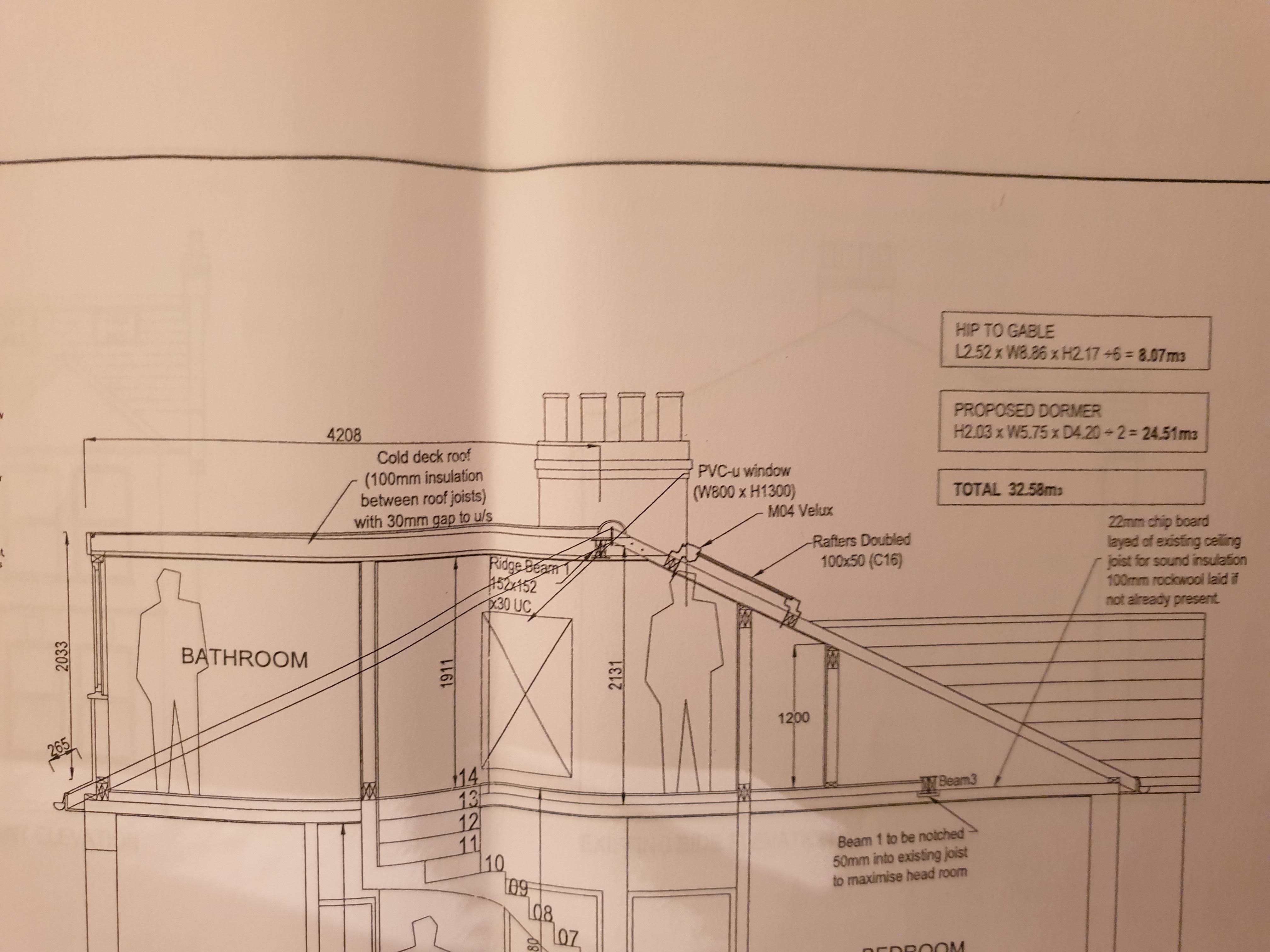

Willl Posted January 23, 2021 Share Posted January 23, 2021 Hi to all, I am looking to do a loft conversion and am confused as to whether planning permission is required.. I have spoken to the planning department and they were unable to advise and to get pre planning advice from them costs hundreds of pounds! I am going to copy what a neighbour has done with their identical property and they have kindly given me their plans to refer to. (Unfortunately they are unsure as to whether they had to get planning permission.. ) These show the measurements for the conversion as: HIP TO GABLE: L2.52 X W8.86 X H2.17 / 6 = 8.07m3 PROPOSED DORMER: H2.03 X W5.75 X D4.20 / 2 = 24.51m3 TOTAL = 32.58m3 The measurement from the ridge to the back of the new roof would be 4208 and the height at the back 2033. I can’t see a measurement showing the width of the property (don't think this is shown in the measurements above?? ) I believe we satisfy all the criteria listed here (for permitted development): https://www.planningportal.co.uk/info/200130/common_projects/36/loft_conversion but I am not certain of the first one: A volume allowance of 40 cubic metres additional roof space for terraced houses* If anyone could 'shine some light' that would be much appreciated! Thanks, Will Link to comment Share on other sites More sharing options...

Temp Posted January 23, 2021 Share Posted January 23, 2021 There is a bunch of info in here but I suspect you are OK. https://www.gov.uk/government/publications/permitted-development-rights-for-householders-technical-guidance Search it for "loft" or "roof" as the relevant bits are spread out. 1 hour ago, Willl said: HIP TO GABLE: L2.52 X W8.86 X H2.17 / 6 = 8.07m3 Not quite sure why you have divided by 6? Can you post a sketch with dimensions? If the height is only 2.17m won't you will have a problem with headroom, especially after taking into account the depth of insulation needed. Link to comment Share on other sites More sharing options...
joe90 Posted January 23, 2021 Share Posted January 23, 2021 15 minutes ago, Temp said: taking into account the depth of insulation needed. Yes, depends on how long ago your neighbour did theirs, insulation levels are going up all the time (quite right too). Post the drawings up here and there are guys here who know the regs. Link to comment Share on other sites More sharing options...

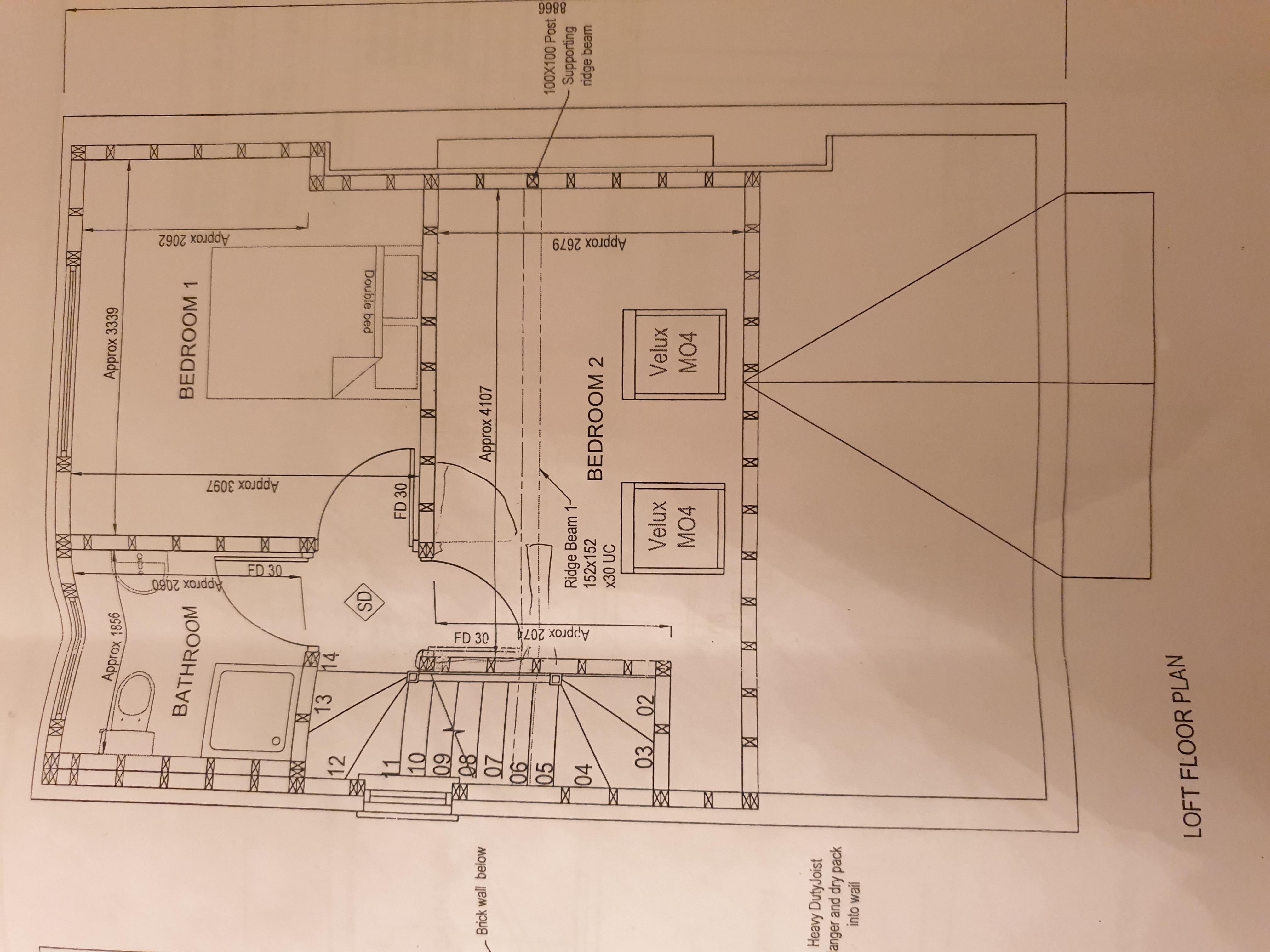

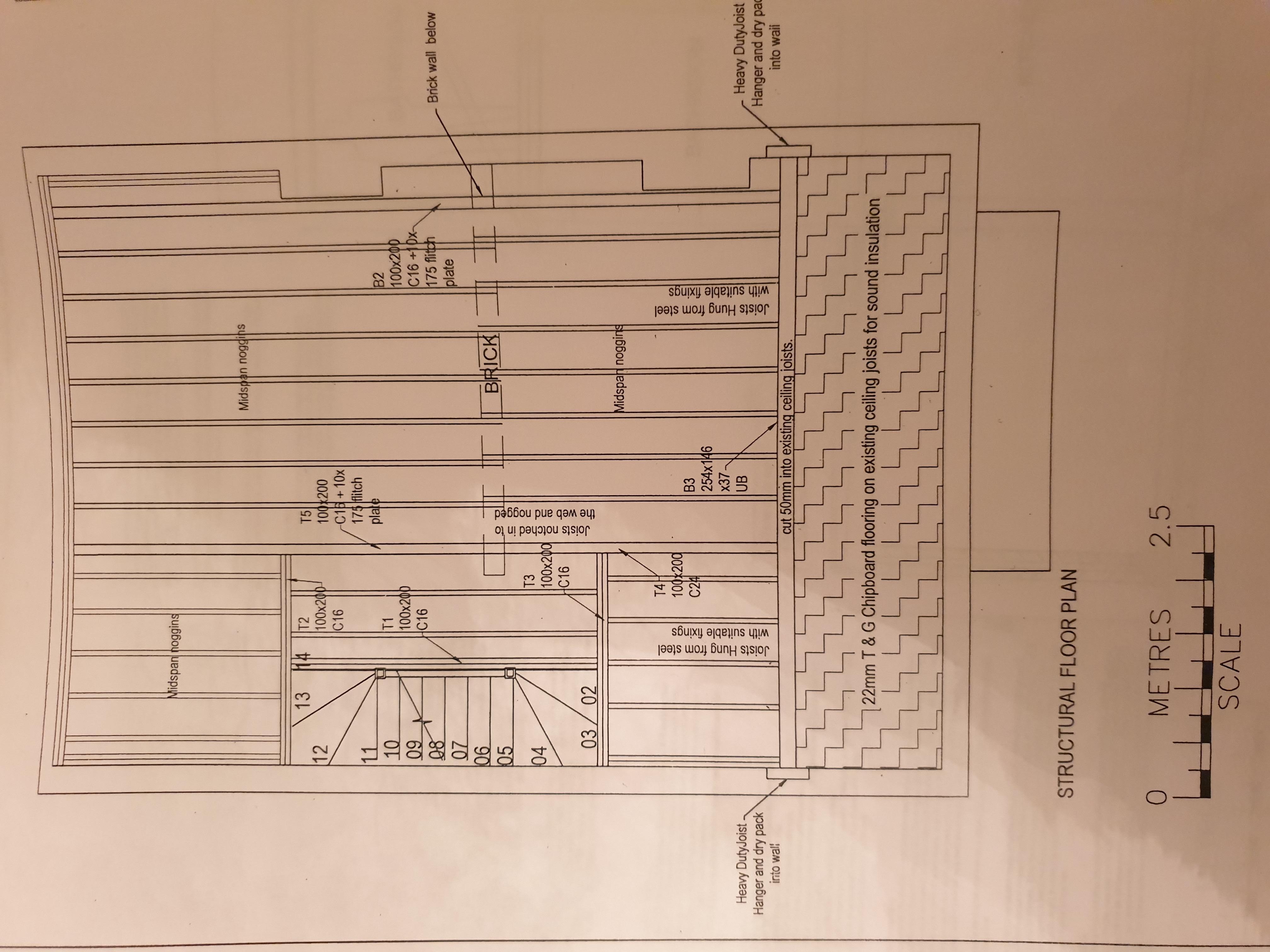

Willl Posted January 29, 2021 Author Share Posted January 29, 2021 Drawings attached. Thanks, Will Link to comment Share on other sites More sharing options...
Willl Posted February 2, 2021 Author Share Posted February 2, 2021 I don't know if the drawings posted help shine some light on if I need planning permission? As mentioned above I think we are within all the criteria for permitted development but I am a little unsure regarding this rule: A volume allowance of 40 cubic metres additional roof space for terraced houses* Any advice would be much appreciated.. Thanks, Will Link to comment Share on other sites More sharing options...
Mr Punter Posted February 2, 2021 Share Posted February 2, 2021 (edited) Agree with @Temp and @joe90. The neighbours would not work with current building regs. You need at least another 100mm height. Have you seen the neighbours? Edited February 2, 2021 by Mr Punter Link to comment Share on other sites More sharing options...
Temp Posted February 2, 2021 Share Posted February 2, 2021 On 23/01/2021 at 13:02, Willl said: HIP TO GABLE: L2.52 X W8.86 X H2.17 / 6 = 8.07m3 PROPOSED DORMER: H2.03 X W5.75 X D4.20 / 2 = 24.51m3 If the dimensions are correct I agree with those calculations. The hip to gable is the volume of a triangular base pyramid on its side = 1/3(area of base * height). The area of the base has a further 1/2 in it so yes 1/6(L*W*H) of the hip is correct. The dormer volume is calculated as half the volume of a rectangular block so again 1/2(L*W*H) of the dormer is correct. The total volume increase is 8.07 + 24.51 = 32.58 cubic meters. That is less than the 40 cubic meter limit for Permitted Development so Planning Permission should not be required for that reason. However there can be other reasons why Planning Permission is needed in here'.. https://assets.publishing.service.gov.uk/government/uploads/system/uploads/attachment_data/file/830643/190910_Tech_Guide_for_publishing.pdf For example you need PP if any of the following applies.. Page 9 - If Permitted Development Rights have been removed. It is important to note that a local planning authority is allowed to remove permitted development rights in some or all of its area by issuing what is known as an Article 4 Direction; or may have removed those rights on the original, or any subsequent, planning permission for the house. An Article 4 direction is unlikely unless you are in a conservation areas of area or similar where they are trying to maintain a particular style of house. You will need to ask the planners if your area is subject to an "Article 4 Direction". Also look at the planning history of your house to see if Permitted Development rights have been removed on an earlier application. Page 33.. (c) any part of the dwelling house would, as a result of the works, extend beyond the plane of any existing roof slope which forms the principal elevation of the dwelling house and fronts a highway. So is the hip to gable or the new dormer on the principle elevation (aka) front of the house? Sometimes its not clear elevation that is. There are also conditions.. Page 35 (a) the materials used in any exterior work shall be of a similar appearance to those used in the construction of the exterior of the existing dwelling house. Page 35 (b) the enlargement shall be constructed so that – (i) other than in the case of a hip-to-gable enlargement or an enlargement which joins the original roof to the roof of a rear or side extension – (aa) the eaves of the original roof are maintained or reinstated; and (bb) the edge of the enlargement closest to the eaves of the original roof shall, so far as practicable, be not less than 0.2 metres from the eaves, measured along the roof slope from the outside edge of the eaves; and (ii) other than in the case of an enlargement which joins the original roof to the roof of a rear or side extension, no part of the enlargement extends beyond the outside face of any external wall of the original dwellinghouse You appear to meet all that - (i)(aa) and (bb) because you are retaining 0.265m of the roof in front of the new dormer (see also diagram page 36). - (ii) because you arent extending beyond a wall. Page 36 (c) any window inserted on a wall or roof slope forming a side elevation of the dwellinghouse shall be - (i) obscure-glazed, and (ii) non-opening unless the parts of the window which can be opened are more than 1.7 metres above the floor of the room in which the window is installed So is the dormer window on the side of the house? I suspect your proposal is covered by Permitted Development but I'm not a/your Planning Officer. The only way to be 100% sure is to apply for a Certificate of Lawfulness. See Page 4.. To be certain that a proposed development is lawful and does not require an application for planning permission it is possible to apply for a ‘Lawful Development Certificate’ from the local authority. However there is a fee, forms etc. Link to comment Share on other sites More sharing options...

ProDave Posted February 4, 2021 Share Posted February 4, 2021 I don't think anyone else has mentioned that will fail building regs. You need 2 metre headroom for the staircase and the "landing" Link to comment Share on other sites More sharing options...
Ferdinand Posted February 5, 2021 Share Posted February 5, 2021 Is 100mm enough roof insulation? F Link to comment Share on other sites More sharing options...
Mr Punter Posted February 5, 2021 Share Posted February 5, 2021 On 03/02/2021 at 22:49, Willl said: Can I clarify what you mean here Mr Punter please? "The neighbours would not work with current building regs. You need at least another 100mm height. Have you seen the neighbours?" Is this of insulation or the plans posted would be rejected as the height in the rooms / ceiling height is too low? I have seen the neighbours extension yes and he said that the ceiling height he has is 205 (so I don't know if the plans weren't stuck to strictly.. ) Yes, if you use the plans from your neighbour they will not meet regs. There is not enough ceiling height and not enough insulation in the roof. Link to comment Share on other sites More sharing options...
Willl Posted February 8, 2021 Author Share Posted February 8, 2021 Okay, thanks guys - it seems that I should get new plans drawn up or at least theses plans checked and amended to make sure I satisfy current building regs.. It is interesting that these plans do not show enough height on the stairs and landing and I think in the rooms too..? Looking at other loft conversions on the street some seem to be slightly higher than the central ridge.. would this contradict this permitted development rule though? Must not exceed the height of the existing roof. Thanks again! Will Link to comment Share on other sites More sharing options...
