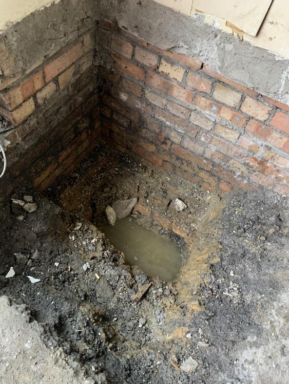

Adsibob Posted January 17, 2021 Share Posted January 17, 2021 27 minutes ago, PeterW said: Start here for some decent information about old houses https://www.heritage-house.org Thanks @PeterW. I’ve just emailed my photo to heritage house and asked if they could attend to do an urgent survey. They have an office in London, so fingers crossed they can. 1 Link to comment Share on other sites More sharing options...

PeterW Posted January 18, 2021 Share Posted January 18, 2021 13 minutes ago, PeterStarck said: In a Victorian cavity wall house I bought back in the 90s there was damp on the internal wall for about 0.5m up from the floor. The reason was the soil level was above the slate DPC. I lowered the soil level and the problem disappeared. If the water hadn't seeped up the bricks how did the wall get wet above the soil level? Usually there is no insulation and a breached DPC on the outside will allow the inside of the cavity through the mortar to become damp, and also reduce the temperature considerably inside the cavity, lowering the inner wall temperature and causing condensation to occur on the inner wall. The Heritage House link explains a lot of this and it’s interesting to read, and the science (especially the vapour pressures required) to create such a high capillary stack mean that “damp rising” is more likely to be “cold rising and condensation forming”. 1 Link to comment Share on other sites More sharing options...

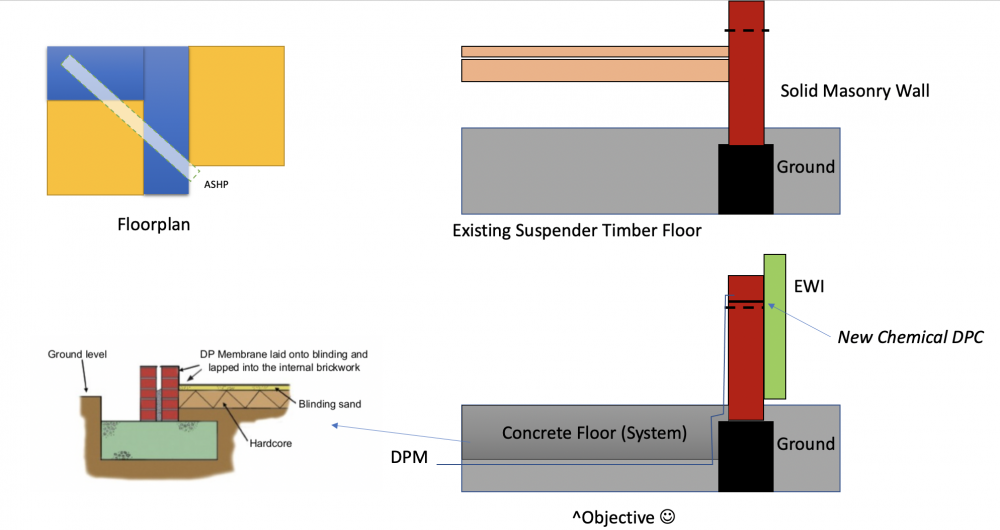

DeanAlan Posted January 18, 2021 Author Share Posted January 18, 2021 @Gus Potter up for spending £15 to say £1k. @Roger440 yes, EWI outside (with its own member) and then DPM lapping up the wall 600mm of so is just going to create a wall of brick tanked either side so the capillary action will suck up the water and it will not have opportunity to evaporate away given the membranes. When you say treat the building as if it doesn't have a DPC, what would that be? @Adsibob hope we solve our floor lowering and damp problems. Our water table (as off two days ago and the heavy rain) about 1m below ground level but our current floor is 600m above that. I have another thread on here where I'm looking at digging a cellar below the water table which is generating some cool ideas. cheers, -Dean Link to comment Share on other sites More sharing options...

Roger440 Posted January 18, 2021 Share Posted January 18, 2021 10 hours ago, DeanAlan said: @Gus Potter up for spending £15 to say £1k. @Roger440 yes, EWI outside (with its own member) and then DPM lapping up the wall 600mm of so is just going to create a wall of brick tanked either side so the capillary action will suck up the water and it will not have opportunity to evaporate away given the membranes. When you say treat the building as if it doesn't have a DPC, what would that be? @Adsibob hope we solve our floor lowering and damp problems. Our water table (as off two days ago and the heavy rain) about 1m below ground level but our current floor is 600m above that. I have another thread on here where I'm looking at digging a cellar below the water table which is generating some cool ideas. cheers, -Dean Unless you can "fix" the DPC properly, it needs to dissipate the moisture through whatever is on the wall both sides. Ie, breathable. And dont let the drivel on modern coatings that claim to be breathable fool you. There is a measure for the breathability. Compare that number to actual lime based poducts and you will see the issue. That said, just talk to the lime guys and be guided by them. Link to comment Share on other sites More sharing options...

Adsibob Posted January 18, 2021 Share Posted January 18, 2021 I heard back from Heritage House this afternoon. Unfortunately, they are fully booked for the next month and I can’t wait that long. They also wanted £1000 plus VAT which I thought was excessive given the house is in such a skeletal state following 6 days of 4 hardworking guys gutting it and exposing the foundations, that it should be quite an easy inspection for them. So instead I’m going with a chartered surveyor who has these qualifications: BSc (Hons); MSc; MMBEng; MRICS, but more importantly doesn’t like chemical injections and follows the breath-ability school of thought. I will tell him I’m quite keen on that lime company and see if he can work with them based on his findings at the property to specify something that won’t cost me any more than what the builder has quoted for before we discovered the water. 1 Link to comment Share on other sites More sharing options...
PeterW Posted January 18, 2021 Share Posted January 18, 2021 51 minutes ago, Adsibob said: So instead I’m going with a chartered surveyor who has these qualifications: BSc (Hons); MSc; MMBEng; MRICS, but more importantly doesn’t like chemical injections and follows the breath-ability school of thought. I will tell him I’m quite keen on that lime company and see if he can work with them based on his findings at the property to specify something that won’t cost me any more than what the builder has quoted for before we discovered the water. Why are you telling the surveyor what materials you want to use ..? Let him make the recommendations as it’s his PI when it goes wrong or doesn’t work how you want it to. 52 minutes ago, Adsibob said: They also wanted £1000 plus VAT which I thought was excessive That’s less than 3 days chargeable work. You lose half a day for travel, half day to inspect, day to a day and a half to write up a report and make recommendations - at £400/ day that is cheap for a surveyor, mine is on site for 20 minutes and charges £85. Link to comment Share on other sites More sharing options...

DeanAlan Posted January 21, 2021 Author Share Posted January 21, 2021 On 18/01/2021 at 21:15, Roger440 said: Unless you can "fix" the DPC properly, it needs to dissipate the moisture through whatever is on the wall both sides. Ie, breathable. And dont let the drivel on modern coatings that claim to be breathable fool you. There is a measure for the breathability. Compare that number to actual lime based poducts and you will see the issue. That said, just talk to the lime guys and be guided by them. @Roger440in a prefect world, I am looking to improve the airtightness of this property as a I renovate. The extension (150% additional size) will have reasonable (beyond building regs) attention in this area and would like to bring the older part of the property up to similar level (the original 86sqm property will be basically taken back to its external walls and roof structure with replacement ground floor structure etc). If my current DPC is badly compromised (still a question really) and I am having EWI installed (which will reduce the external breathability of the solid walls to a point you made earlier) then feels like my options are narrowing in that I'm going to need to let the walls breath internally more (lime plaster?). It could be the DPC is fine (I did notice, for example, that the DPC had been mortared over externally in a few places and plastered over internally and these are therefore both moisture bridges - i'll get the external ones fixed before EWI goes on) and that the dampness originated from condensation. cheers, -Dean Link to comment Share on other sites More sharing options...
Roger440 Posted January 21, 2021 Share Posted January 21, 2021 8 hours ago, DeanAlan said: @Roger440in a prefect world, I am looking to improve the airtightness of this property as a I renovate. The extension (150% additional size) will have reasonable (beyond building regs) attention in this area and would like to bring the older part of the property up to similar level (the original 86sqm property will be basically taken back to its external walls and roof structure with replacement ground floor structure etc). If my current DPC is badly compromised (still a question really) and I am having EWI installed (which will reduce the external breathability of the solid walls to a point you made earlier) then feels like my options are narrowing in that I'm going to need to let the walls breath internally more (lime plaster?). It could be the DPC is fine (I did notice, for example, that the DPC had been mortared over externally in a few places and plastered over internally and these are therefore both moisture bridges - i'll get the external ones fixed before EWI goes on) and that the dampness originated from condensation. cheers, -Dean If you can be sure the dpc is fixed/working, then all should be well, but id still tread carefully. My house is similar, old bit half the size of the new bit, though i didnt build it. I just accept that the downstairs part of the original house just wont be that good. Ie, no insulation on the walls, but will have in the floor (foamed glass) My old 30's semi cost twice as much to heat as this, and this is twice the size. Thats despite having the flue from the wood burner (now removed) open, But it has to be or the humidity starts to climb. Basically its viable top close off the ventilation without creating other issues. I suppose i could use MHVR. But as its comfortable, and not that expensive to heat, i'll live with it. Link to comment Share on other sites More sharing options...
