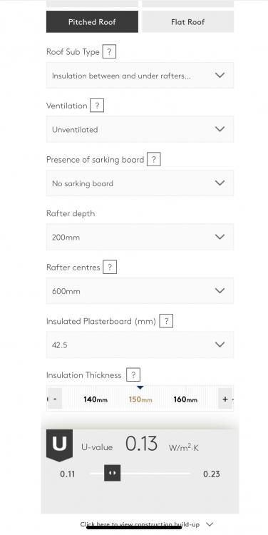

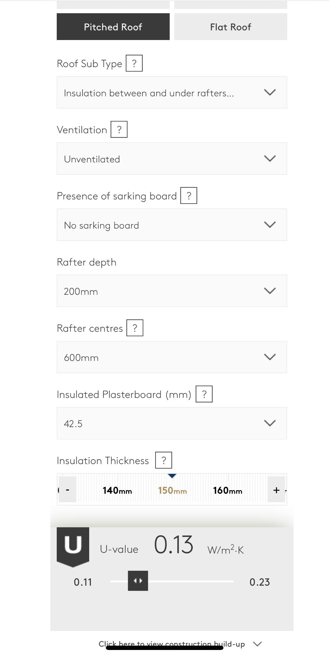

PeterW Posted January 14, 2021 Posted January 14, 2021 26 minutes ago, BartW said: Currently, getting at a typical warm roof buildup with OSB/PIR/OSB, all upon rafters. Could I reduce the thickness of the PIR above to, say, 50mm, pack rock wool in-between rafters, and finish off with a insulated plasterboard? That area of ceiling is less than 10m2. No - that’s a hybrid build up and would need ventilated cavities etc and a nightmare to detail - just make it a warm roof or look at the minimum joist sizes you need for the shortest span and run the terrace in those. 28 minutes ago, BartW said: What if: - I use 150mm packed rock wool in a 140mm stud (is it a healthy thing? Would that give a benefit? Or should I stick to 140 / 140) No benefit as insulation depends on trapped air and you’re excluding that 29 minutes ago, BartW said: put a single layer of PIR internally @ 80mm You’ve created an air gap for no reason..?? Seems no point to this build up. Why not 140mm of Rockwool plus 40mm of PIR or 52.5mm insulated plasterboard ..? Or 90mm of PIR and 25mm over ..?? 31 minutes ago, BartW said: the build has got a budget cap, and I worry that layers of rock wool will brake the piggy bank, and add a considerable amount of time to the build Insulation per “uValue” is broadly comparable per square meter - yes you need 50% more EPS depth for a certain value vs PIR, but PIR is around 50% more expensive than EPS so it levels out. Similar with Rockwool and PIR, you won’t make huge savings here.
joe90 Posted January 14, 2021 Posted January 14, 2021 Have you thought about blown cellulose insulation?
TonyT Posted January 14, 2021 Posted January 14, 2021 You could fill the 140mm timbers, then overlay a sheet over the top at right angles, tape this etc, then fix battens for a service void.
BartW Posted January 14, 2021 Author Posted January 14, 2021 32 minutes ago, PeterW said: 1 hour ago, BartW said: put a single layer of PIR internally @ 80mm You’ve created an air gap for no reason..?? Seems no point to this build up. Sorry, I should have clarified. The what if scenario assumes doing both, not either or. 16 minutes ago, joe90 said: Have you thought about blown cellulose insulation? I have. It was big money when I checked. 11 minutes ago, TonyT said: You could fill the 140mm timbers, then overlay a sheet over the top at right angles, tape this etc, then fix battens for a service void. I am assuming that is in reference to the above wall buildup?

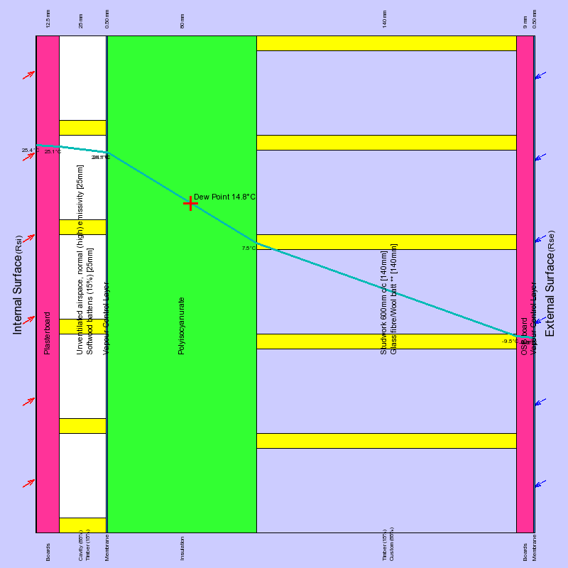

Jason L Posted January 14, 2021 Posted January 14, 2021 i have recently been looking at this, how about - using Recticel Eurothane PIR which is one of the more affordable ones. have 140mm of it between the studs, and 30mm on the inside of the studs should achieve around that u-value and reduce the overall thicness of the wall.
TonyT Posted January 14, 2021 Posted January 14, 2021 18 minutes ago, BartW said: Sorry, I should have clarified. The what if scenario assumes doing both, not either or. I have. It was big money when I checked. I am assuming that is in reference to the above wall buildup? yes, I used 100mm first, siliconed this into the stud wall, 40mm then on top with staggered joins not matching the previous layer. Again siliconed the joins and foil taped. That’s me flush with the timber and then another 40mm fixed over the studs sheets laid horizontally. Siliconed and taped- then the usual battens, VCL and plasterboard.

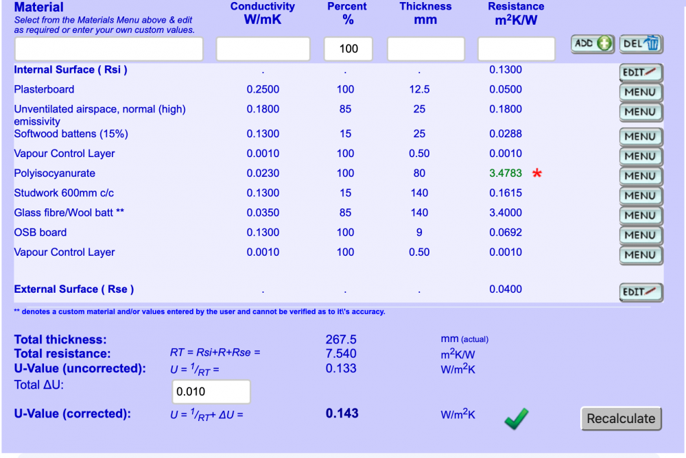

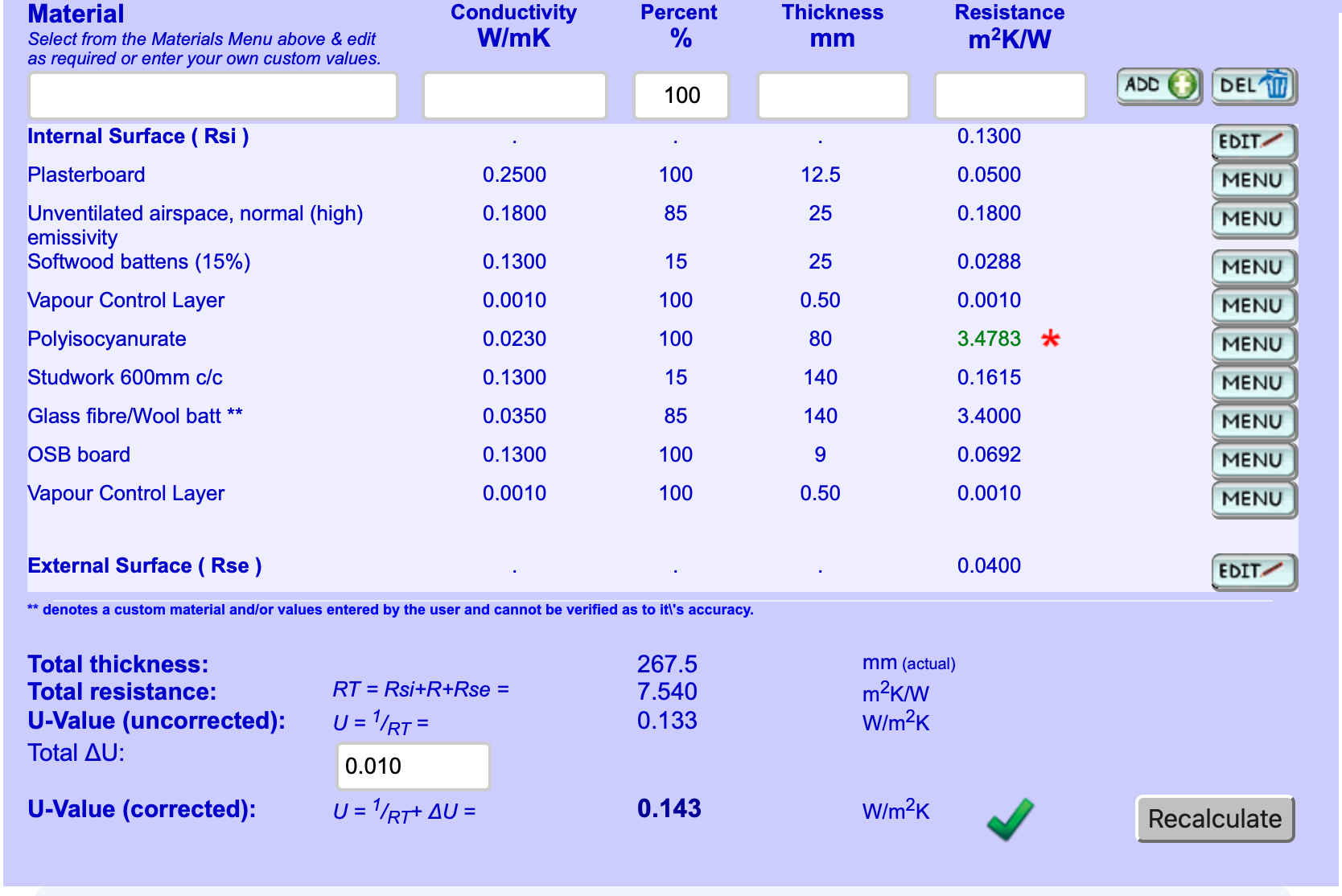

Thorfun Posted January 14, 2021 Posted January 14, 2021 if you use 140mm of Frametherm 32 between the studs you can reduce the internal PIR to probably around 40mm or 50mm to get those uValues. Also, in your uValue calculations you haven't added your external cladding. that will also reduce your uValue so probably best to add it now. oh, and it's a breathable membrane on the outside not a VCL. ?
ProDave Posted January 14, 2021 Posted January 14, 2021 40 minutes ago, Thorfun said: if you use 140mm of Frametherm 32 between the studs you can reduce the internal PIR to probably around 40mm or 50mm to get those uValues. Also, in your uValue calculations you haven't added your external cladding. that will also reduce your uValue so probably best to add it now. oh, and it's a breathable membrane on the outside not a VCL. ? Nice (relative to many other mineral wool products) to work with and will give a much longer decrement delay than PIR it's what I used in this house.
Thorfun Posted January 14, 2021 Posted January 14, 2021 7 minutes ago, ProDave said: Nice (relative to many other mineral wool products) to work with and will give a much longer decrement delay than PIR it's what I used in this house. and it's what I plan to use in my house. ?
BartW Posted January 14, 2021 Author Posted January 14, 2021 Ok, So: - Frametherm 32 is a lot more expensive than 35, and only makes a difference of 0.005 u value. So my choice of the 35 version is deliberate (or call me cheap ) - with my buildup, as in the original post reducing the PIR from 80 to 70mm means going up to 0.1501 uValue. So I kept the 80 to stay on the safe side. - sounds like my choices are feasible? 4 hours ago, TonyT said: yes, I used 100mm first, siliconed this into the stud wall, 40mm then on top with staggered joins not matching the previous layer. Again siliconed the joins and foil taped. That’s me flush with the timber and then another 40mm fixed over the studs sheets laid horizontally. Siliconed and taped- then the usual battens, VCL and plasterboard. Why not use a single sheet of 140mm? Surely It is cheaper and quicker to do a single layer rather than 100 + 40? 1 hour ago, Thorfun said: Also, in your uValue calculations you haven't added your external cladding. that will also reduce your uValue so probably best to add it now. I omitted it because it was not making any significant difference. Also the program was getting confused with layers of free air and two lots of battens setting the slates, and the cladding off the structural wall. 4 hours ago, Jason L said: i have recently been looking at this, how about - using Recticel Eurothane PIR which is one of the more affordable ones. have 140mm of it between the studs, and 30mm on the inside of the studs should achieve around that u-value and reduce the overall thicness of the wall. That was my original choice, but the decrement delay, and the fuff of precisely slotting bits of the PIR in-between the structural studs has me rethinking my choices. In an ideal world I would do rock wool throughout, but then the wall buildup increases beyond feasible (and so does the labour).
Thorfun Posted January 14, 2021 Posted January 14, 2021 53 minutes ago, BartW said: Frametherm 32 is a lot more expensive than 35, and only makes a difference of 0.005 u value. So my choice of the 35 version is deliberate (or call me cheap ) - with my buildup, as in the original post reducing the PIR from 80 to 70mm means going up to 0.1501 uValue. So I kept the 80 to stay on the safe side. - sounds like my choices are feasible? that's interesting as I went through these same calculations and I get 0.12W/m2K with Frametherm 32 and 80mm PIR. but now I think about it that uValue calculator puts the thermal conductivity of PIR as 0.023W/mK whereas you can buy 0.020W/mK PIR (obviously costs more though!) which is how I would've got to the lower uValue. I still thought Frametherm 32 made a bit more of a difference though. your choices are definitely feasible and that is exactly what I'm doing and our architects didn't have a problem with it at all. so I'd say crack on! 58 minutes ago, BartW said: I omitted it because it was not making any significant difference. Also the program was getting confused with layers of free air and two lots of battens setting the slates, and the cladding off the structural wall. fair enough. it doesn't make a huge difference but, as they say, every little helps. (other supermarket advertising slogans are available)
PeterW Posted January 14, 2021 Posted January 14, 2021 1 hour ago, BartW said: That was my original choice, but the decrement delay, and the fuff of precisely slotting bits of the PIR in-between the structural studs has me rethinking my choices. In an ideal world I would do rock wool throughout, but then the wall buildup increases beyond feasible (and so does the labour). So make a jig that allows you to cut at 2.5° and cut the PIR with a slight bevel to it. Push it home and foam the edges and it will be tight in and sealed. Why would you go with rockwool throughout..?? Mix of materials is a good thing. You can also tape the outer PIR and it will give you a VCL from the foil facing
TonyT Posted January 14, 2021 Posted January 14, 2021 1 hour ago, BartW said: Ok, So: - Frametherm 32 is a lot more expensive than 35, and only makes a difference of 0.005 u value. So my choice of the 35 version is deliberate (or call me cheap ) - with my buildup, as in the original post reducing the PIR from 80 to 70mm means going up to 0.1501 uValue. So I kept the 80 to stay on the safe side. - sounds like my choices are feasible? Why not use a single sheet of 140mm? Surely It is cheaper and quicker to do a single layer rather than 100 + 40? I omitted it because it was not making any significant difference. Also the program was getting confused with layers of free air and two lots of battens setting the slates, and the cladding off the structural wall. That was my original choice, but the decrement delay, and the fuff of precisely slotting bits of the PIR in-between the structural studs has me rethinking my choices. In an ideal world I would do rock wool throughout, but then the wall buildup increases beyond feasible (and so does the labour). I was building as the shortage of PIR/PUR boards I think due to a factory fire somewhere in Europe and I was also putting 200mm in the suspended timber floor between joists so buying 100mm meant spare could be used elsewhere in the build.
