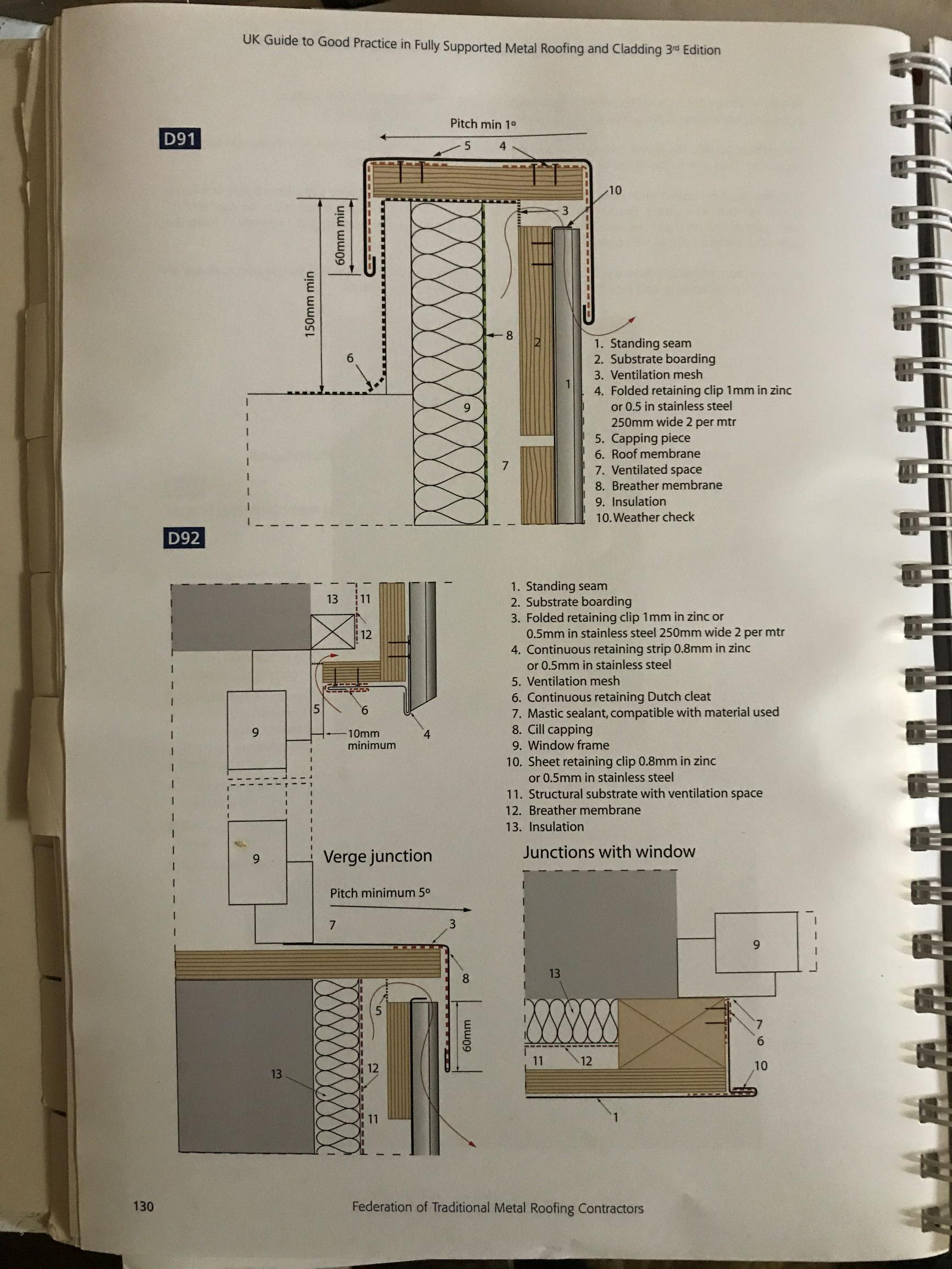

SimonD Posted January 20, 2021 Share Posted January 20, 2021 On 17/01/2021 at 20:03, Makeitstop said: I'll PM you Simon, and can perhaps forward on the drawing. It isn't a complex job and in fact, I've been told so by another installer that was aimed my way from Sean at the metal roof company. (Hes a good guy as you said) I found the drawing you uploaded to this thread now - I obviously didn't read it all carefully enough first time time round! Hope you have some joy finding someone. Re material requirements. From my experience, it's not the trays that are too difficult or time consuming, it's making up the flashings and depending on the girth required for the flashings it can considerable increase the total amount of material required because the flashings are typically cut from a 600mm width coil. I'll scan and upload recommended detailing for parapet, cladding and window reveals to illustrate later on. Link to comment Share on other sites More sharing options...
SimonD Posted January 20, 2021 Share Posted January 20, 2021 Here is the photo of the detailing for info. As a comparison re price, last year I got a quote for zinc material only which worked out at about £35/m2 plus VAT for the standing seams and up to about £45/m2 for flashings. This was all cut and formed. Interesting to see the installers markup on here but it is skilled work. Link to comment Share on other sites More sharing options...

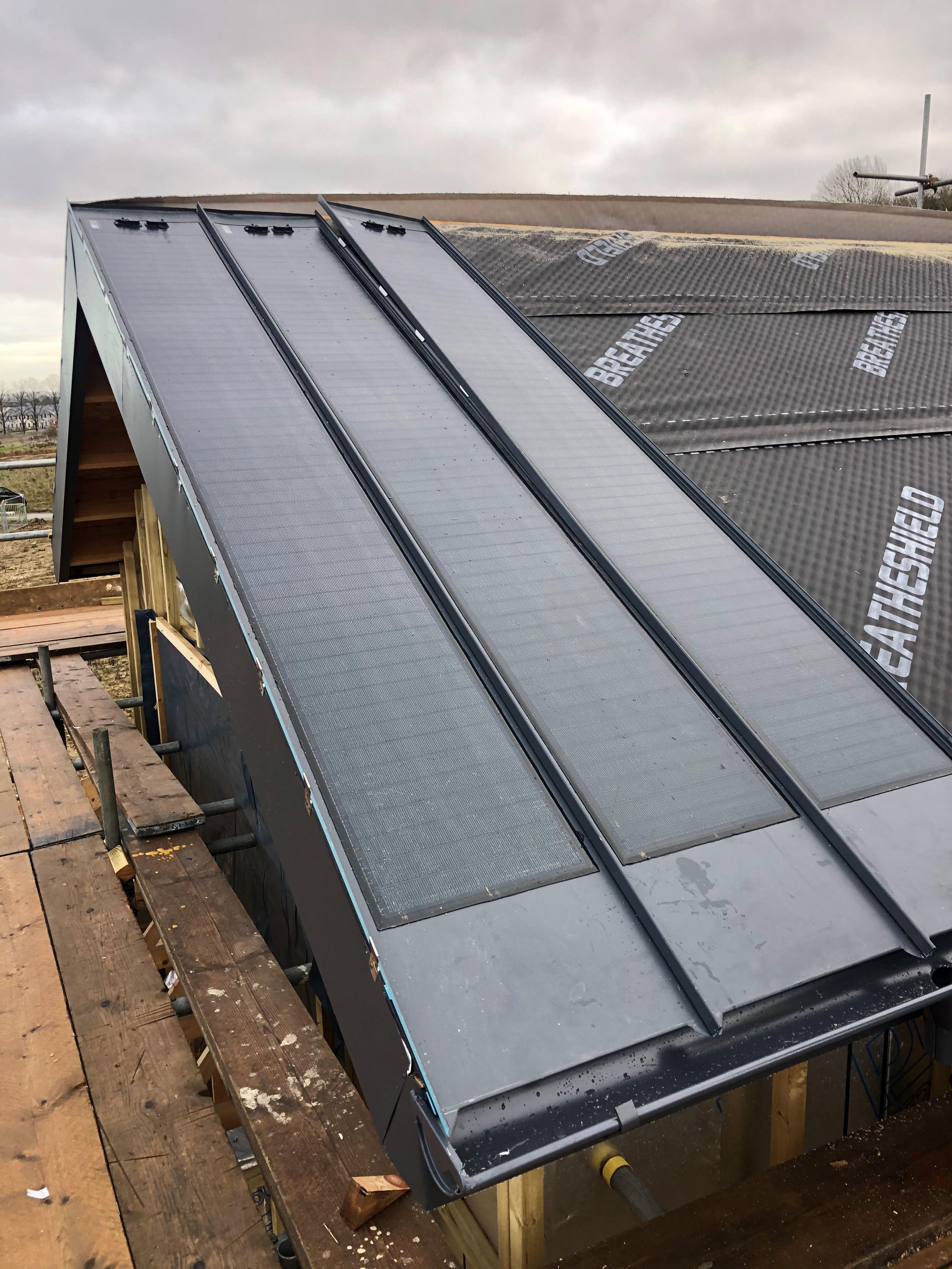

Kevin J Posted February 7, 2021 Share Posted February 7, 2021 On 17/01/2021 at 18:07, Russdl said: Does that mean you have to ship the roof panels to BiPVCo to get the PV bonded to them? On 17/01/2021 at 18:07, Russdl said: Does that mean you have to ship the roof panels to BiPVCo to get the PV bonded to them? Link to comment Share on other sites More sharing options...

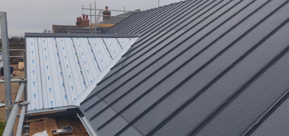

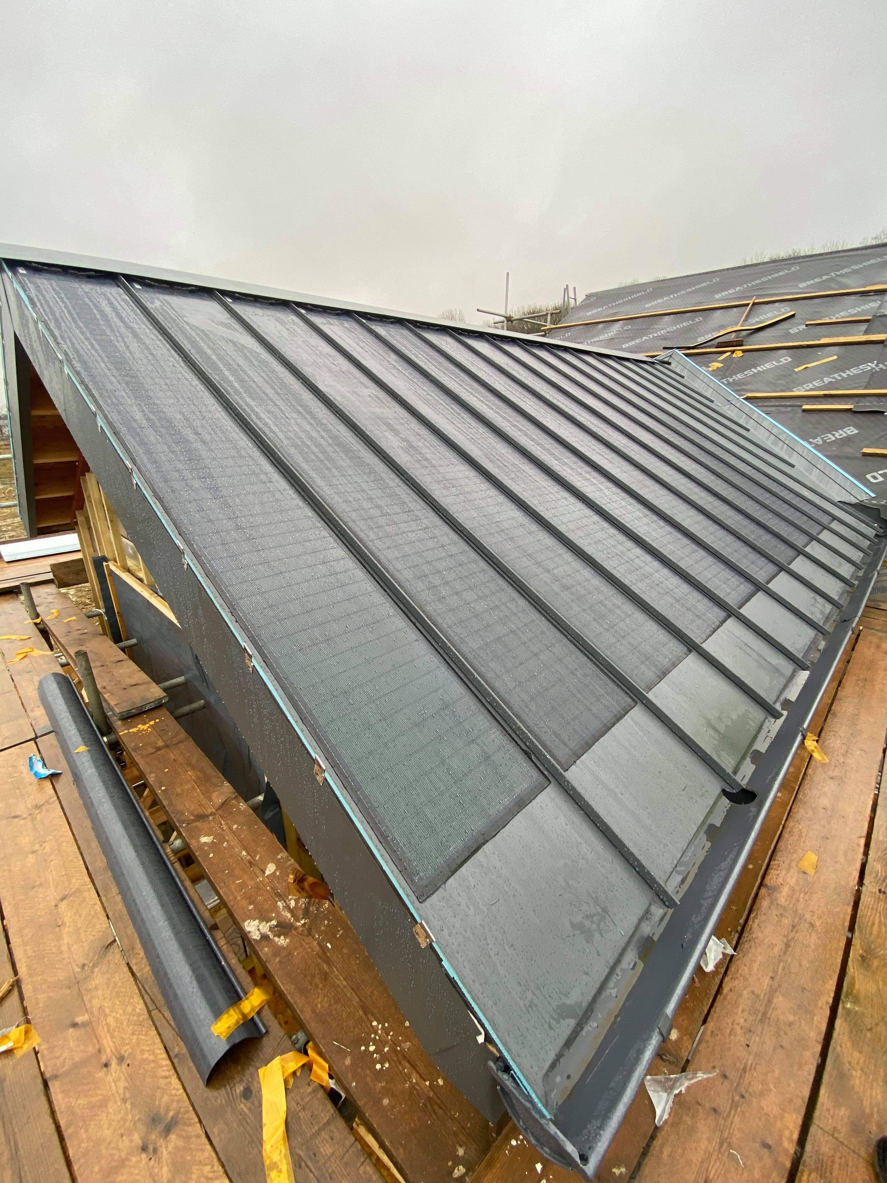

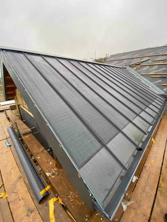

Kevin J Posted February 7, 2021 Share Posted February 7, 2021 On 18/01/2021 at 10:44, gc100 said: I looked at that as it would be far more elegant solution but its seems crazy expensive. Do you mind sharing your cost and how many Kw? Installing BiPVCo Solar 358mm PV on SSAB GreenCoat PLX Pro, Colour Mountain Grey (036) from Metal Solutions Ltd with Snaplock(R) Standing Seam at 400mm wide panels Installation in Graven Hill, Bicester. Electrics at the ridge under a low impact profile 1 1 Link to comment Share on other sites More sharing options...
Makeitstop Posted February 7, 2021 Author Share Posted February 7, 2021 27 minutes ago, Russell griffiths said: I think the finish and colour is a bit immaterial really, when you put it up on the roof they all look very similar. Its just how dark you go, light grey through to black. Unless your really out there and go green or blue. I got got a few samples of roof sheets and did my own testing. I basically threw the sheets on the floor and jumped up and down on them, I then left them out in the rain to see what happened. A bit unconventional but hey ho, I worked out that I hated the aluminium. Too thin dented easily. So i would pick the base material and the coating if any, then the colour Yes Russell, I recall you mentioning your "scientific testing" of materials. Ha. In fairness, i reckon you'll get a good idea of what's durable or not going at it like that. Your roof looked great, although I've not looked at samples of steel products. For my job, it's a small area, so material costs aren't the major issue, its installation cost. Link to comment Share on other sites More sharing options...
SimonD Posted February 7, 2021 Share Posted February 7, 2021 1 hour ago, Kevin J said: Installing BiPVCo Solar 358mm PV on SSAB GreenCoat PLX Pro, Colour Mountain Grey (036) from Metal Solutions Ltd with Snaplock(R) Standing Seam at 400mm wide panels Installation in Graven Hill, Bicester. Electrics at the ridge under a low impact profile Interesting, do they supply a retrofit version or does this have to be integrated with the trays before installation? Link to comment Share on other sites More sharing options...
Kevin J Posted February 7, 2021 Share Posted February 7, 2021 13 minutes ago, SimonD said: Interesting, do they supply a retrofit version or does this have to be integrated with the trays before installation? On 18/01/2021 at 10:44, gc100 said: I looked at that as it would be far more elegant solution but its seems crazy expensive. Do you mind sharing your cost and how many Kw? Installing BiPVCo Solar 358mm PV on SSAB GreenCoat PLX Pro, Colour Mountain Grey (036) from Metal Solutions Ltd with Snaplock(R) Standing Seam at 400mm wide panels Installation in Graven Hill, Bicester. Electrics at the ridge under a low impact profile Link to comment Share on other sites More sharing options...
LSB Posted February 7, 2021 Share Posted February 7, 2021 2 hours ago, Kevin J said: Installing BiPVCo Solar 358mm PV on SSAB GreenCoat PLX Pro, Colour Mountain Grey (036) from Metal Solutions Ltd with Snaplock(R) Standing Seam at 400mm wide panels Installation in Graven Hill, Bicester. Electrics at the ridge under a low impact profile this is what I want, who supplied and how much did it cost, and can we DIY Link to comment Share on other sites More sharing options...
