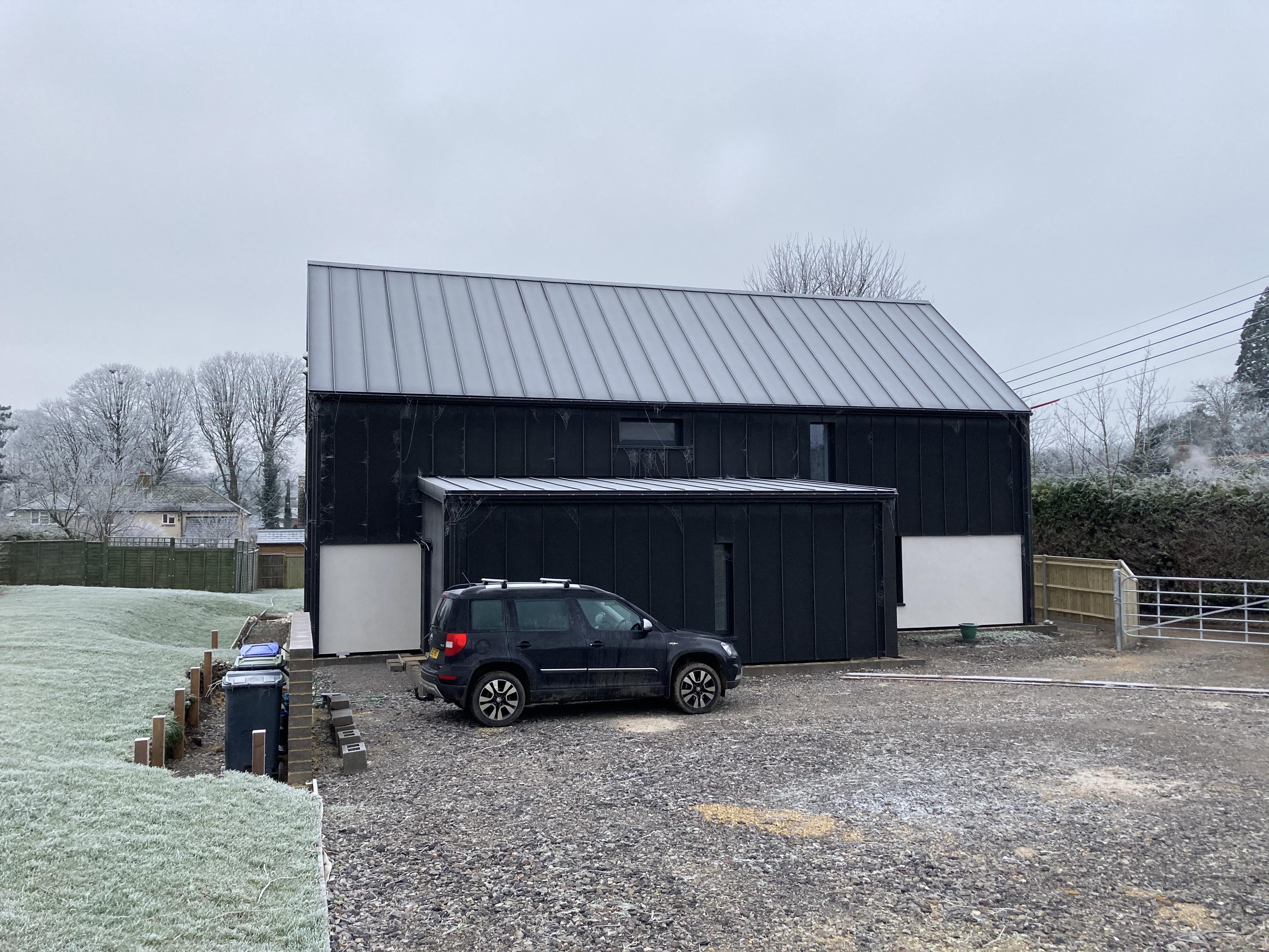

Russdl Posted January 13, 2021 Share Posted January 13, 2021 Image will be easy. Here’s a frosty morning one (cobwebs n all) m2 price will take me longer. 4 Link to comment Share on other sites More sharing options...

Russdl Posted January 13, 2021 Share Posted January 13, 2021 10 minutes ago, Gus Potter said: One of the keys to achieving this it to design and prepare the substrate properly. Make sure you detail for condensation too! Absolutely correct and something I was going to mention when I got round to digging out the m2 price because that won’t include all the marine ply and breather membrane our zinc is laid on. But the substrate detail holds true for any of the choices I would have thought. 1 Link to comment Share on other sites More sharing options...
Gus Potter Posted January 13, 2021 Share Posted January 13, 2021 43 minutes ago, Russdl said: Absolutely correct and something I was going to mention when I got round to digging out the m2 price because that won’t include all the marine ply and breather membrane our zinc is laid on. But the substrate detail holds true for any of the choices I would have thought. Cracking photo, looks great, Russdl. The zinc can make for some great clean lines. Just teasing, but are the wheelie bins always in line too? With some roofs, especially renovations with say an irregular smaller slate (eg Ballachulish) or maybe a pan tile roof you can often get away with a few lumps and bumps. I think the zinc is less forgiving..? but it can be worth the extra effort in the right circumstances. Link to comment Share on other sites More sharing options...
Russdl Posted January 13, 2021 Share Posted January 13, 2021 @Gus Potter I think you’ll find the blue bin is actually not quite in line. I’ll have a word with it on the morning it clearly needs to smarten itself up. The zinc definitely has the potential to be unforgiving, 0.8mm thick, and as you mentioned earlier, without careful detail at the gutter you’ll get a definite line appearing over time where the two zinc layers overlap. Link to comment Share on other sites More sharing options...

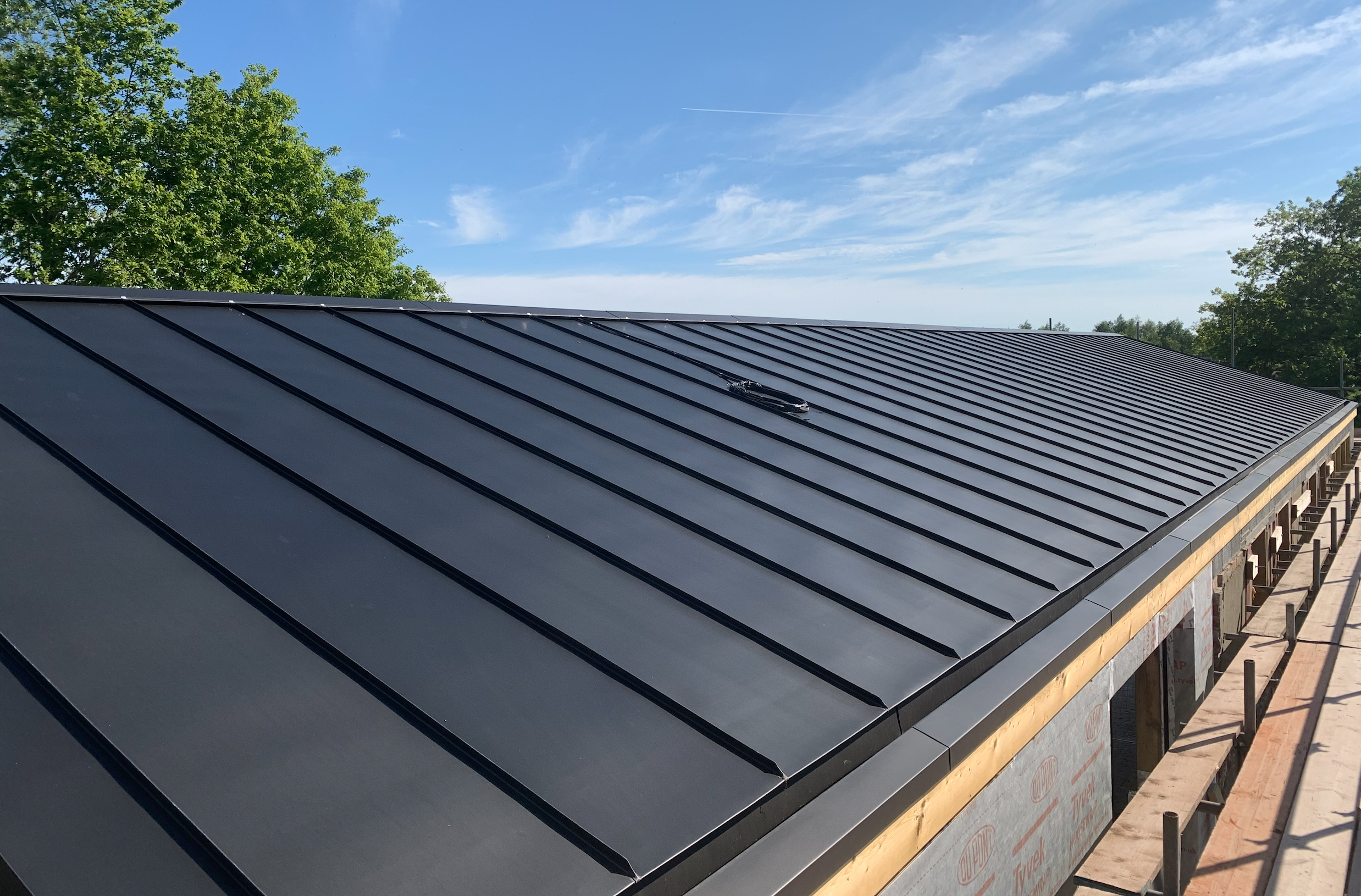

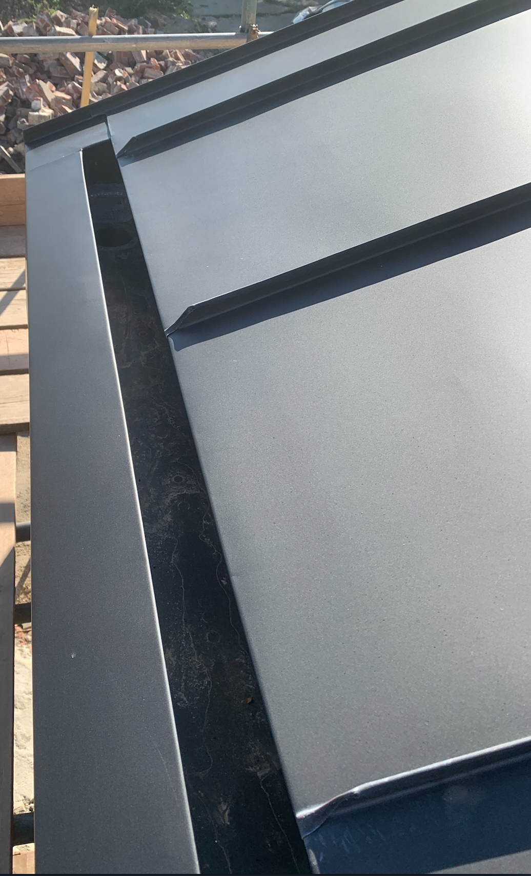

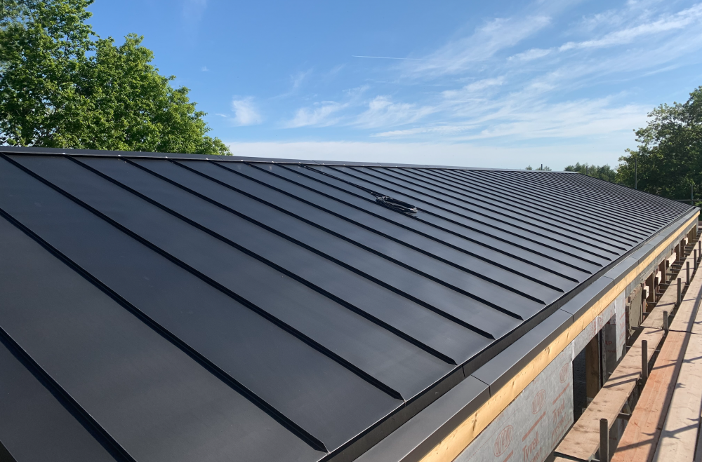

gc100 Posted January 14, 2021 Share Posted January 14, 2021 My wife wanted Zinc roof - I wasn't so sure , but I love it now. Ours cost £130/m2 roughly but not include the wood buildup underneath. They was there for 3 weeks in total and had 6 guys are one point. I also looked at the steel based solutions (like TATA etc) however if you need some fine details or specific requirements it cannot be done. The great thing about Zinc is that they can pretty much do anything. We really wanted hidden gutters and was key to the over all design so it was what made the decision in the end. Some pics. Ignore the cable on the roof - that's for solar panels to be fitted. 4 Link to comment Share on other sites More sharing options...
markc Posted January 14, 2021 Share Posted January 14, 2021 very nice 1 Link to comment Share on other sites More sharing options...
Tom Posted January 14, 2021 Share Posted January 14, 2021 gc100, can I ask if your hidden gutter is an off-the-shelf system or fabricated by the roofers? Link to comment Share on other sites More sharing options...

Russdl Posted January 14, 2021 Share Posted January 14, 2021 @gc100 that looks really good, especially the concealed gutter. Concealed gutters were on our wish list but I chickened out as things were getting more and more complex for us. Link to comment Share on other sites More sharing options...
