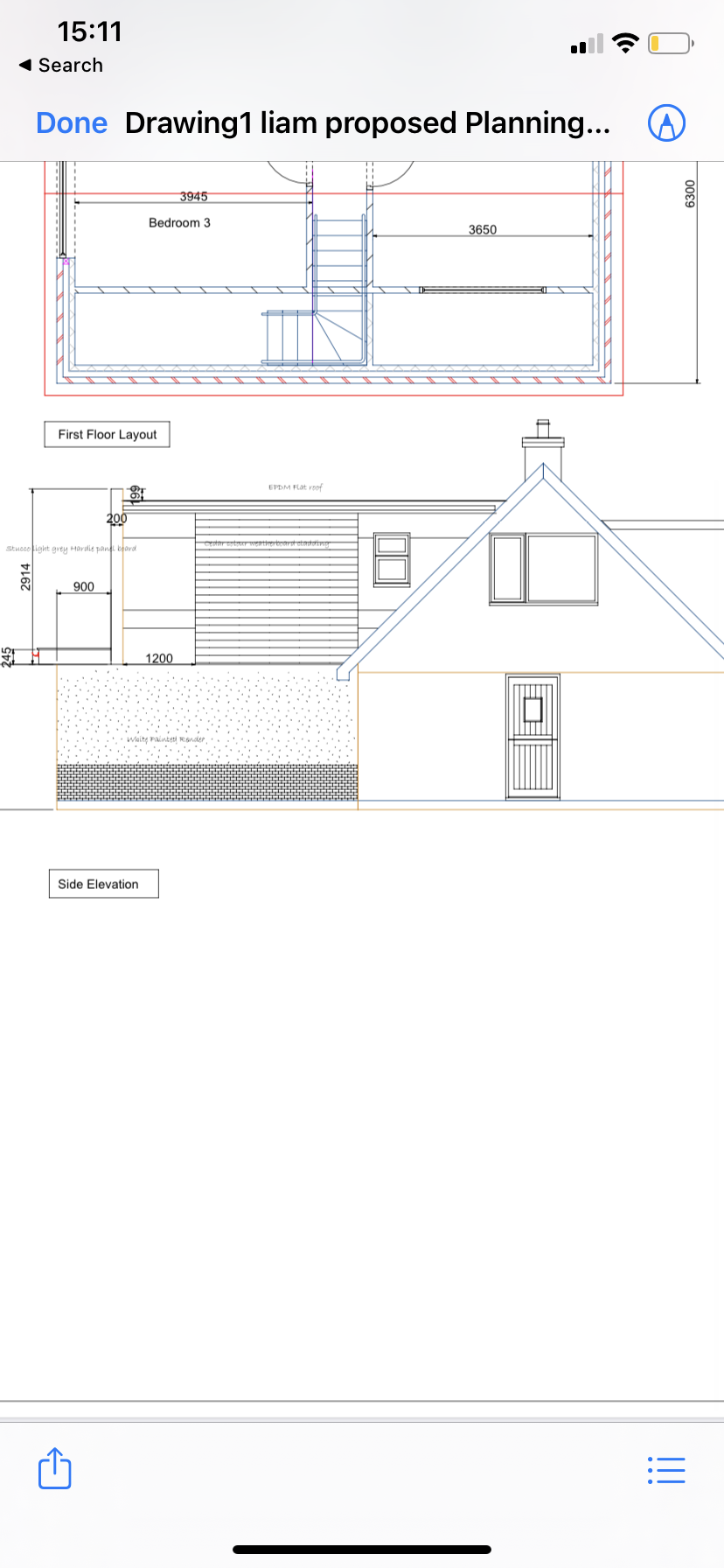

LDGD Posted January 13, 2021 Author Share Posted January 13, 2021 So the ecologist did say on her visit that we should be able to accommodate the bat provisions without altering design. See attached. It doesn’t sound like anybody has had a good experience with this type of thing. and Jilly that sound tough. We did use an ecologist from google but have talked to the council and they would have recommended them anyhow. my dad was lined up to the build in Feb. He can easily re arrange as he’s busy. I was thinking that by doing the groundwork’s and first level blockwork/brickwork 2/3 months. Natural break to have baby and have survey works and then start again back end of June with full planning permission. One last question I had was around re submission of planning. Do you have to go back round the 8 weeks again? Link to comment Share on other sites More sharing options...

Ferdinand Posted January 13, 2021 Share Posted January 13, 2021 5 hours ago, Jilly said: Bat mitigation gave me a headache and was very expensive. It's not as simple as slapping up a few bat boxes (although I have these, of course). I possibly have a worst case scenario for you: If they find bats you will likely have to have a Licence to remove the roosts and relocate the bats from Natural England submitted by the ecologist which is slow, then the validation is time limited. When estimating your timing for the build, be very generous and overestimate so that you don't stress and have to get another licence. I've spent about £6k so far, plus building ramifications which are hard to quantify. They will keep on surprising you with the requirement for another survey to keep your licence valid (£500 a time) Do plenty of research on ecologists (I just chose one from Google), ask your local council, you might even be able to use local (cheap) bat enthusiasts for the surveys, but make sure they are acceptable to Natural England and that they are recognised for the Licence. My ecologist designed mitigation and I didn't realise the significance at the time or I would have discussed alternatives more. My main worry has been F1 bituminous felt. It stops the roof from breathing so you might have to take care with roof design and look at alternatives. My architect overlooked this till it was too late and I was ill and not fully on the ball. I had to have supervised stripping of the weatherboarding (£300 per day) so as PeterW said if your design can can accommodate not disturbing them, that might be a solution. Also beware 'Batsafe' membrane is not actually bat safe: it's polyester and there are lawsuits pending over its use. I don't think you can rush this but at least do research now into ways round problems... and maybe buy a caravan for extra space for this summer When you get your original bat report, it may be possible to negotiate a modest update fee if you go beyond the 2 years which I think is normal for the validity. 1 Link to comment Share on other sites More sharing options...
DevilDamo Posted January 13, 2021 Share Posted January 13, 2021 12 hours ago, LDGD said: we are going 5m out so wouldn’t be PD. Are you a terrace, semi or detached? In other words, what can you do under PD just to get thing started? Once formal Planning goes through, you could then add it on. As for the re-submission, that would go through another 8 week determination process. Link to comment Share on other sites More sharing options...

PeterW Posted January 15, 2021 Share Posted January 15, 2021 Compromise your design slightly so you dont alter the roof at all, and just crack on with the extension assuming it’s under the neighbour approval scheme. Link to comment Share on other sites More sharing options...
