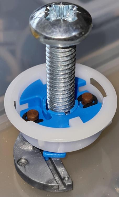

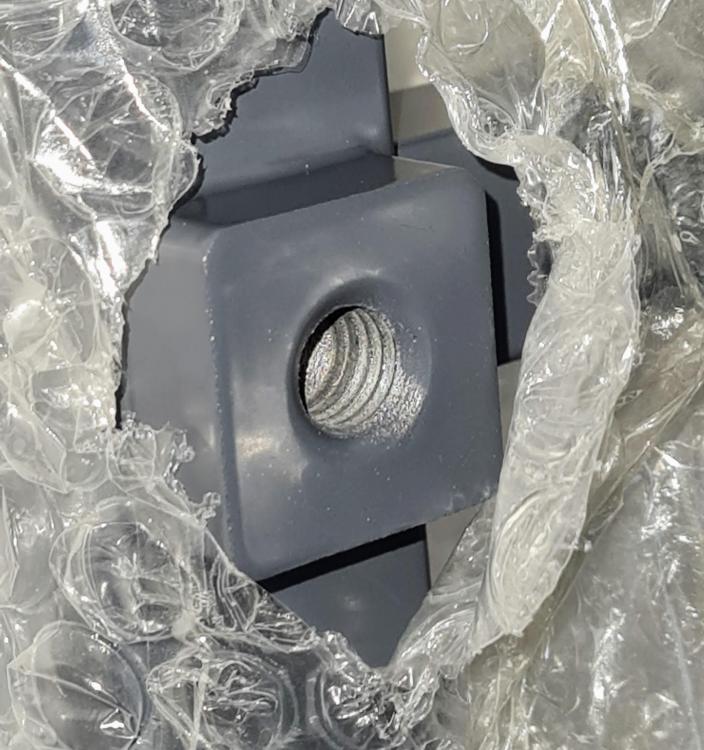

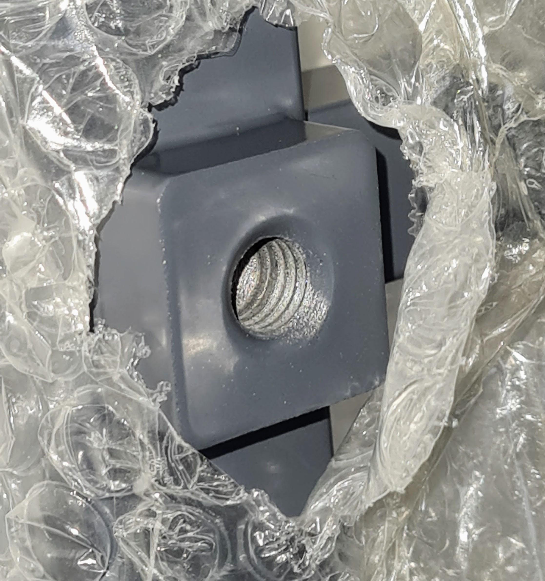

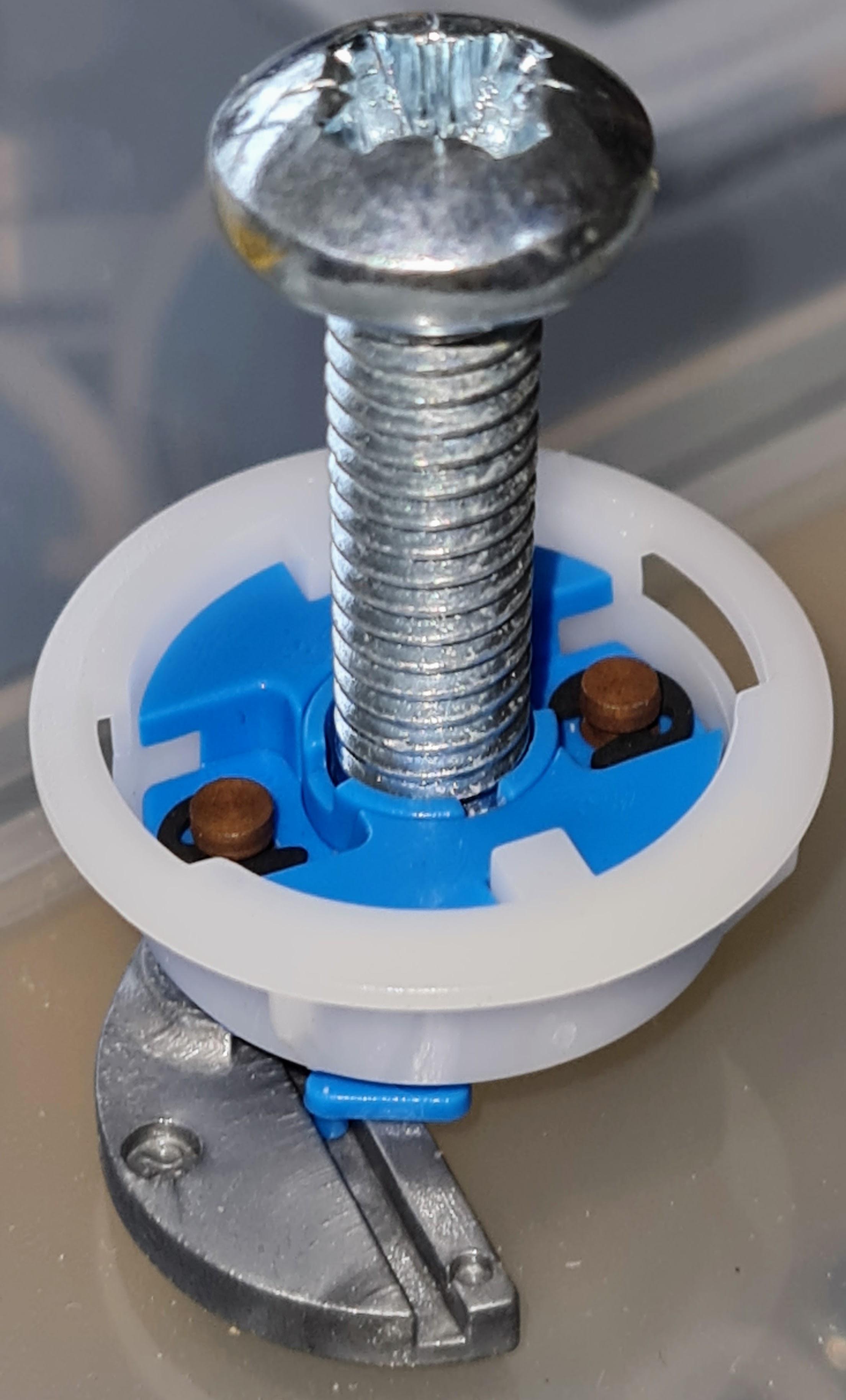

ToughButterCup Posted January 10, 2021 Posted January 10, 2021 (edited) Installing an electrically heated towel rail is usually simple. Unless you throw the fittings away and then burn them and their packaging. Bummer. At least I didn't throw the electric heating element away. Tiredness does more than kill. It makes ya do stoopid stuff. This is the radiator I want to fix onto a PB wall, and since I havent got the fixings any more , I was going to try to do it with these proprietory fixings ( trade name forgotten , but 90Kg per fixing claimed in PB - more than enough) But this is the threaded attachment hole in the radiator - which has a blanked off end. Not only that, the hole is M8 I think, one size bigger than the fixings (above) I have to hand. Damn. The studs behind the PB are not in line with the fixings on the rad. If they were, it'd be fixed by now. Before I take the PB off and mount noggins behind where the fixings will be, I thought I'd ask for advice please ..... Edited January 10, 2021 by ToughButterCup

joe90 Posted January 10, 2021 Posted January 10, 2021 Personally I would not hang a towel radiator on plasterboard fixings, a wet towel dragged off it will create sideways stress, noggins all the way fir me.

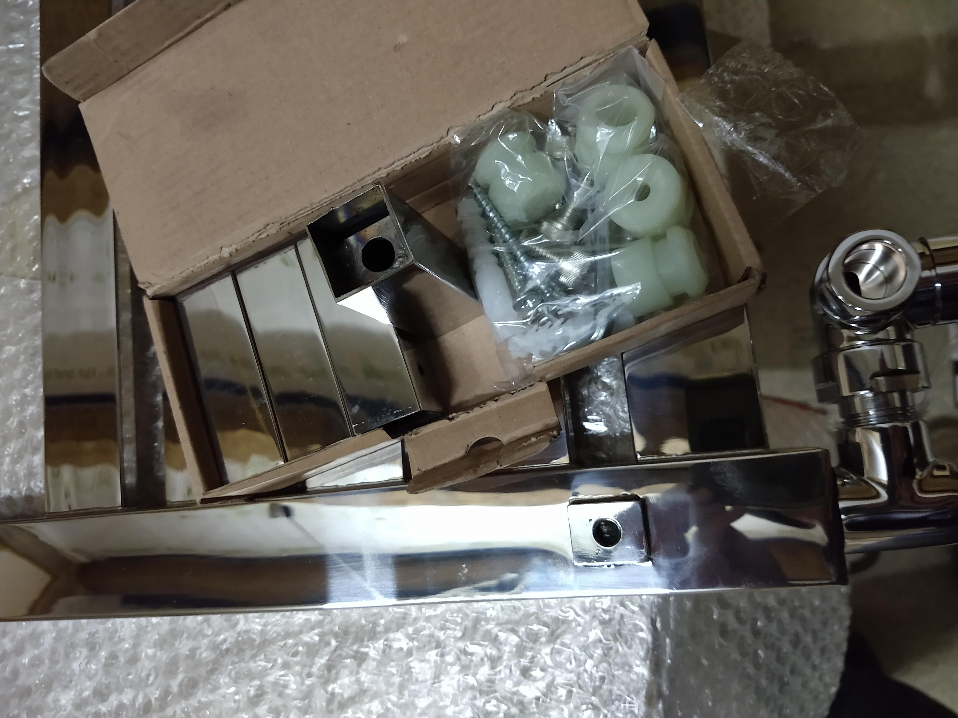

JFDIY Posted January 10, 2021 Posted January 10, 2021 The parts you are missing will be some tube (square or round) with a washer welded about 5-10mm down from the end. Will be pillar/stand-off of about 75mm long. That bit bolts to the radiator. There is then a plastic bobbin you fix to the wall, mine had a recess cut in the outside. You fit the rad to the bobbins then a grub screw in the side of the stand-off locates into the recess of the bobbin. I'd go with the others above and plead ignorance to start with. 1
JFDIY Posted February 7, 2021 Posted February 7, 2021 @ToughButterCup not sure if you need the info now or not, here is a pic of the stand-offs and bobbins my towel radiator uses for mounts. Bobbins go on wall, standoffs on rad, grub screw through the side of standoff holds it in place
ToughButterCup Posted February 8, 2021 Author Posted February 8, 2021 Thanks for the thought. I rang Gyser, and they were very good: no questions, they just sent me a replacement FOC. Took a week, but TwinkleToes now has warm towels, warm floor, warm water. And I have Brownie Points Cheers @JFDIY !
