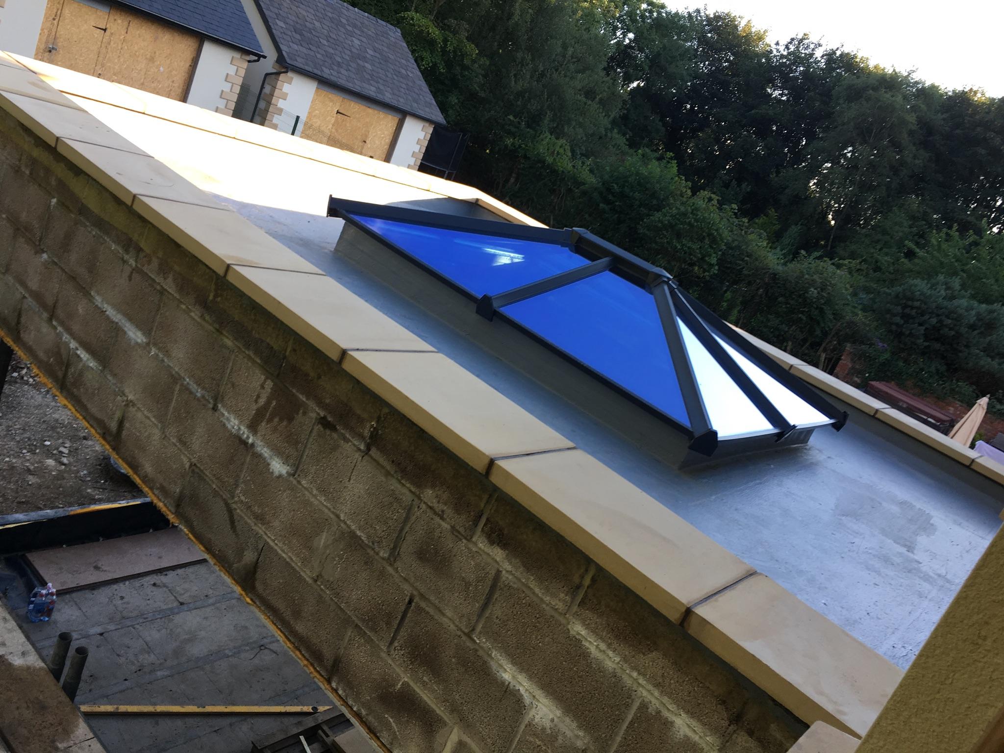

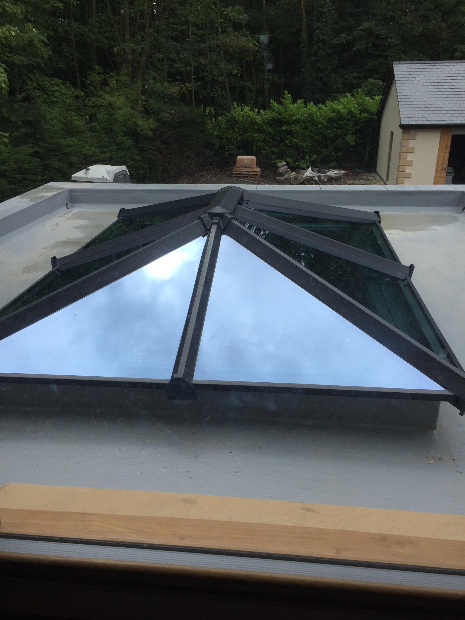

I had the same dilemma a couple of years back when I did ours
I’d absolutely no experience of either But went with fiberglass due to it being virtually indestructible Should one of the many slates that I fixed above fall

Ours runs to a drain at either side
So not exactly flat roof Nothing could ever come through it
It is like the bottom of a boat

@ Nod.... What is the overall dimension of your roof in the image, and was this a contractor job or DIY, how long has it been on, and, are you pleased with it overall?
