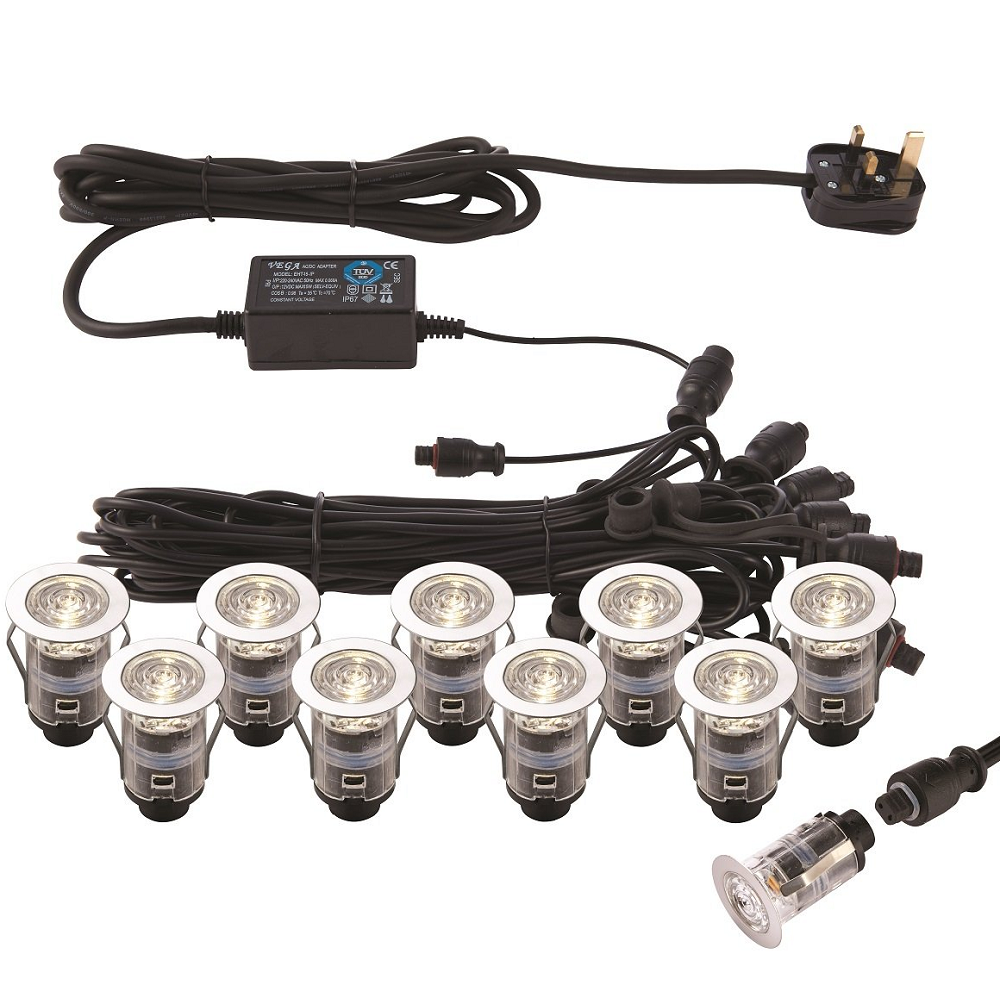

Carrerahill Posted February 8, 2021 Share Posted February 8, 2021 (edited) On 10/01/2021 at 10:20, Russdl said: Our bath will be freestanding, maybe about 50 - 100 mm away from the wall at most. We wanted some LED lights on the wall behind and below the bath for the occasional chilled out soak . Our M&E guy was going to send us a link to some lights that he thought would do the job well but we didn't get that. I'm pretty sure that something like this is what he had in mind. They are decking lights and IP67 rated. It seems like a great idea to me but how would we do it? I know almost zip about electrickery. At the moment we have a grey cable coming through a hole in the plasterboard that is for LED lights. Do we just: 1. Cut the string of lights off from the transformer. 2. Join that string of lights to the in situ cable. 3. Find the other end of the in situ cable and attach the transformer to that. 4. Plug in. Switch on. Chill out? Or is it way more complicated than that? Help appreciated ? If it was me, I'd probably go for a recessed IP rated LED profile (strip of aluminium channel) ideally set into a rebate in the floor. I use a nice potted strip for things like this, 24VDC so safe for this use, remote 24V PSU. 3000K no more than 750-800Lm per meter for ambient uplight. Edited February 8, 2021 by Carrerahill Link to comment Share on other sites More sharing options...
PeterW Posted February 8, 2021 Share Posted February 8, 2021 17 minutes ago, Russdl said: And he ain’t doing that! So warm white and that’s it? No other numbers and letters I need to know or any other specifics for LED’s on the floor behind a bath? IP65 would be good but not essential. Make sure the lid is sealed onto the track and you will be fine. Link to comment Share on other sites More sharing options...
Russdl Posted February 8, 2021 Author Share Posted February 8, 2021 48 minutes ago, Carrerahill said: If it was me, I'd probably go for a recessed IP rated LED profile (strip of aluminium channel) ideally set into a rebate in the floor. Yep, did that (photo about 6 posts up there ⬆️ ) 50 minutes ago, Carrerahill said: 3000K no more than 750-800Lm per meter for ambient uplight. Thats the sort of numbers I was looking for, thanks @Carrerahill ? 48 minutes ago, PeterW said: IP65 would be good but not essential. And those letters/numbers, thanks @PeterW Link to comment Share on other sites More sharing options...
