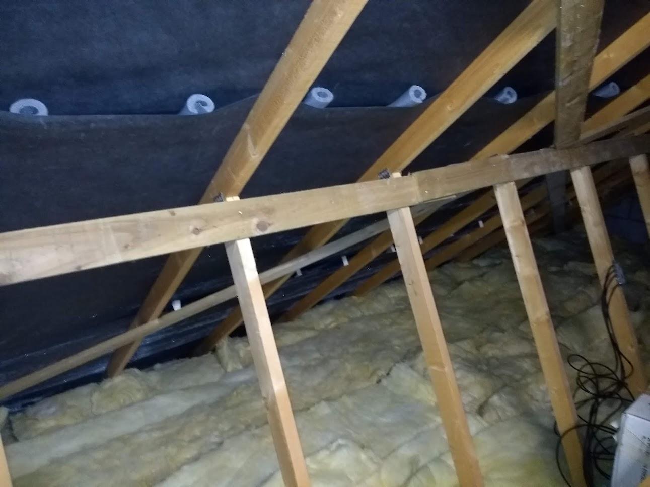

Jilly Posted January 11, 2021 Posted January 11, 2021 On 06/01/2021 at 17:57, PeterW said: Short lengths of overflow pipe work just as well and much cheaper ! Sorry to be thick but could you draw what you mean, please? I think this might help me too but I can't visualise how..
Gav_P Posted January 11, 2021 Posted January 11, 2021 1 hour ago, Jilly said: Sorry to be thick but could you draw what you mean, please? I think this might help me too but I can't visualise how.. I’m guessing a bit like this from a quick google search
Jilly Posted January 11, 2021 Posted January 11, 2021 Ahh, OK. Thank you. I'm worried about hidden condensation in the vaulted ceiling
PeterW Posted January 11, 2021 Posted January 11, 2021 21 minutes ago, Jilly said: Ahh, OK. Thank you. I'm worried about hidden condensation in the vaulted ceiling Can’t use it for that. You need to use a proper breather membrane and a vapour barrier below the insulation.
