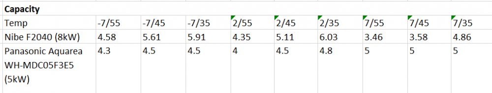

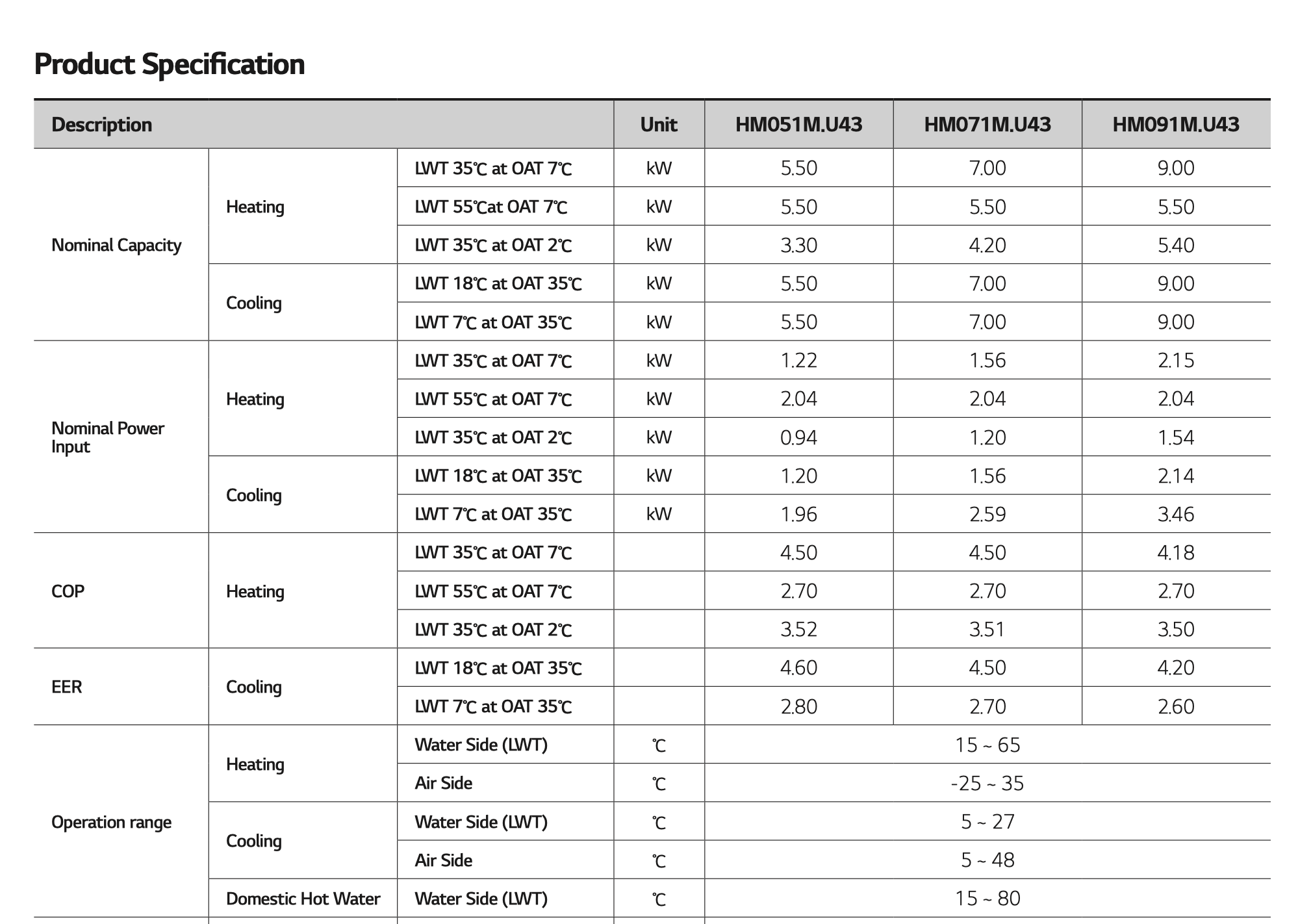

AliG Posted February 11, 2021 Share Posted February 11, 2021 I just checked this as I had noticed when looking at heat pumps that some of them see a notable drop in output as they get away from ideal conditions. You have to be careful of this as non ideal conditions are often when you need them most. After a lot of work on Google I found the full specs of LG heat pumps. It seems to me that they suffer from this issue more than others I have looked at. The figure isn't given here, but with a flow temp above 35C and an outside temp below 2C it would seem likely that its max output drops to less than 5kW which would indeed make it undersized. Notice that with a 55C flow temp, the max output of the 5, 7 and 9kW pumps is actually the same! Link to comment Share on other sites More sharing options...
jack Posted February 11, 2021 Share Posted February 11, 2021 3 hours ago, George said: An invertor driven one can, yes. The pump runs as hard (and draws as much energy) as is needed. Larger pumps typically have a higher minimum output though, I believe. This can be an issue in a highly insulated house with an oversized heat pump, because the minimum output might be higher than is desirable. 16 minutes ago, AliG said: I just checked this as I had noticed when looking at heat pumps that some of them see a notable drop in output as they get away from ideal conditions. You have to be careful of this as non ideal conditions are often when you need them most. By way of comparison, I ran some figures a few years back when comparing a nominally 8kW unit against a nominally 5kW unit from a different manufacturer: At the conditions the ASHP would experience most of the time where I live, the 5kW unit had a comparable output at worst. No idea why the Nibe 2040-8 is considered an 8kW unit given it doesn't seem to ever output 8kW. Maybe there's some specific combination of exterior temps and production temps where it peaks at 8kW capacity? Link to comment Share on other sites More sharing options...
