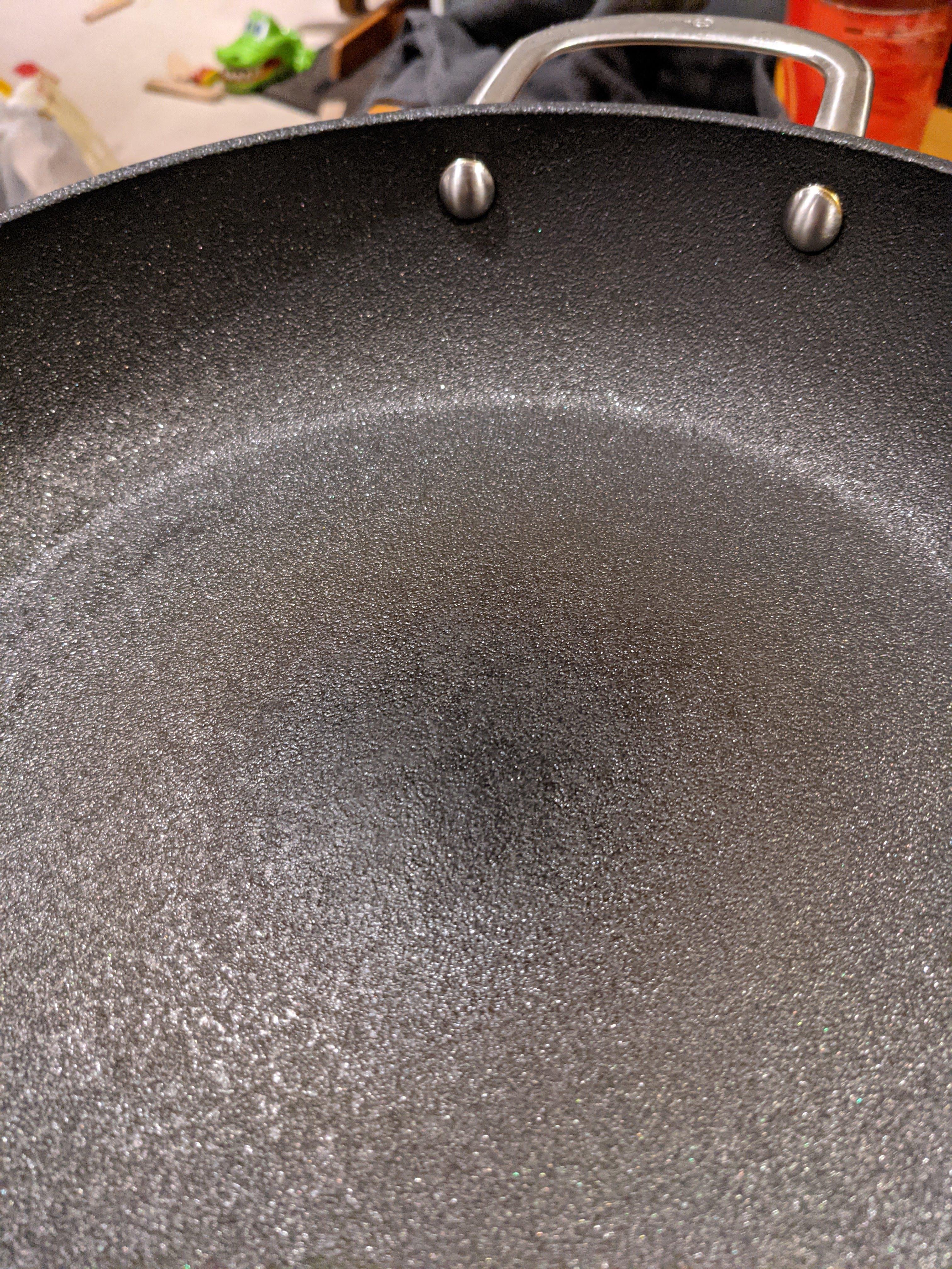

puntloos Posted January 4, 2021 Share Posted January 4, 2021 So far, I've only encountered induction hobs whose actual heating rings are perhaps 10-15cm diameter. My largest pans are 30cm or such, which means that even though they claim to be heatspreading, food gets heated very unevenly, with anything in the center cooking (and then blackening) much faster than the rest. Does anyone have an induction hob where one-or-more of their burners actually is 30-ish cm? Or is that a physical impossibility somehow? Link to comment Share on other sites More sharing options...

daiking Posted January 4, 2021 Share Posted January 4, 2021 1 hour ago, Ferdinand said: Here, for example, is a Siemens $£""%$£^$^$^$&&^%*&(*)_()&*&%^%%$£%$£%* with a Flexinduction Zone from Appliances Direct at £750, at 15% (already taken) off. https://www.appliancesdirect.co.uk/p/77641460%2f1%2fex879fvc1e/siemens-776414601ex879fvc1e-iq700-5-zone-induction-hob-hob F If you read the blurb you’ll see the large centre ring is 240mm diameter which should be sufficient. to be honest I cannot think of any occasions we have needed either of the 2 flexi-zones we have and standard rings would not have sufficed and saves ££ in the process. Link to comment Share on other sites More sharing options...
puntloos Posted January 4, 2021 Author Share Posted January 4, 2021 56 minutes ago, daiking said: If you read the blurb you’ll see the large centre ring is 240mm diameter which should be sufficient. to be honest I cannot think of any occasions we have needed either of the 2 flexi-zones we have and standard rings would not have sufficed and saves ££ in the process. Yeah the massive flexizone is overkill - I guess 24cm is fine-ish with the full pan diameter being 30 (at the top.. i think, so the base is probably pretty close to 25). I think my rings are 15cm. Result: Not the end of the world but annoying, not just with the pan but also while cooking. Link to comment Share on other sites More sharing options...
daiking Posted January 4, 2021 Share Posted January 4, 2021 2 minutes ago, puntloos said: Yeah the massive flexizone is overkill - I guess 24cm is fine-ish with the full pan diameter being 30 (at the top.. i think, so the base is probably pretty close to 25). I think my rings are 15cm. Result: Not the end of the world but annoying, not just with the pan but also while cooking. Ours is 5 years old now but the current equivalent has a centre ring that 320mm diameter Link to comment Share on other sites More sharing options...
