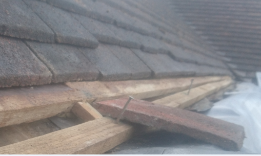

kestrel Posted January 1, 2021 Posted January 1, 2021 (edited) In the process of refitting the first three courses of tiles after doing some repairs and noticed the eaves course sits at a very shallow angle compared to the tile above it.(think this is called a sprocket?) Anyway its is possibly how water was getting under the tiles and into the eaves in the first place as i couldn't find any broken tiles or traces of water ingress from above. It seems like the fascias (fitted before i lived here) are too high causing the eave course to sit at the wrong angle (too shallow). From what I understand the fascia would need to be dropped in order to get the correct angle on the eaves but id have to also reposition the height of the soffit vents, drain pipes and fittings to suit the fascia adjustment then fill/repaint/make good I thought about trimming the top of the fascia but this section of roof has a 90° corner so id have to strip and modify that fascia so everything sits at the same height on the perpendicular run. It would also leave a weird notch at the gable end where the under cloak sits on the last few inches of fascia and barge board so im not going to try this In this situation is there any other way i can correct the angle of the eaves tiles with out having to remove all the fascias and reposition everything? Could i pack out the first tile batten with plastic or wooden spacers to try increase the angle of the first tile? ps its a plain redland tile, spec'ed at 35° min pitch. Not measured the angle yet but looking at how the tiles sit, its much less than this Edited January 1, 2021 by kestrel

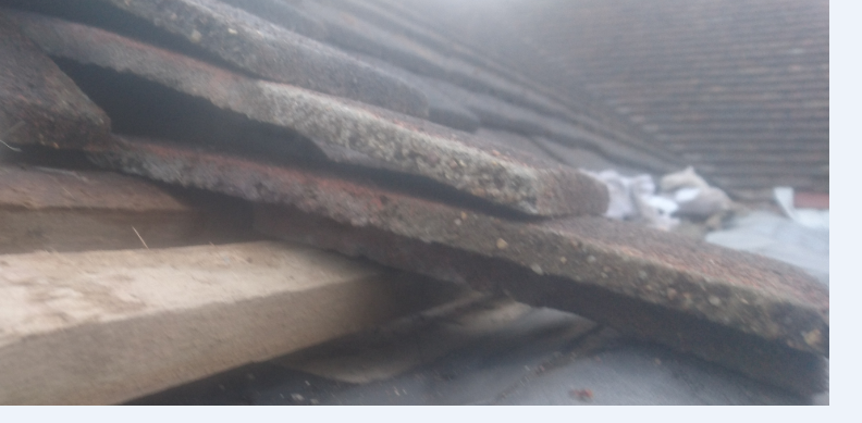

kestrel Posted January 2, 2021 Author Posted January 2, 2021 here we go, i managed to get a couple of pics today when it stopped raining..... just did a test fit with a batten spacer as per the original batten spacing and position Then tried to shim up the first batten with a spacer underneath Either way the first tile and the one above it look too flat of an angle

kestrel Posted January 2, 2021 Author Posted January 2, 2021 (edited) original batten spacing with the batten sitting directly on the rafter Had a go a putting some wood shims under the first batten to try and improve the angle the picture is not completely square on the end of the tiles but you get the idea Edited January 2, 2021 by kestrel additional info

joe90 Posted January 2, 2021 Posted January 2, 2021 (edited) With the facia that high the felt has no slope at the bottom, so any rainwater/condensation will pool and maybe find nail holes which will give damp in the house. So I think your only options are 1/ lower facia board, 2/ cut some off the top of the facia board 3/ take off several rows of tiles and battens and add tapered wedges to the rafters under the felt to line up better with the facia. With this option trial and error will give the right “wedge”. just spotted @JFDIY idea above about slates instead of short first row of tile, worth a try (but it won’t cure pooling on the felt) Edited January 2, 2021 by joe90

bassanclan Posted January 2, 2021 Posted January 2, 2021 Fitting strips should have been fitted to the rafters when it was built. Approx 400mm long tapering from 40mm at the fascia to nothing. You can retrofit, but would mean stripping a lot to make it match.
