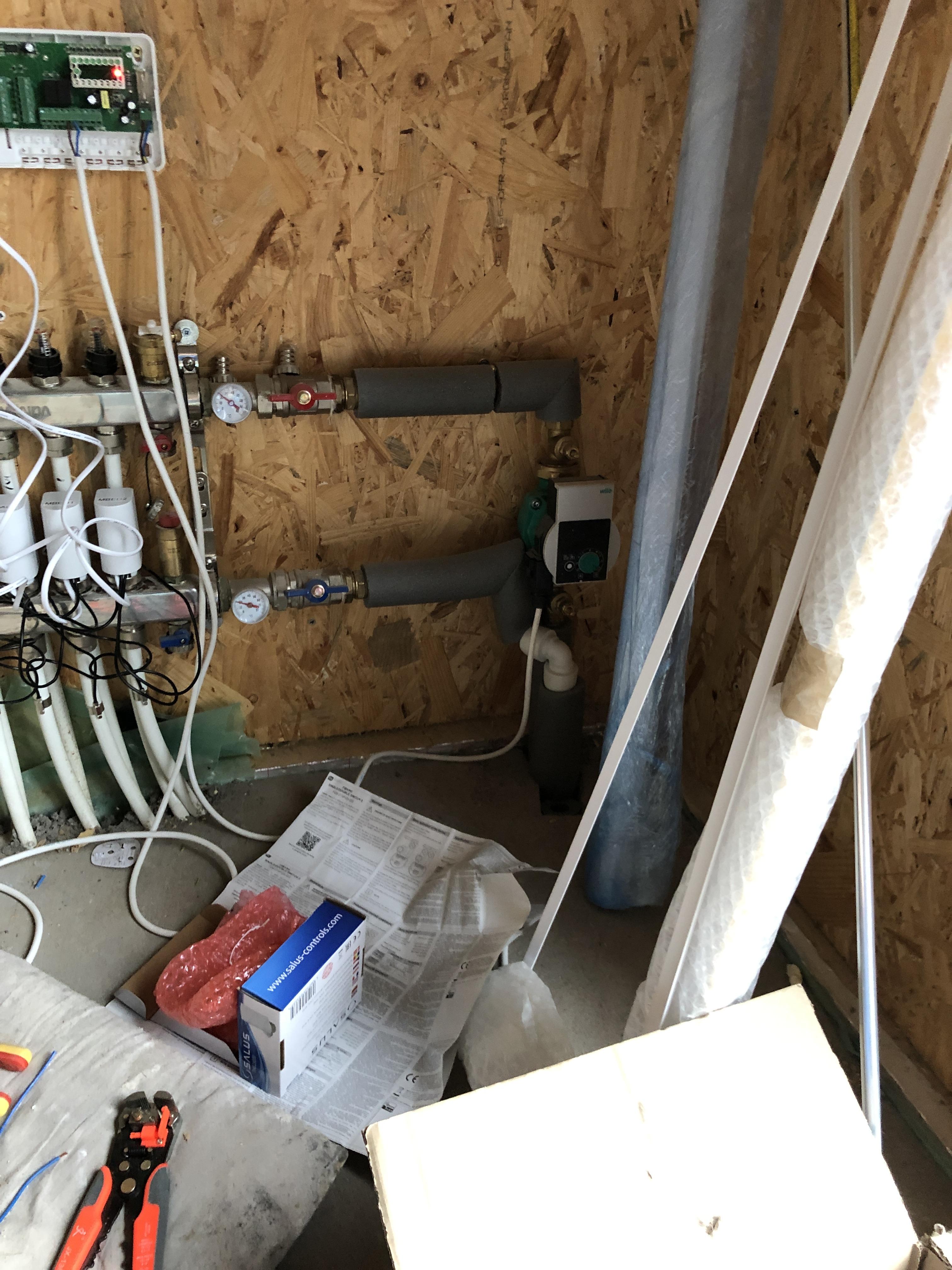

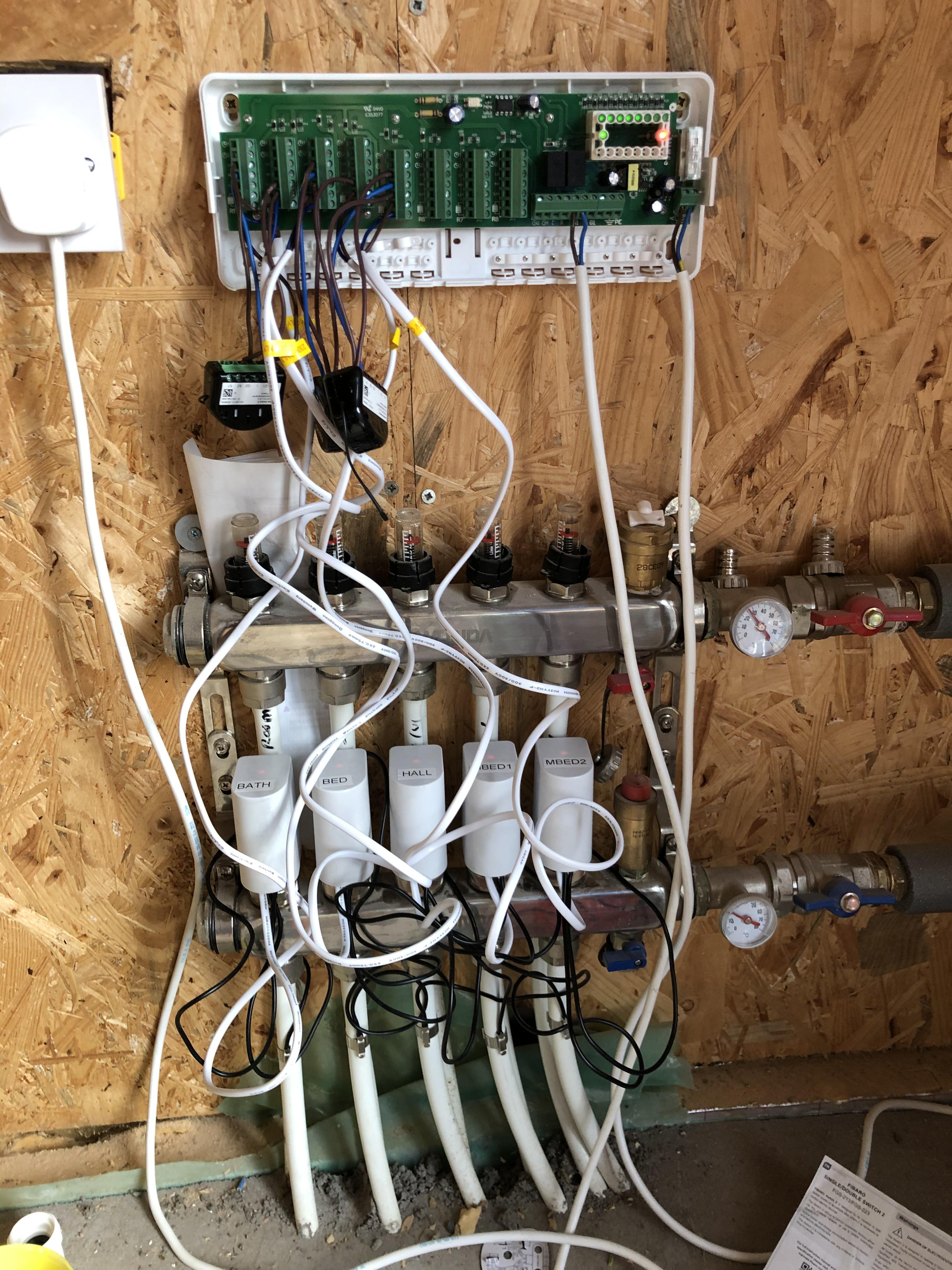

Pocster Posted February 2, 2021 Author Share Posted February 2, 2021 All seems to work Trying to get it to turn off at a set temp from room sensor Link to comment Share on other sites More sharing options...
JFDIY Posted February 2, 2021 Share Posted February 2, 2021 8 minutes ago, pocster said: All seems to work Trying to get it to turn off at a set temp from room sensor Tidy.............I can hear @Onoff tearing his hair out ? 2 Link to comment Share on other sites More sharing options...
Pocster Posted February 2, 2021 Author Share Posted February 2, 2021 (edited) 4 minutes ago, JFDIY said: Tidy.............I can hear @Onoff tearing his hair out ? I’m going to box it in . It’s hard to make it all neat without being sad and shortening every cable . It’s easier like this to locate a particular cable in event of an issue . As I’m sure you are aware my view is “ if you don’t see it who gives a (expletive deleted) “ - not applicable to ocd people of course Edited February 2, 2021 by pocster Link to comment Share on other sites More sharing options...
ProDave Posted February 2, 2021 Share Posted February 2, 2021 No blending valve and manifold pump? Link to comment Share on other sites More sharing options...
Pete Posted February 2, 2021 Share Posted February 2, 2021 22 minutes ago, JFDIY said: Tidy.............I can hear @Onoff tearing his hair out ? Like a snakes wedding!! 2 Link to comment Share on other sites More sharing options...
Pocster Posted February 2, 2021 Author Share Posted February 2, 2021 (edited) 33 minutes ago, ProDave said: No blending valve and manifold pump? I’m afraid that conversation has happened before . The installer recommended on here countless times doesn’t think it’s necessary ( blending valve ) Edited February 2, 2021 by pocster Link to comment Share on other sites More sharing options...
Pocster Posted February 2, 2021 Author Share Posted February 2, 2021 32 minutes ago, ProDave said: No blending valve and manifold pump? Sorry lol ! Yes there’s a pump just out of shot - see ? Link to comment Share on other sites More sharing options...
Pocster Posted February 2, 2021 Author Share Posted February 2, 2021 @PeterW that cheap eBay wiring centre you recommended seems to do the job brilliantly ???? 1 Link to comment Share on other sites More sharing options...

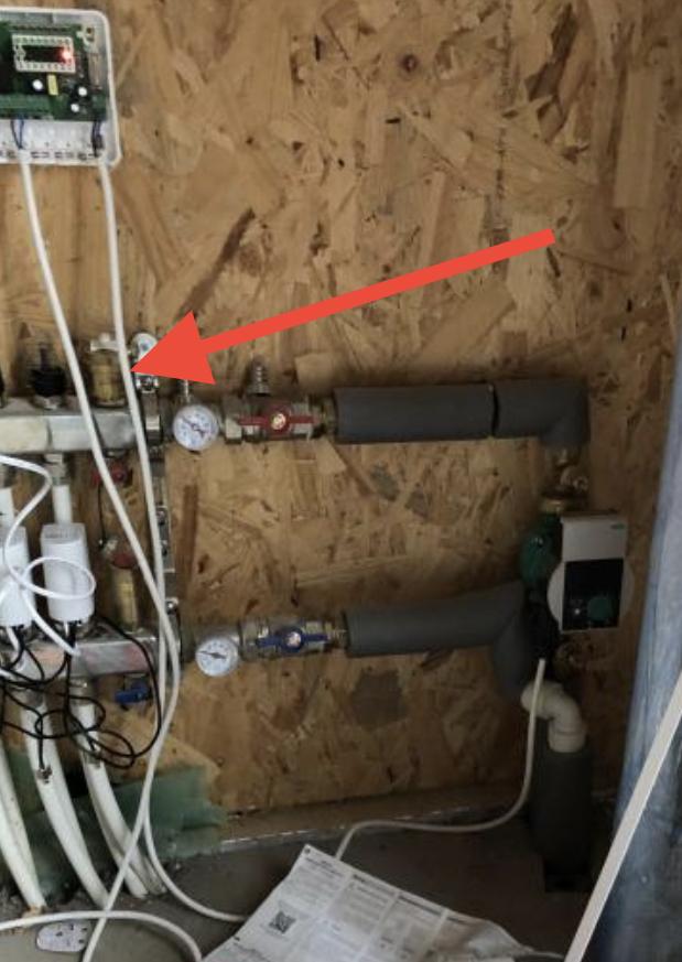

PeterW Posted February 2, 2021 Share Posted February 2, 2021 Ok to get rid of the air permanently, isolate the manifold and open the top drain valve. Then remove the brass bleed valve head and replace it with one of the Aladdin automated UFH bleed valves. Then repressurise the system, bleed the top rail using the pin and it will self bleed the remaining air over a few hours running. Link to comment Share on other sites More sharing options...
Pocster Posted February 2, 2021 Author Share Posted February 2, 2021 1 hour ago, PeterW said: Ok to get rid of the air permanently, isolate the manifold and open the top drain valve. Then remove the brass bleed valve head and replace it with one of the Aladdin automated UFH bleed valves. Then repressurise the system, bleed the top rail using the pin and it will self bleed the remaining air over a few hours running. Erm ! Overload ? Will re read later . An Aladdin ? Does it need a rub ? Link to comment Share on other sites More sharing options...
PeterW Posted February 2, 2021 Share Posted February 2, 2021 14 minutes ago, pocster said: Erm ! Overload ? Will re read later . An Aladdin ? Does it need a rub ? https://www.bes.co.uk/aladdin-autovent-hv30c-1-ufh-23156/?ref=gs&gclid=CjwKCAiAjeSABhAPEiwAqfxURbtWoAU0g8qU196pTw48ZS1fE9ePaN0lSOW2FIRoelS47sVh1uZXWxoCCHgQAvD_BwE one of these ... 1 Link to comment Share on other sites More sharing options...
Pocster Posted February 2, 2021 Author Share Posted February 2, 2021 2 minutes ago, PeterW said: https://www.bes.co.uk/aladdin-autovent-hv30c-1-ufh-23156/?ref=gs&gclid=CjwKCAiAjeSABhAPEiwAqfxURbtWoAU0g8qU196pTw48ZS1fE9ePaN0lSOW2FIRoelS47sVh1uZXWxoCCHgQAvD_BwE one of these ... ok Ill order one . But would appreciate a step by step approach when I do this . Just to make sure I don’t f it up ? Link to comment Share on other sites More sharing options...

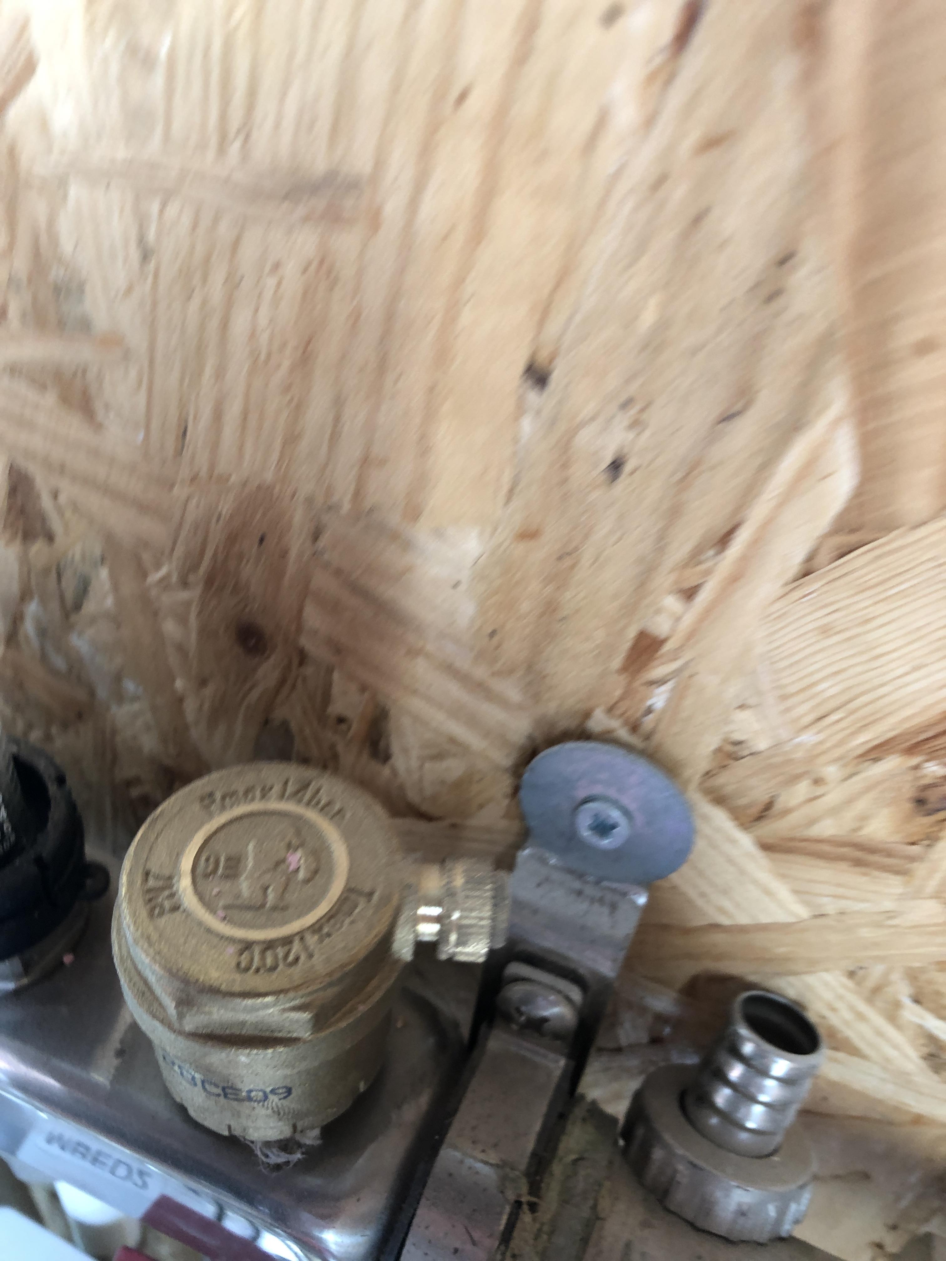

PeterW Posted February 2, 2021 Share Posted February 2, 2021 @pocster do me a favour and take a close up of that brass thing on the top rail please. want to see where the thread is and if it has a hex top. 1 Link to comment Share on other sites More sharing options...
Pocster Posted February 2, 2021 Author Share Posted February 2, 2021 5 minutes ago, PeterW said: @pocster do me a favour and take a close up of that brass thing on the top rail please. want to see where the thread is and if it has a hex top. Link to comment Share on other sites More sharing options...
PeterW Posted February 2, 2021 Share Posted February 2, 2021 So that silver thing on the right looks like a Schraeder valve. Undo the cap and push the pin and see if you get any air out. Link to comment Share on other sites More sharing options...
